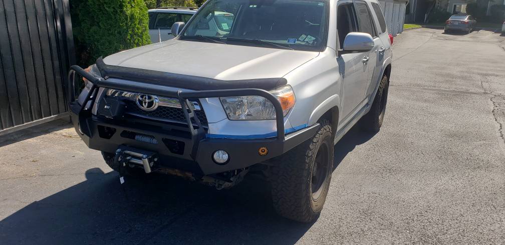

Drove 3,038 miles to get this installed. Think it turned out pretty good. Don't want to add a light bar yet because I am not sure about cooling. Winch is back at home so I have another couple weeks and 3,038 miles to go

What low pro bumper is that?

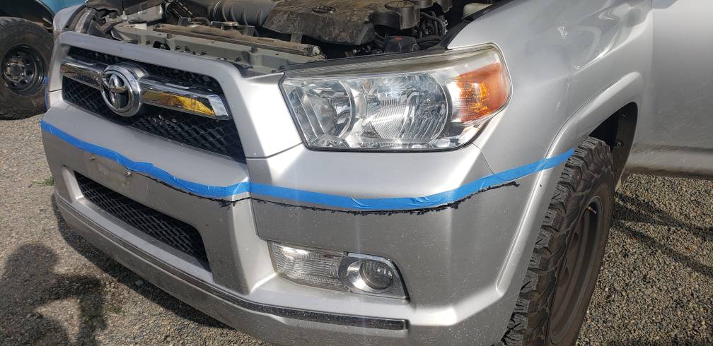

It's Armageddon Armor from Southern Style Offroad. My dad and I fabbed up the sides to make it match the lines of the Limited bumper. You could do it with any bare metal hybrid bumper. I wasn't exactly sure how much modifying it would take to make it work so I bought the weld it yourself kit (would recommend anyway if you know how to weld. The one pre-welded piece they sent is probably structurally fine but the welds were hideous) with the intention of tacking it together and then seeing where I could cut to get the best look. It ended up being welded up almost exactly like it should and then the two sides added after that.
One other advantage on this is that the plastic bumper and the metal bumper can be removed independently of each other. I think the standard hybrid bumpers overlap the top of the plastic enough that the metal bumper has to come off to take the plastic one off

Not sure if you're concerned about the lights cooling or the engine. My supercharger intercooler radiator is in front of the stock radiator and I have not had any cooling problems in 100 degree plus temps at any speed. Hope this helps.

I was worried about the engine cooling. I know the SR5/TRD models keep the full grille part of the front but I ended up losing the bottom part of the Limited grille and didn't know how much that would affect cooling. Your intercooler still let's air through though right? I was thinking that a winch and light bar would block too much.

You may have a point with the bumper and light bar. Not sure how hot it gets in North Bergen, but I have found that my Toyotas seem to have a pin on the temp gauge just before half way towards hot. LOL! I've only had one over heat. My '88 Cressida. My fault.

Anyone know if the rocker trim and front mudflaps are different between the SR5/TRD trim and TE trim? I have a 2014 Limited and I took off the rocker panel off to install the new NFab Trailsliders. It doesnt look too bad with the piece of the body exposed but I want to cover it up with the same cladding as the TRD/SR5 versions have. I have the TE P/Ns but I cant determine from the images on the local dealer site if I have the right ones for the SR5/TRD trim.
I'm going off of 2nd Chance's build as a guide but he only posted the P/Ns for the front bumper swap.
EDIT - Found a 2nd post that answered my question in addition to IronManKansas's guide
