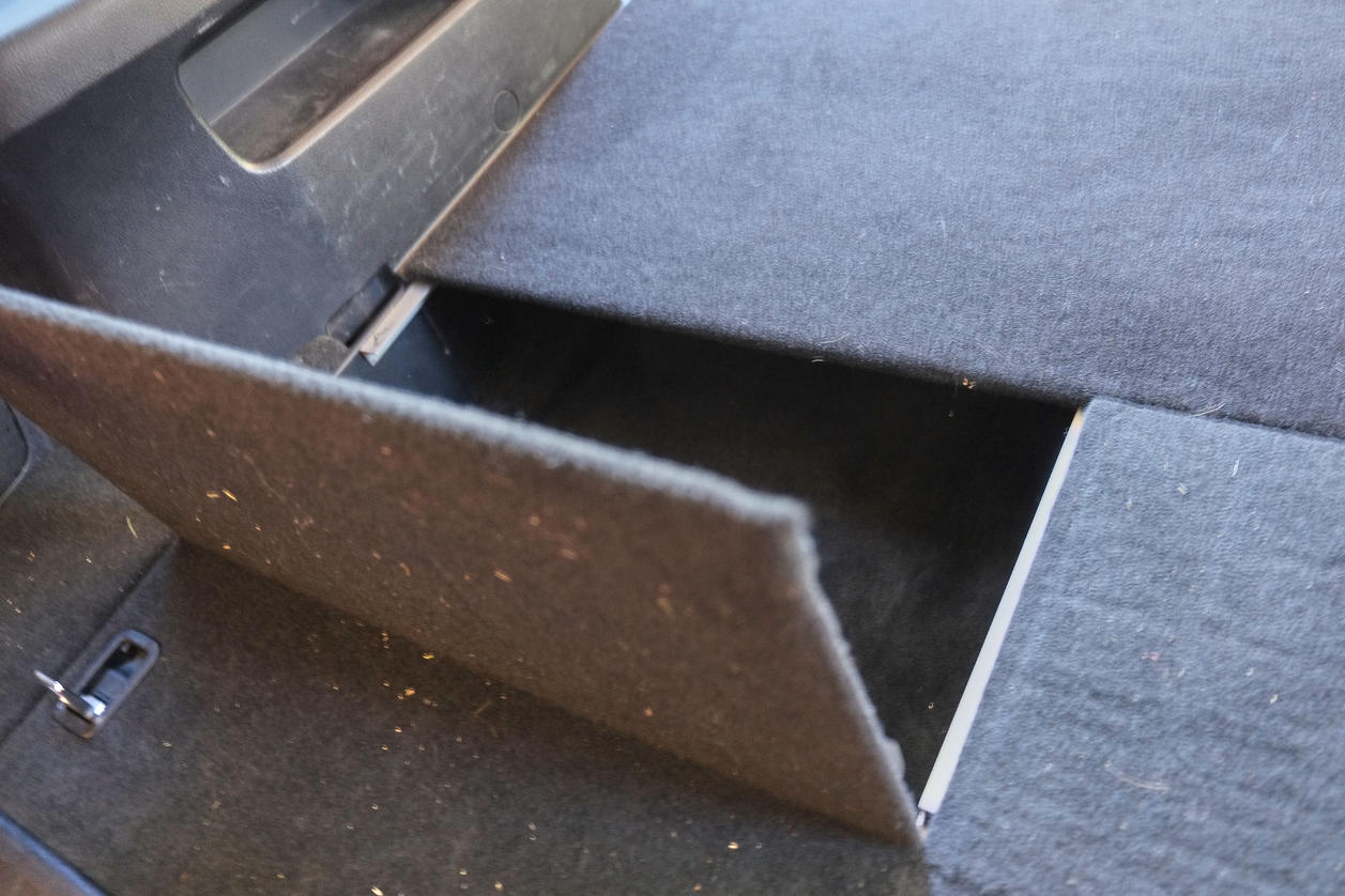

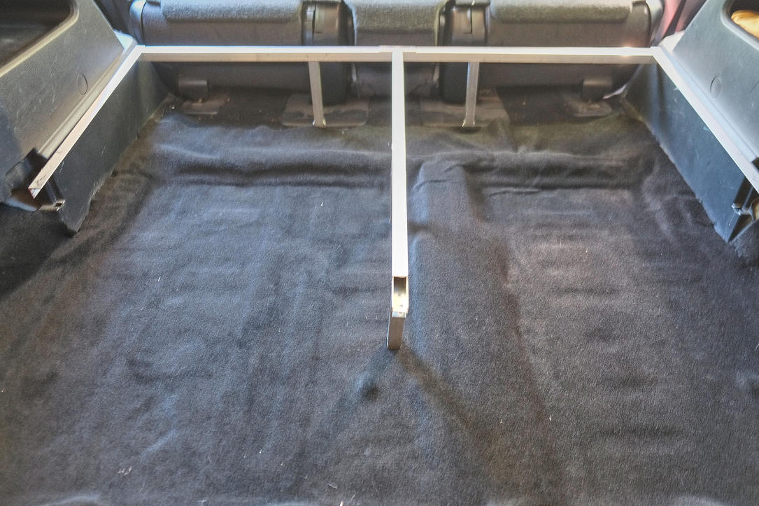

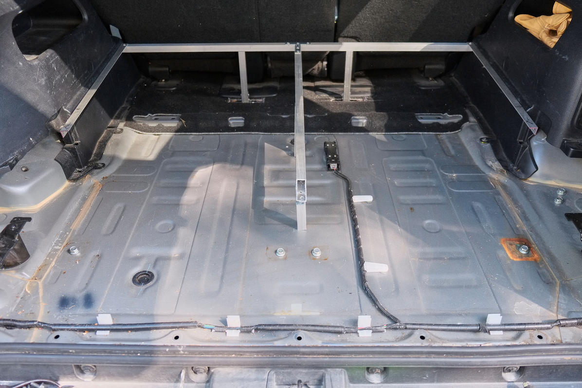

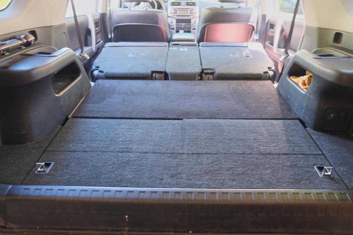

Getting ready to remove the 3rd row seats.
Removed seats, sound deadening while I have the seats out.
Had a little helper while I measured out the interior and cut the plywood.
Measuring out the plywood and ensuring it fits.
Using the stock mounting holes from the seats, so I installed some supports in, since it's not completely flat.
Get measurements for the tracks
Carpeting for all the plywood pieces
And that's about it
