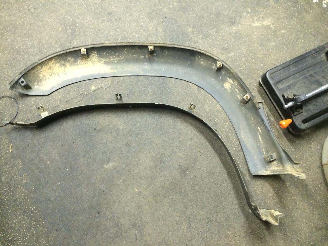

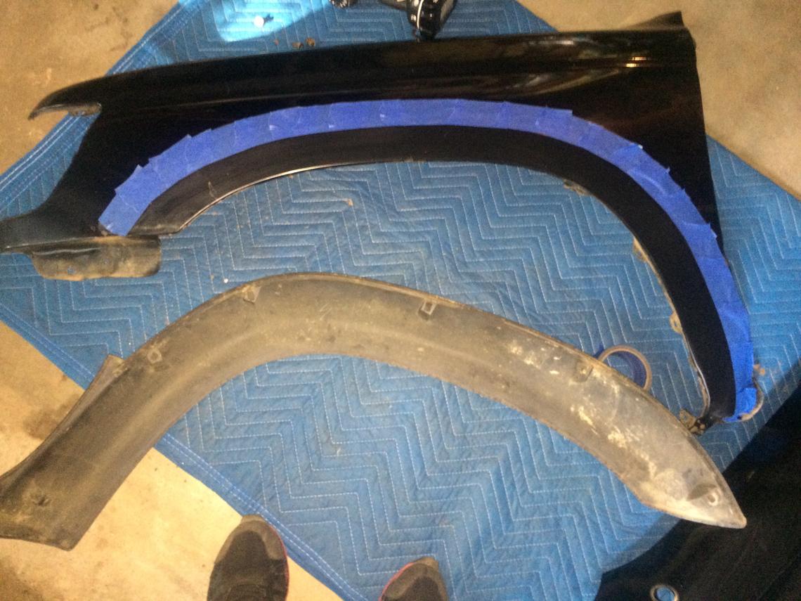

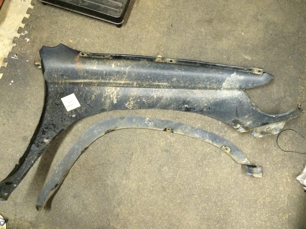

I cut varying amounts of the fender and shaved the inside of the flare off. I suppose to gain more clearance from the flare you could shave more than just the inside and take it up the ~2" where the flare transitions from flat to curved. I would personally consider that your best option unless you want to get another set of flares and cut them all to pieces and mesh them back together combined to make the flare taller and shifted farther forward in order to remove more of the fender and retain a factory look. (on a side note I'd love to see an attempt at this by someone)
In the three pictures you'll see what was removed.
