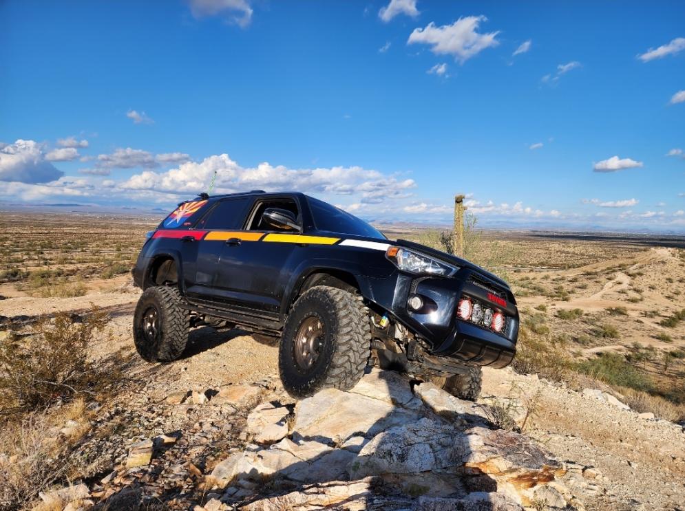

I know run 35 Toyo MTs and I did the BMC, viper cut and added some 3d printed front bottom quarter panel plastic... Running BILSTEIN 8112s in the front and Dobinsons MRR long travel in the rear.

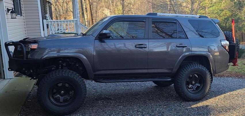

I have a friend that didn't really cut any fenders outside of maybe a slightly larger TRD Pro bumper mod.... but the front end still looks factory. He has Dobinsons C59-354 front springs (Dobi IMS shocks) and C59-701v rear. He has -12 offset methods and 35x12.50R17 Yoko Geolander MTs. He had do do the body mount and pinch weld and he may have had some slight rubbing but nothing to cause any issues when we got if fully articulated.
