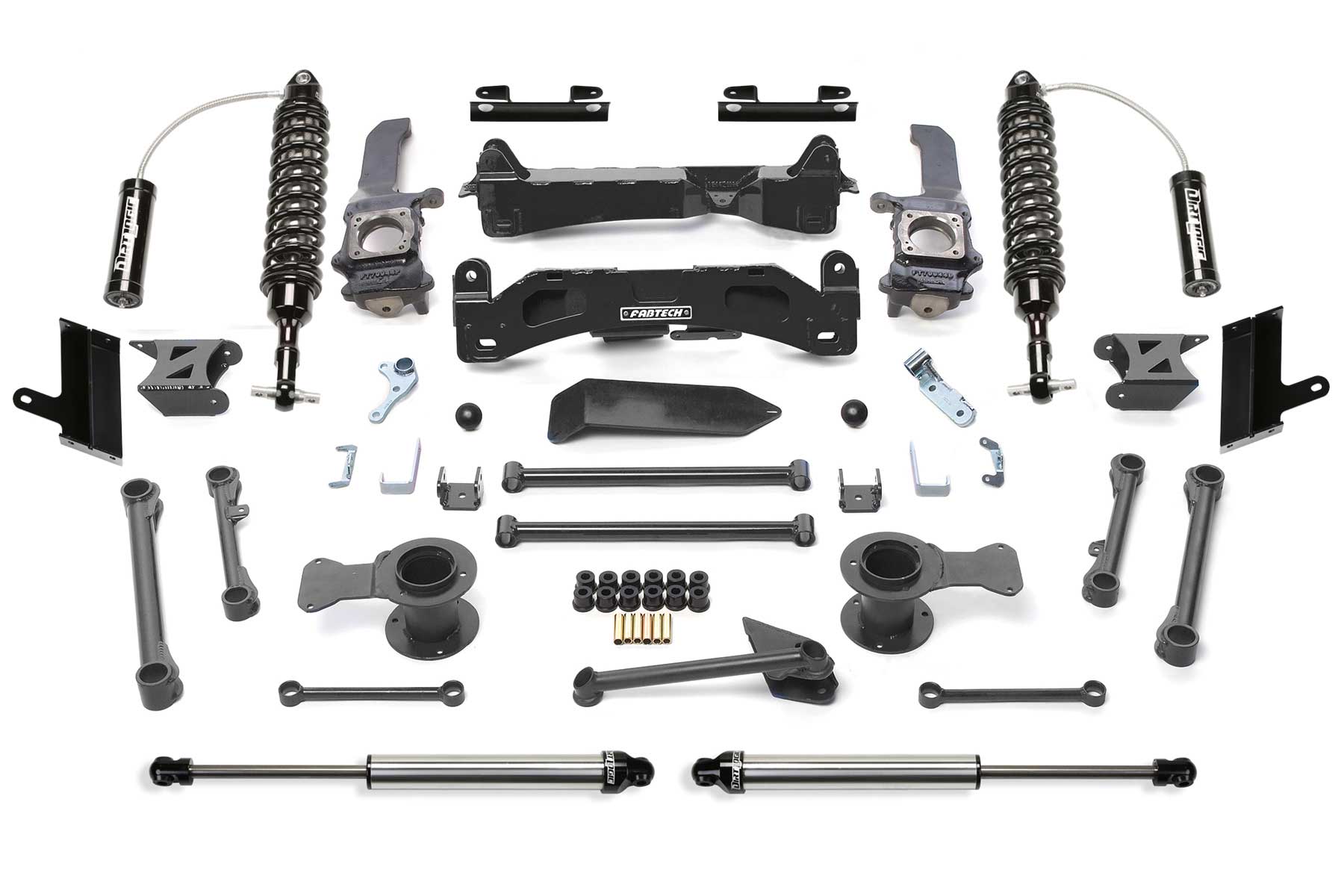

Umm... Why does everyone stack lifts and springs and spring spacers and then switch to aftermarket coil overs to try to stuff big tires under their vehicle when there are perfectly good systems made that actually give you REAL measurable lift so you can actually fit larger tires with less headache?
6" Performance System w/ Front Dirt Logic 2.5 Resi Coilovers & Rear Dirt Logic Shocks - K7068DL - Fabtech(R)
Whos stacking lift springs and spacers? Those 6" lift kits are just for show/mall crawlers and are pretty much the definition of adding spring spacers just for looks. The easiest way to make them fit is with long travel kits.
I am sure you've been on the forums and out in the world long enough to see people who put coil spacers on top of the coil-over, along with lift springs on the coil-over, and people who have done the spring spacer, coil-over spacer, and lift springs. These are pushing the A-arm down to provide lift sure, but anything above 2.5" in the front and you dont really have the ability to do a perfect alignment, the caster is going to be out of spec ect. Plus the ball joint in the upper A-arm is at a pretty good angle.
The drop down brackets to lower the lower A-arm position, plus the longer spindles to also drop the hub location, and topped off with the longer coil-over is what provides the lift without having axle angle or ball joint angle issues. That kit pictured is 6" of lift up front and with the coil-over top hat being adjustable you could likely dial in the lift to give you 5, or 6, or maybe even 7" of overall lift depending on what you need. This would be my personal opinion on the "best" way to clear a 35" tire without cutting anything since your OP seemed like you were anti-body trimming. I personally prefer the stuffed look and like my tires tucked in under the body. With the tires i like, if i had any offset different than a stock wheel i would rub like crazy. If i was trying to run 35s without rubbing though i would be looking at a lift like pictured above with drop down brackets.
Naturally you have your opinion, i have mine, you might want them stuffed with as little lift as possible and thats ok too. I just dont see them fitting without a lotta cutting.
I don't disagree with that kit providing 6" of lift in a way that corrects a-arm angles etc, but doing it the correct way with one of the LT kits such as TC, dirtking, camburg etc. would still keep the lift to a reasonable height while correcting/maintaining correct geometry and driveshaft angles while still providing the same ground clearance of 35's.
The LT kits move the wheels forward as well as outward so the tires wouldn't rub on the firewall. I just am not at a point I am ready to jump down that rabbit hole.
That 6" lift also would be worse offroad because the center of gravity would be so much higher. I know in some situations I have already been in, if I had a 6" lift I would have flipped.
I ran 285/75's for a while and still had to do some minor bumper trimming, rocker cap trimming, and BMC. I could fully articulate without messing up the fender. If I did it again I think I would have done 295/70 instead of the 285/75's; width looks a little better.
Yea I have my front bumper trimmed back quite a bit so it should clear, just need to do the bmc and pinch weld mod. I also saw a company makes high clearance endcaps and ordered those instead of having to trim my oem ones. Thanks for confirmation that 285/75 is much easier to stuff. 295/70 would be nice but falken doesn't offer wildpeaks in that size unfortunately.
Those bracket lifts are complete shit. If you take them on actual trails they fold up like a cheap suit.
