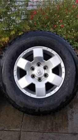

I found some FJ wheels (and tires) on a local website. They are 17" x 7.5" and I believe the factory rims on my 2013 Limited are 20" x 7.0". Will the additional 0.5" width create any clearance/rubbing issues? I think one of the other 2013 models (trail or SR5 came with 17" x 7.5" rims but I can't be sure.

Shouldn't be an issue. The offroad trims come with a 17 x 7.5 wheel.
Yes, your 2013 Limited has stock 20 x 7 rims that likely have a 245/60R20 tires on it.
Going to a 17 x 7.5 rim with a 265/70R17 tire will be perfectly fine.
I have a 2011 Limited that came with the 20 x 7 rims and 245/60R20 tires. I use a set of 17 x 7.5 rims from a 2018 TRD Off-Road with my winter 265/70R17 tires and have no issues whatsoever with fitment, clearance or rubbing.

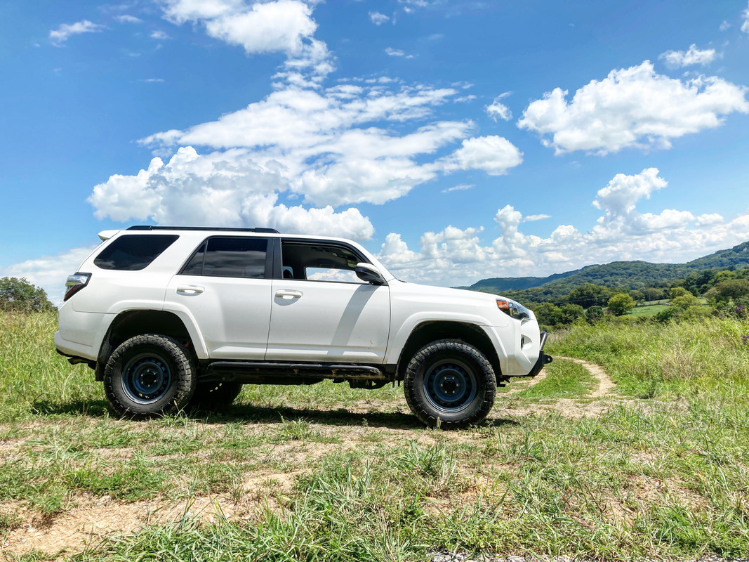

FJ Steelies, same spec

17" FJ wheels (10 hole) are the same at the old '10-13 Trail wheel other than color. The 6-spoke wheel is the same 17x7.5" as well. So they fit fine, as they are also the same dimension as the current Off-Road wheels which will also fit a Limited just fine. As for 4Runner rims, the Trail and the Off-Road wheels are 7.5, the others are 7".
