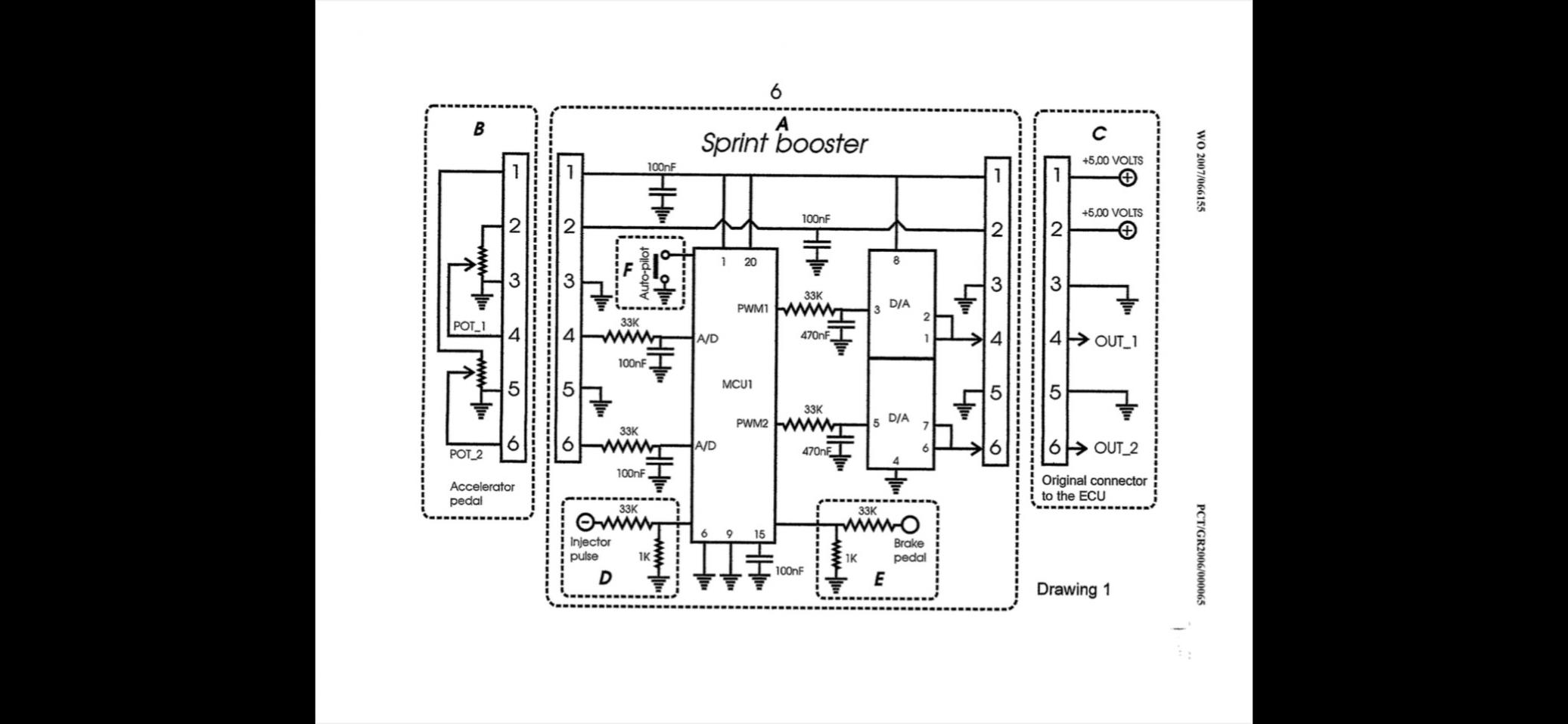

Here are the Sprint Booster patents, from the US and Australia. They provide some interesting reading info and the schematic. These must be early generation patents; the cruise control function is not implemented in the SB version 3. At least it shows that it maintains the dual channels that the 4R ECU needs to do a health check of the accelerator pedal position sensor (gas pedal) plus SB combo.
US:
http://patft.uspto.gov/netacgi/nph-...8,706,373.PN.&OS=PN/8,706,373&RS=PN/8,706,373
Image:
Patent Images
Australian:
IP Australia: AusPat Disclaimer

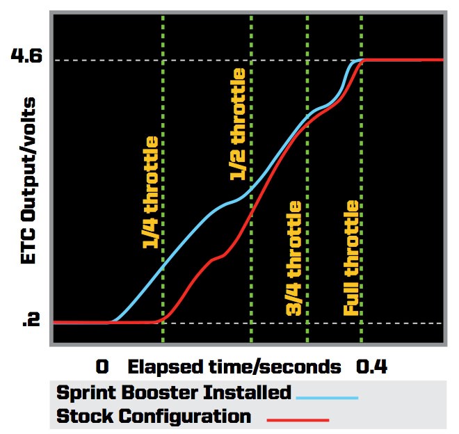

Diagram from the Sprint Booster website. Here’s what the SB does to the outputs going to the ECU. Simple but effective.
BTW, the time scale on the horizontal axis is irrelevant, in fact it’s wrong. What it really shows is angle of the pedal vs voltage output.
