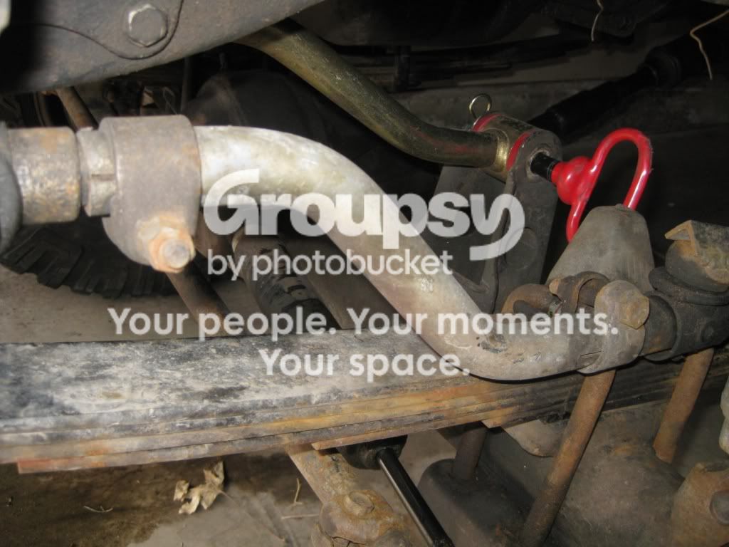

I just noticed you don't have your dogbone hooked up. You're still push-pull, right? How much brake-steer do you get?
I still use it on the highway, just unhook it when i wheel. here's my quick disconnect setup :biggrin2:
IMG_2121.jpg~original
its just a standard 5/8" diameter hitch pin, can get em at most hardware stores for less than 10 bucks. the bar itself came with my dropped drag link.
side note: I had to cut 2" off of the drag link and the "whishbone" part when i moved my axle forward, then retap the internal threads. its kind of a big job but if your axle is in the stock location you have nothin to worry about

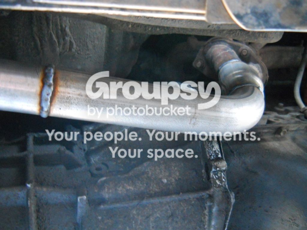

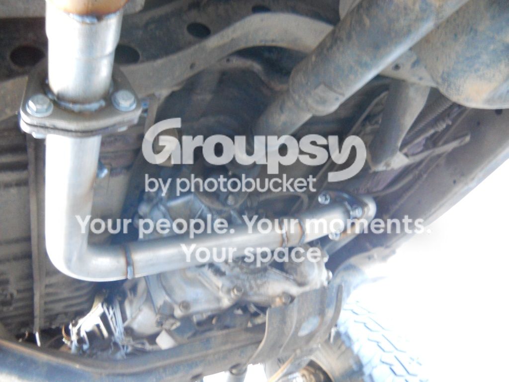

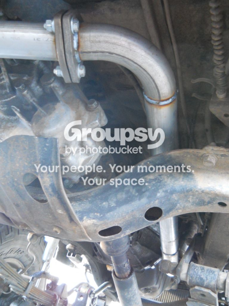

got tired of sounding like a ricer so i got some new exhaust:
DSCN1302_zps5ad0b3a5.jpg~original
DSCN1299_zps8bf8b5c1.jpg~original
DSCN1297_zpse902c56f.jpg~original
Had the front half built by a shop cuz i didn't want to mess with all the bends required for the x-over. they adapted it to my old muffler and tailpipe for now but i'm gonna replace all that when i get some time.

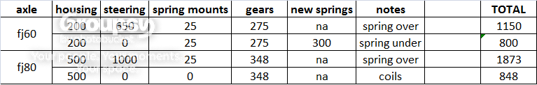

here's a price comparison i threw together:
well thats where i'm at for now. any feedback would be appreciated.

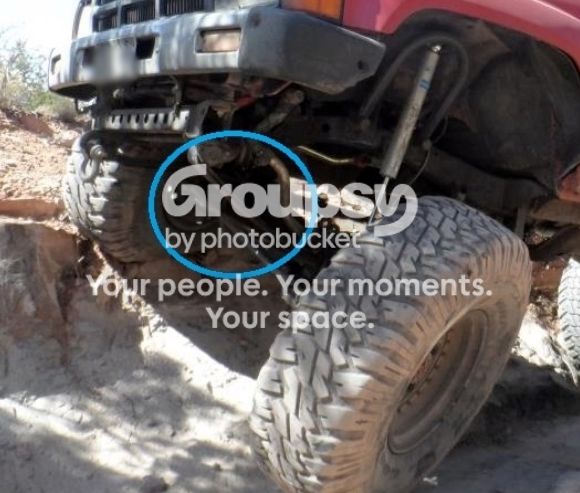

Great action shots of your rig on the red rock! Looks like you're getting really good articulation from your set-up. That is such a cool place--those trails really let you know if what you've done works.
