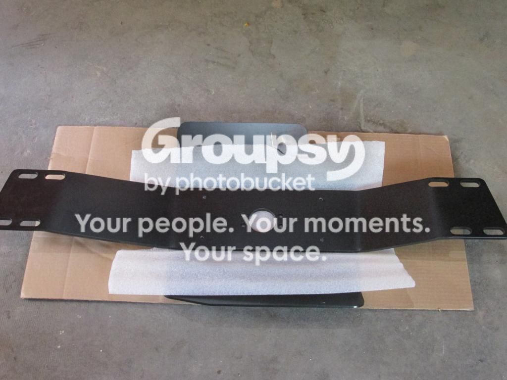

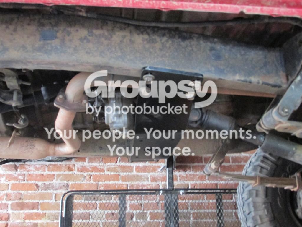

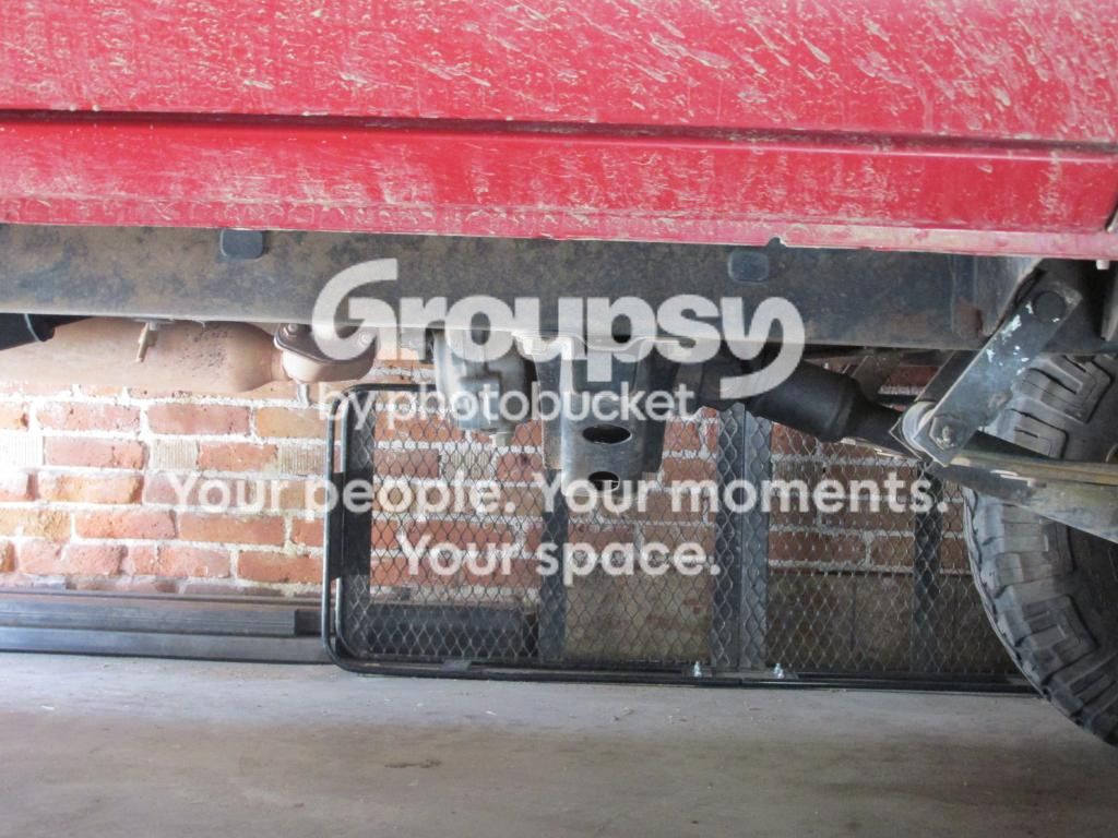

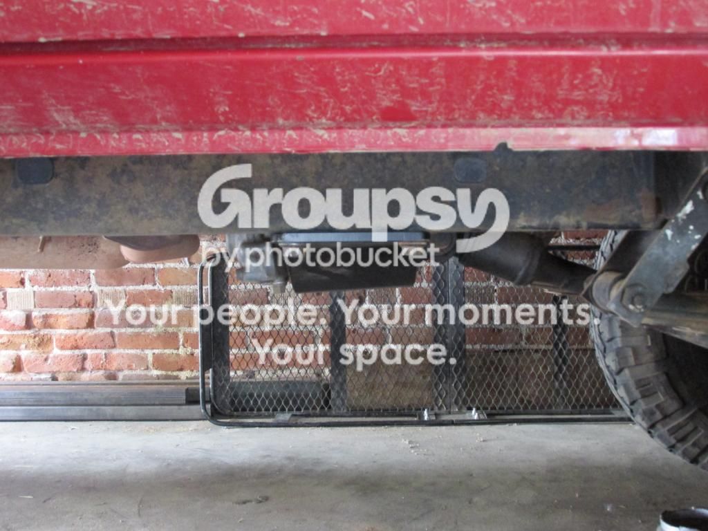

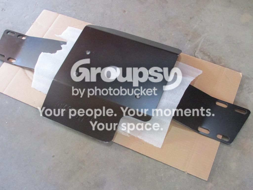

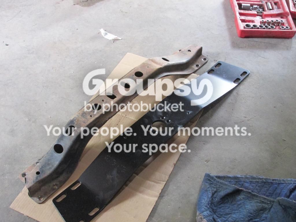

Budbuilt Crossmember Install

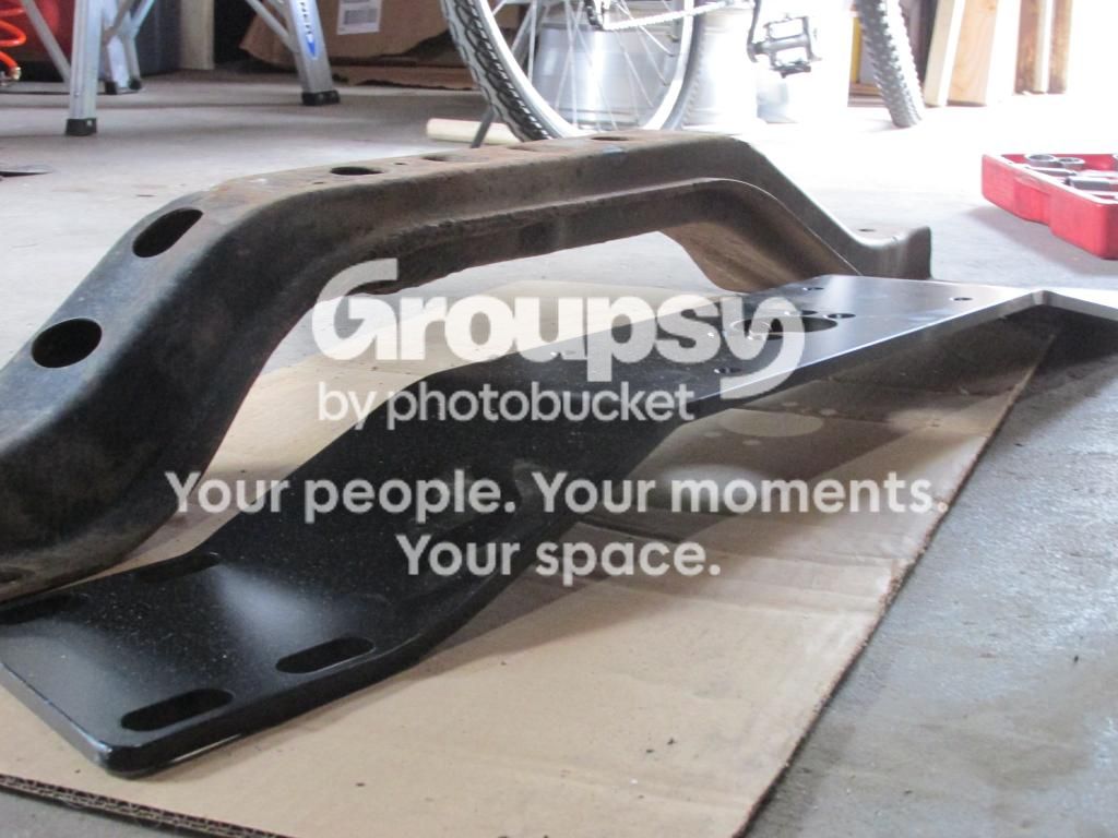

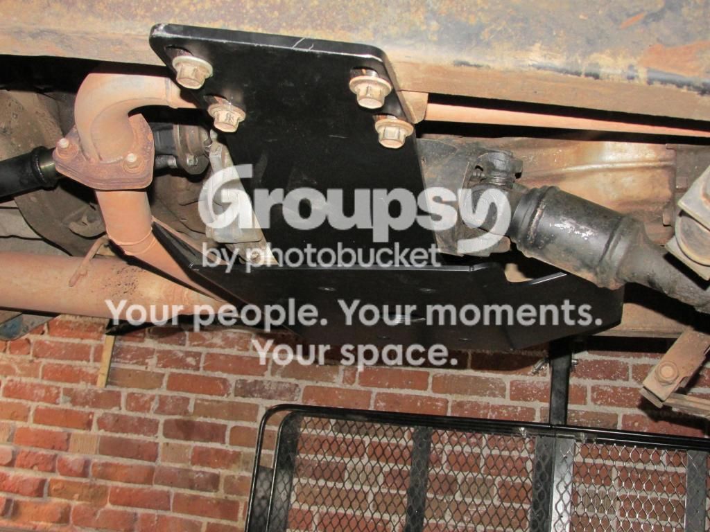

Wrenched most of the day yesterday. lots of odds and ends done and installed the budbuilt that's been sitting in my garage for 3 weeks. I gained about 3" of clearance using a 1" drive-line lift crossmember.
Unpackaged:
Factory one extended about 6.5" from the bottom of the frame:

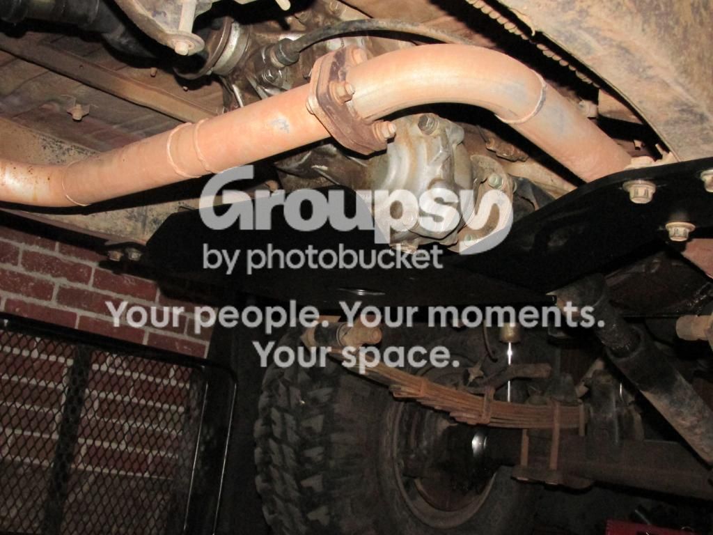

Installed. Budbuilt measured about 3.5" from the bottom of the frame:
With the skidplate:
Overall i'm very happy with the product budbuilt makes. seems to be well made, fits as intended, and comes with all the required hardware. They are not timely though, so its a good thing i wasn't in a hurry.
IMG_0328_zpscc9dbb0c.jpg~original
That is dead sexy, and way better clearance than the skid I've got.
So you don't have a body lift though, right?
I have a 1/2" body lift that i made so that the engine would clear the hood. so i figured there was enough space in the tunnel to clear a 1" Drivetrain lift. Its darn close but it worked!

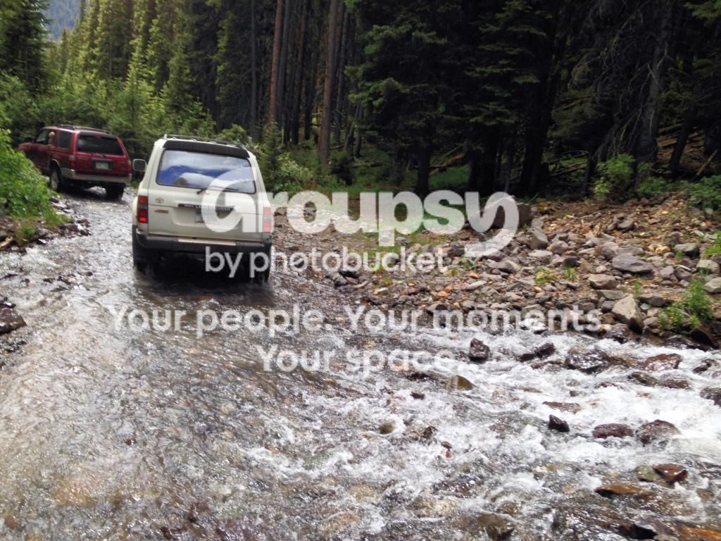

Loaded up for the 7 hour drive accross colorado
Black bear was closed so we had to settle for Imogene pass:
came back Osher pass
Had an awesome trip and the trucks ran great, no one broke...not even the land rover guy haha. i did slit a tire but what can ya do
