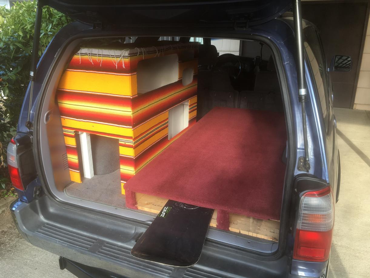

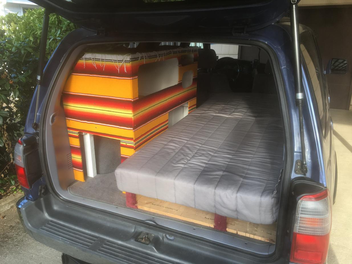

I made a camper setup for $0 for weekend trips that has served me well but is very basic...and heavy. I’m actually finishing my rebuild of it right now. I decided to add a drawer under the bed to house my camp stove and other cooking/living essentials. I’ve also found that having a large roof cargo box is a great way to keep the tiny living space a little less cluttered.
At some point I’ll rebuild the serape storage unit to house a slide out cooler fridge and if possible, relocate the grill under it as well. Add a sink, some water tanks under the bed and ba-boom!
Also I still have the rear seats in, I’m 6’3” and fit with the passenger seat slid forward a couple notches.

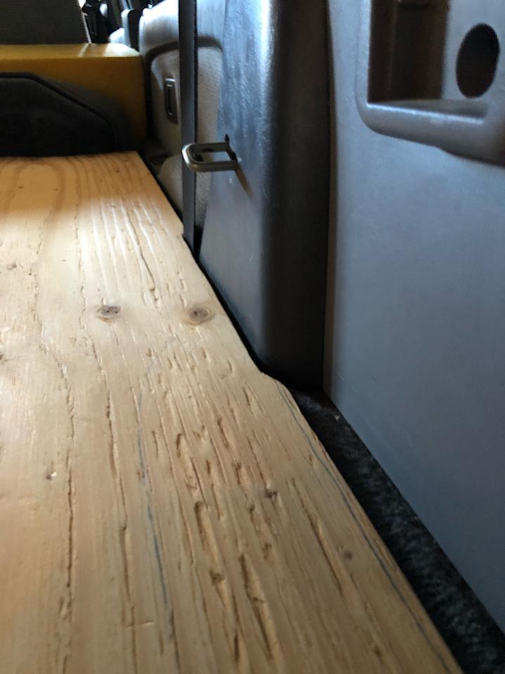

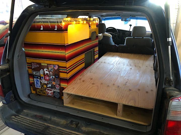

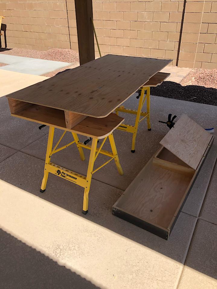

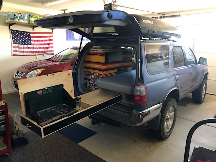

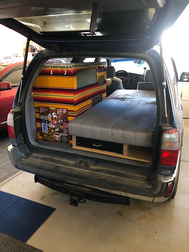

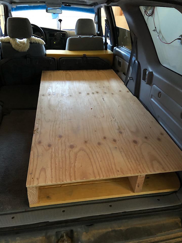

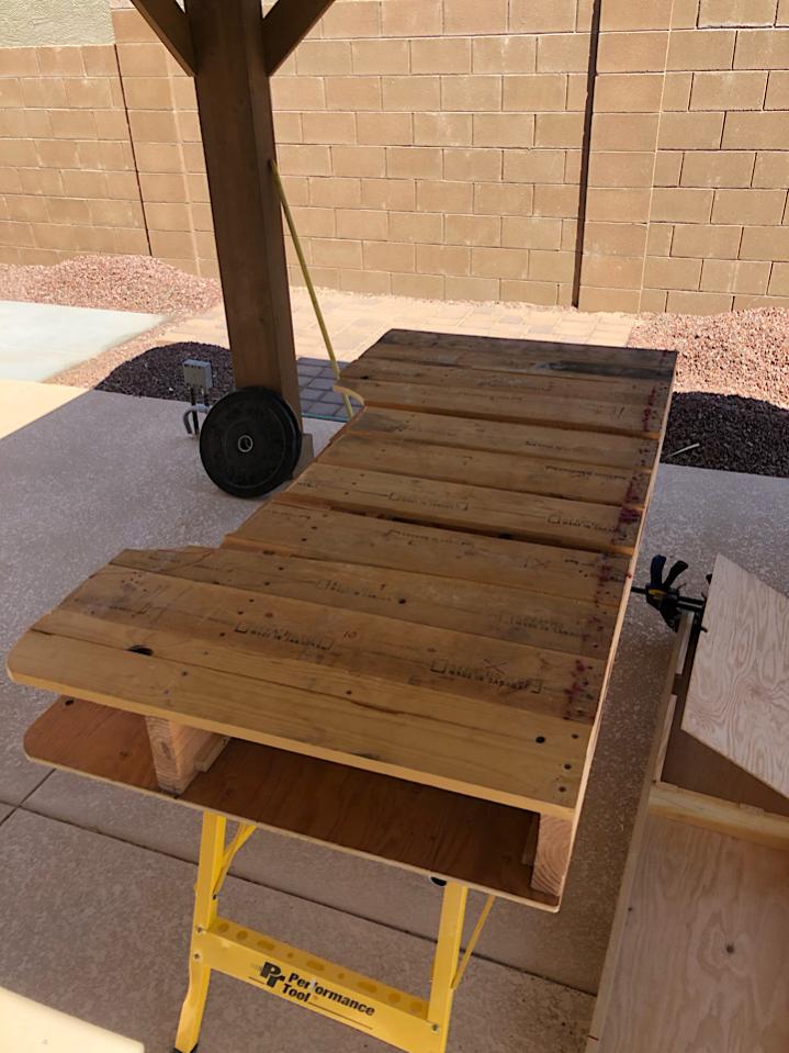

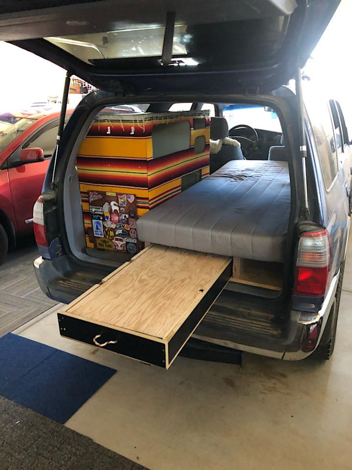

Finished the laborious rebuild of the pallet bed w/ drawer. I basically took the old pallet apart completely and replaced the two 2x4s with 2x6s in order to increase the inside height so I could fit a drawer big enough to house my little camp stove. I’m going to pick up some carpet and reupholster it at some point as well. If anyone is interested in making one of these platforms out of a pallet it’s supper easy. Just measure where it’s going to go, measure all the little cut outs you’ll need for the wheel well and along each edge, apply to top /bottom of pallet and cut with a jig saw. Throw a mattress on it and you’re campin’. I spent $0 on the setup and used it for a year. I just spent 3.50 on some hinges for my drawer so that’s how much money I have invested in it so far. If you have scrap wood and screws or nails, you can make you’re own in a day or two and have a cheap entry into camping out of your rig.

sick setup!!!!
