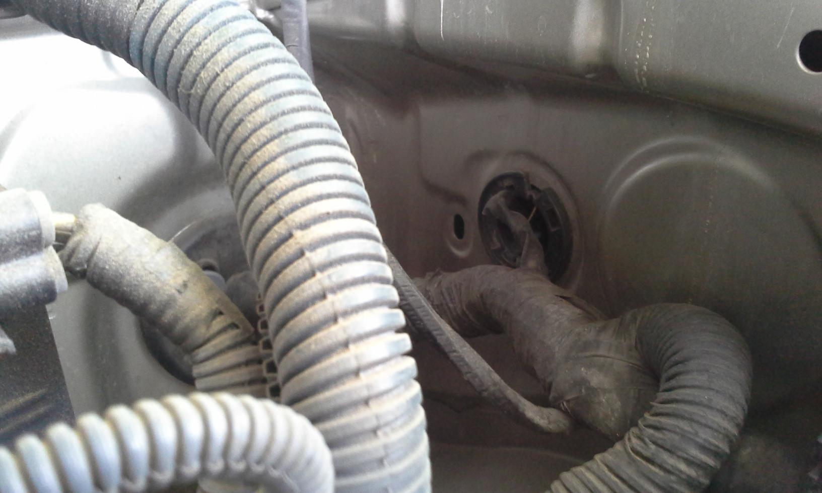

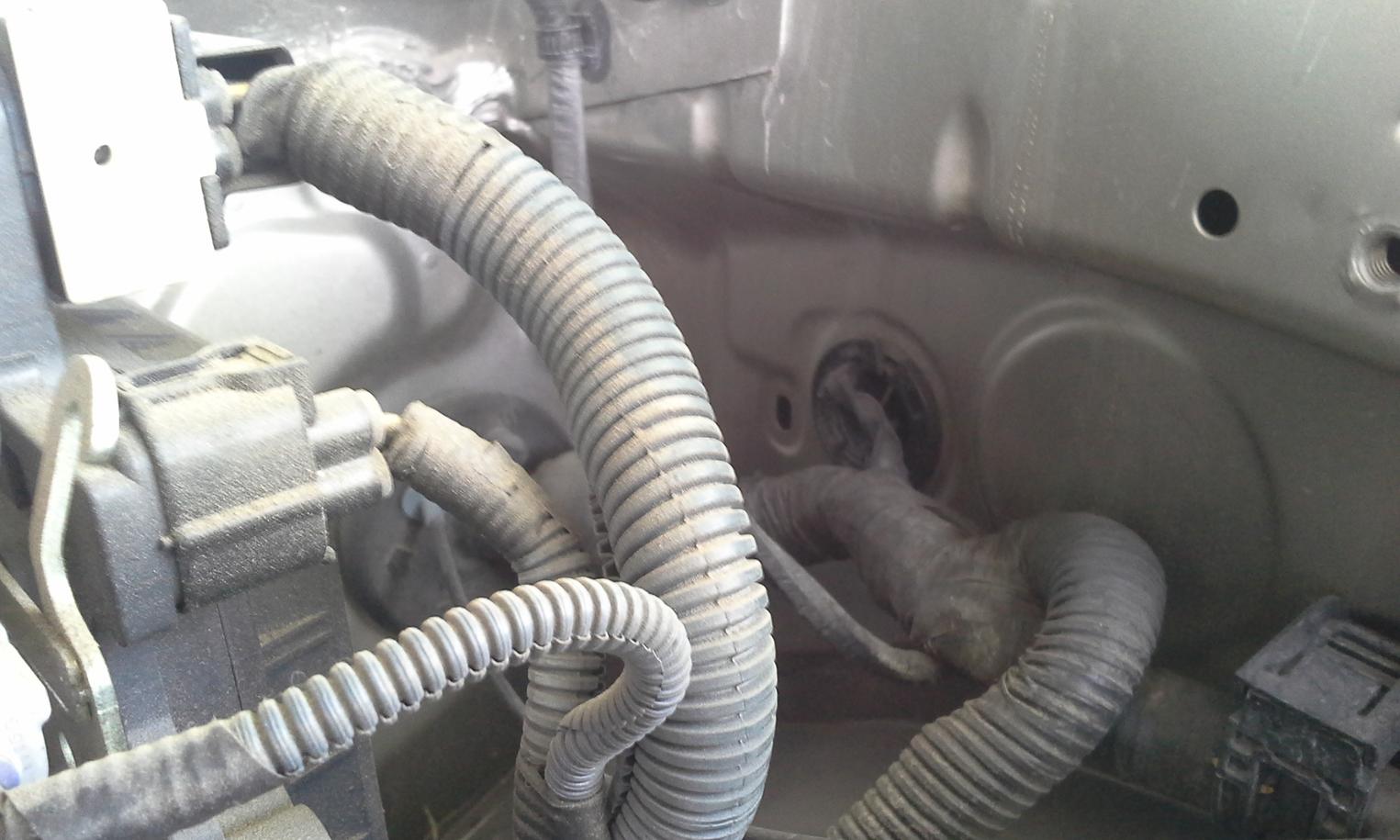

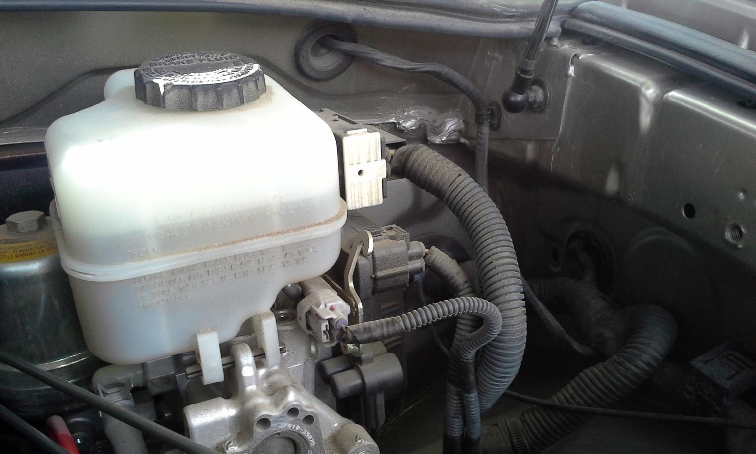

Took mine out 1st thing , it's in the driver side wheel well next to brake booster in the inside of fender . Obviously easier to find by beeping it to find it . Some wire cables going into it , kinda hard to pull out but doable . No speaker to my knowledge . Get a pic up manana !
Here ya go
Hope these help ! Little bit back in the corner you can see where in the well the plugs go ?

They didn't change that much in 2 yrs ! In the 1st pic I zoomed into that wire going into the side where wire is going , it's in there if you still have it ! We call it a" pizio " do s search Pretty small little box maybe size of a golf ball in the side fender well . I had to pull pretty hard to get it out . Hell if you want one I'll send you my old one . I also unplugged my seat belt bell

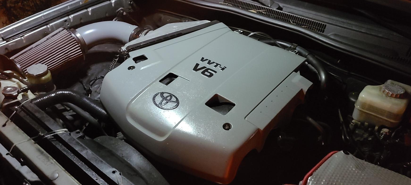

Alarm beeper thing
So I removed it and unplugged it the little piezo box or whatever, question is does the alarm still arm and work? When I lock the doors with the key fob the alarm icon still blinks on the console, and you can hear the doors lock?
