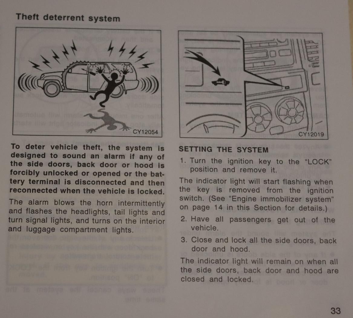

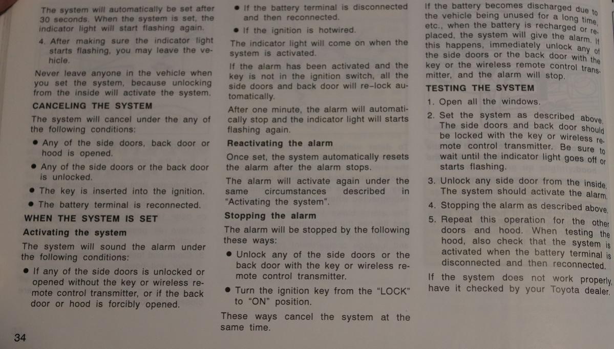

I not sure and I could be wrong but I think none of the 4TH Gens have a "Factory Alarm" meaning from the Toyota factory, there are however dealer installed aftermarket alarms installed on many 4TH Gens.
True car alarms activate the car horn if I not mistaken, not the "beeper".
theft deterrent system
2004 owners manual
pg. 33-34
