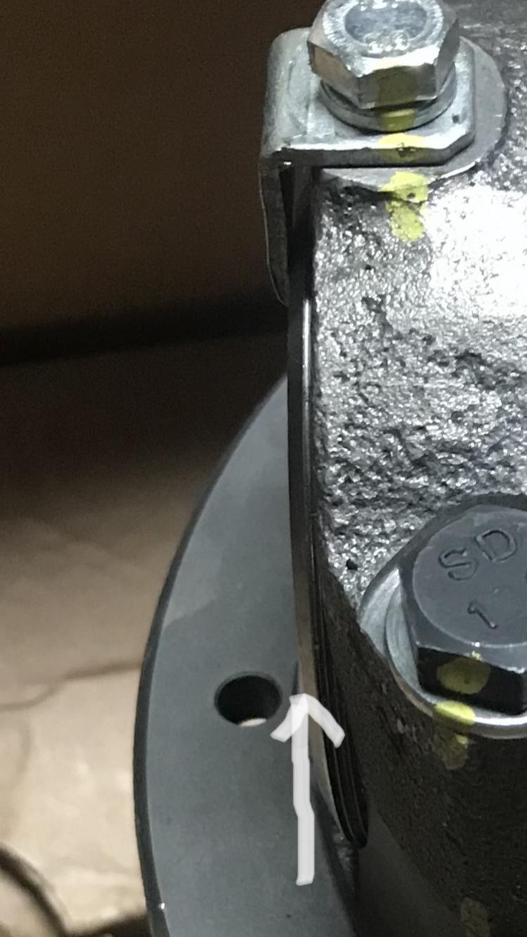

If and when you get the new third, follow the break in procedure. Took a month for me but I was patient. After the 500 mile oil change that oil will be black with a silverish hue. Btw...the new third with locker is a lot heavier!!
Almost forgot..if you get one with the aftermarket housing you might need to sand/grind some of the opening of the rear axel housing where the third goes in. Mine was wide enough at the adjusters where it would not slide in.
