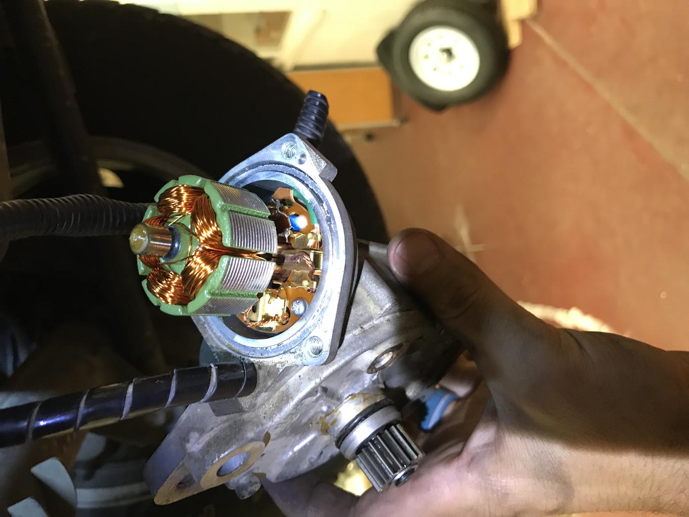

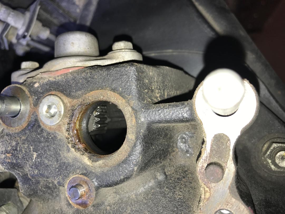

I have the problem of the red light flashing and never getting locker engagement nor the associated steady red and have gone through all these steps. I took the actuator out of the 3rd member on the axle since so many threads on this topic described the actuator getting stuck. I could engage the locker manually with a screw driver by sliding the fork towards the pinion so that wasn’t stuck. I removed the electric solenoid motor (top black cap with three Phillips head screws) and inspected it and no problems there.

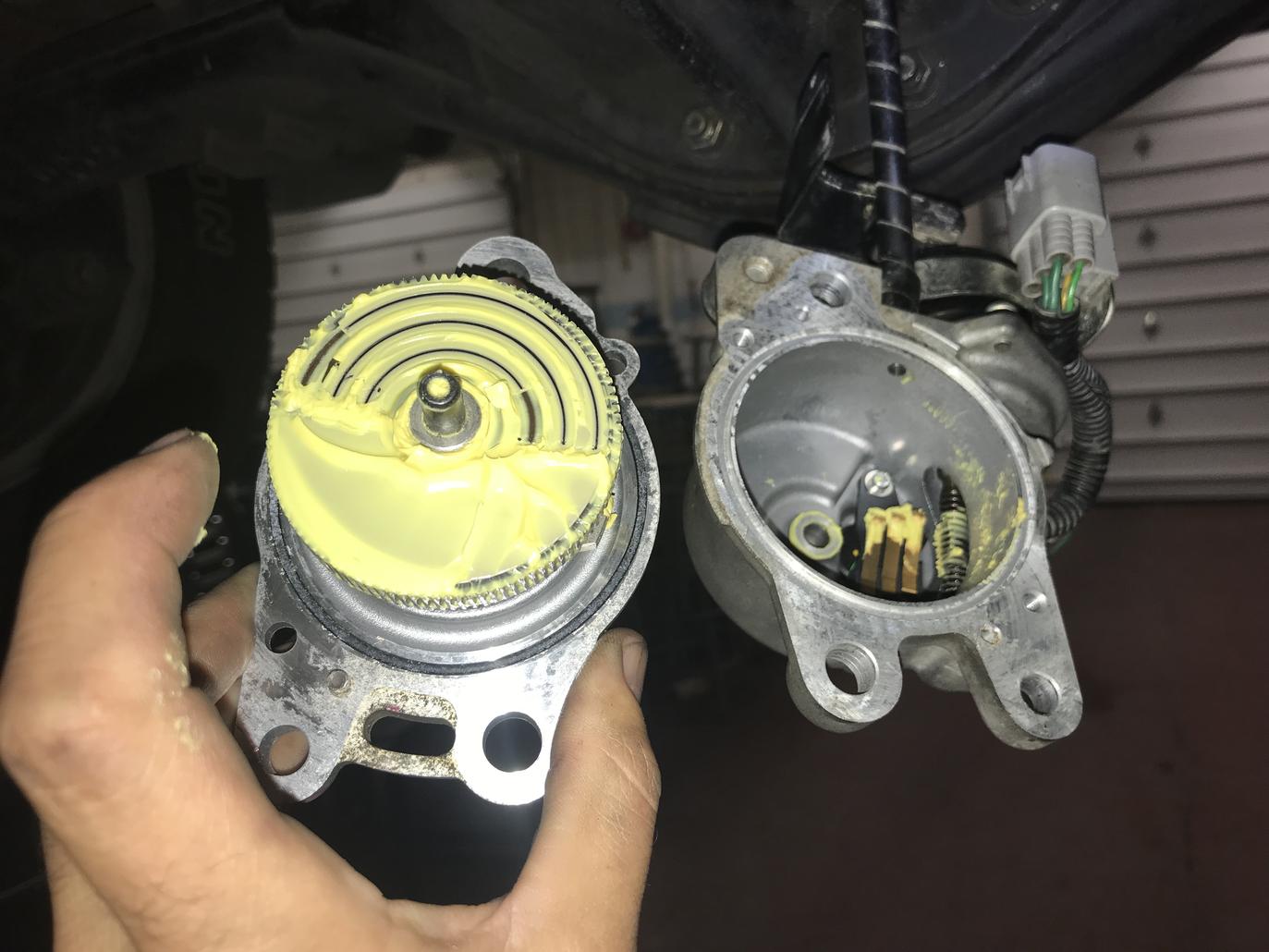

I also disassembled and inspected the gear mechanism that constitutes the majority of the solenoid assembly. No unusual wear, all connectors were tight, all components were clean and greased. With the actuator out, I applied 12V to the large green and green/red wires and the motor turned so it does work. Seems to be a delivery problem.
BTW, I re-installed the locker actuator forgetting to return the motor’s position back to the full ‘locker OFF position’. This will trigger the red flashing light that implies the shifting process is in transit somewhere between full OFF and Engaged. The sensor for this is inside the gearbox of the solenoid. I had to unbolt it and run the gearbox to the unlock position until it hit the stops.
Hope this helps someone who comes across the same situation. Learning about the system as I go! Now it’s time to test whether there’s power or a signal getting to the locker solenoid.
