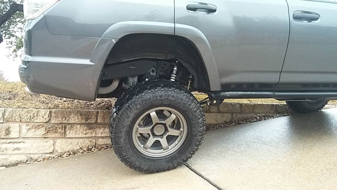

Just an FYI, I put the rear sway back on today. I added some bushing to help extend the links a bit longer. Drive is so much better on the road... There is still plenty of flex. I think it only lost about 1-2". I snapped a quick pic outside my house.
I think this is a great balanced setup. LT rear, no swaybar in front, swar bar in rear with extended links. I'll still probably remove the rear swaybar for off-road weekends.....

Looking good! That is a lot of flex with the sway bar, impressive.
