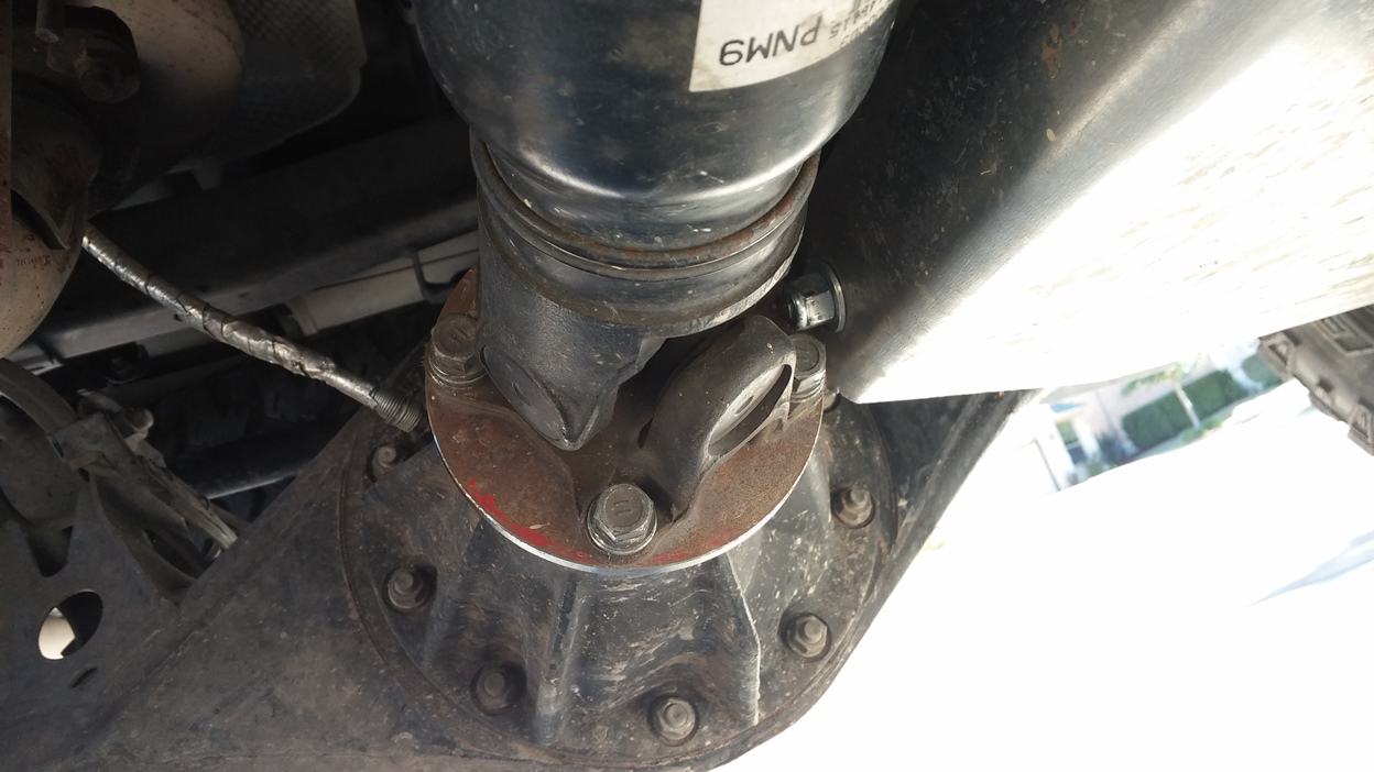

I'll get some. I had planned to get some off-road shots yesterday, then on the way to the trails I heard the drive-shaft flange bolts and the gas tank skid bolts slamming each other (happen on a turn into an off camber driveway at speed). It took me a while to figure out what it was, but it sounded horrible. I thought my entire drive line was coming apart. I was very happy to discover it was just something simple. I had the nut on the outside of the gas tank skid mount, but it had never hit before with my previous setup.
I put the rear swaybar back on for now. I like it much better like that on the road. It's just too loose without it for daily driving, IMHO. I feel it is tolerable like that for a trip to the trails, but not great for a daily driver.
To make the thread not worthless:

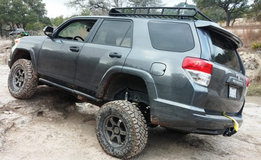

Attached is a pic of the drive shaft issue when flexed. And then one of the vertical down travel (no flex ).

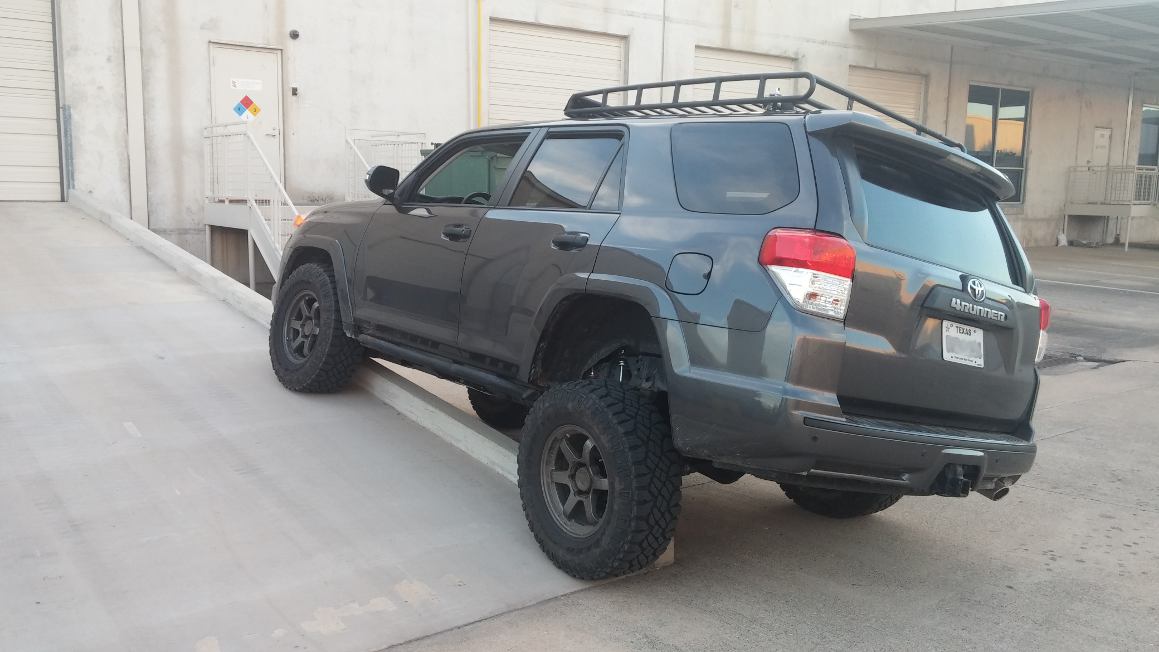

I tried to flex on a loading dock near my work today, but it was not steep enough to push it. I had the swaybar on anyway, but it was worth a pic. Need to figure out how to get my back wheel on the other side without rubbing.... First time to try this and was just going to lunch.

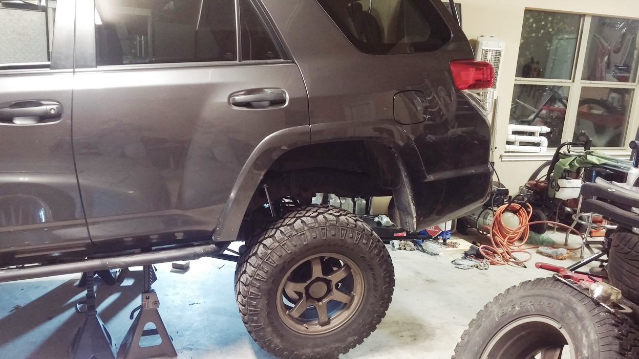

Quick update on this. Went out and hit the trails last weekend, but still had problems with the drive shaft grinding on the gas tank skid.
I did another flex test, so I thought I would post a pic.

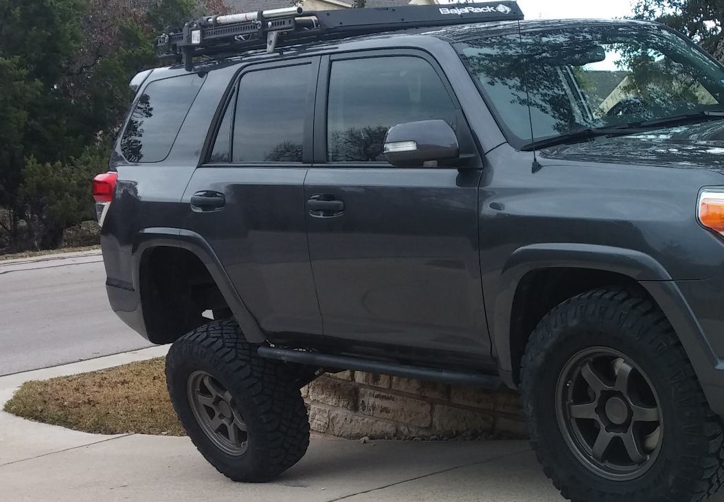

I grabbed one picture on Sunday... It's not even really flexed, but it shows a little of the down travel.

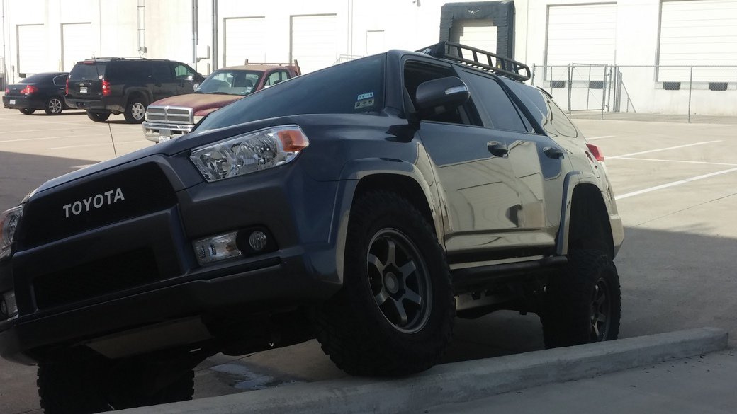

No sway bars, but I have had the sway bar on at times. It looses about 2-3" of articulated down travel. It can still get about what the pic above shows with a sway bar (and extended links). The max I have gotten out of it is shown in the pic below. It puts the top of the tire about even with my slider.
