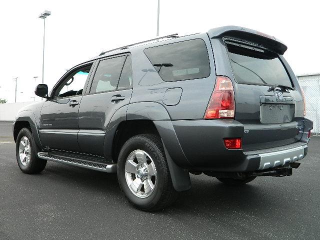

Well I ended up having to pass on the '03. Found a '04 Limited that has leather and nicer interior and the transfer case works! It's got a slightly mismatched color driver's door where it was in an accident and they didn't blend the paint to match properly, and it's got the usual Toyota rust on the chassis from being in a snowy climate for the first two or three years, but other than that this one is a cherry. I got to drive it over the weekend and I fell in love with it!
I'm going to try and trade my '12 Jeep Wrangler Unlimited in on the 4R tomorrow. Hopefully it'll work out.
