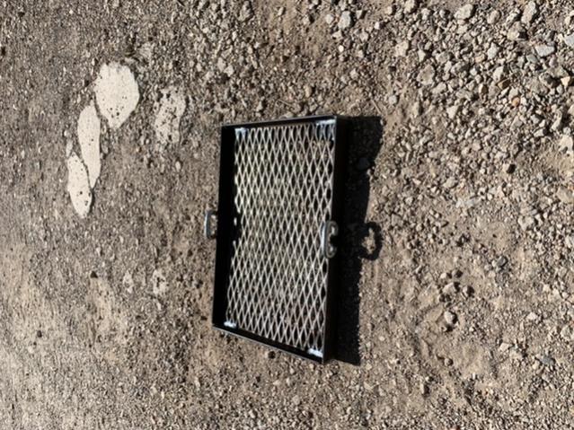

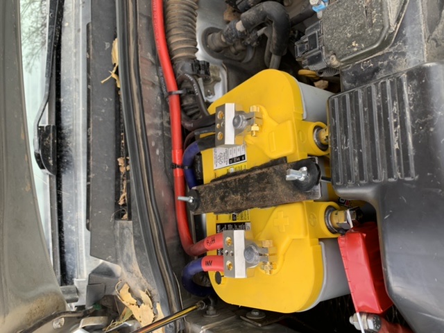

I made a tray out of angle iron and some expanded metal and a couple chain links for the anchor point for the hold down. I used a piece of 1/2” flat bar and and old bike tire for the hold down. There’s a bolt and fender washer run through an existing hole in the fender well and I built two small brackets for the inner fender and firewall so it sits nice and tight in there.
