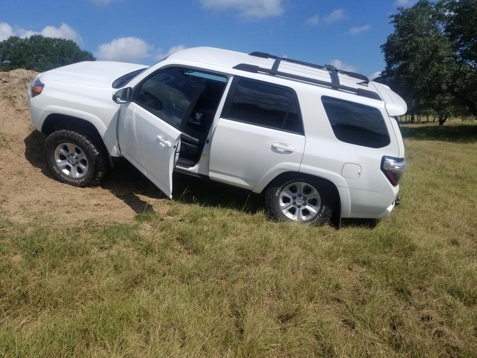

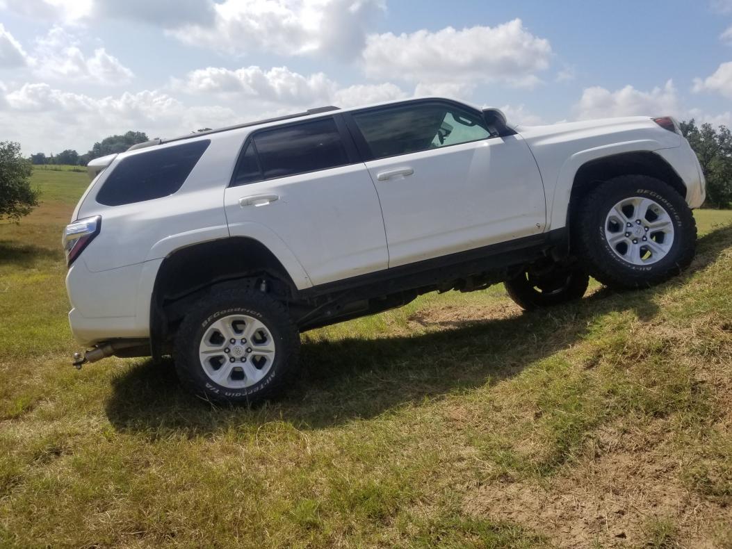

that's what i think.
Ah, that just one of the challenges of IFS. Trying to get equal flex front/rear.
Maybe try stiffening up the rear, add the sway bar back in if removed, something, to try and reduce it wanting to take all the articulation.
IMO as long as all 4 are on the ground you've got nothing to worry about, it doesn't matter if the front stays flat as a pancake.
Also, in that picture you have less weight acting on the front end as it's up in the air. Try backing up to the hill so you get more nose weight if you want to actually test front articulation.
Yeah, IFS doesn't really "flex".
This is why people do solid axle swaps, and why Jeeps still have a solid front axle. WAY better for offroading that requires articulation, and easier to increase the travel.
My old Grand Cherokee had a solid front axle, and the front would flex just like the rear of the white one above is doing.
