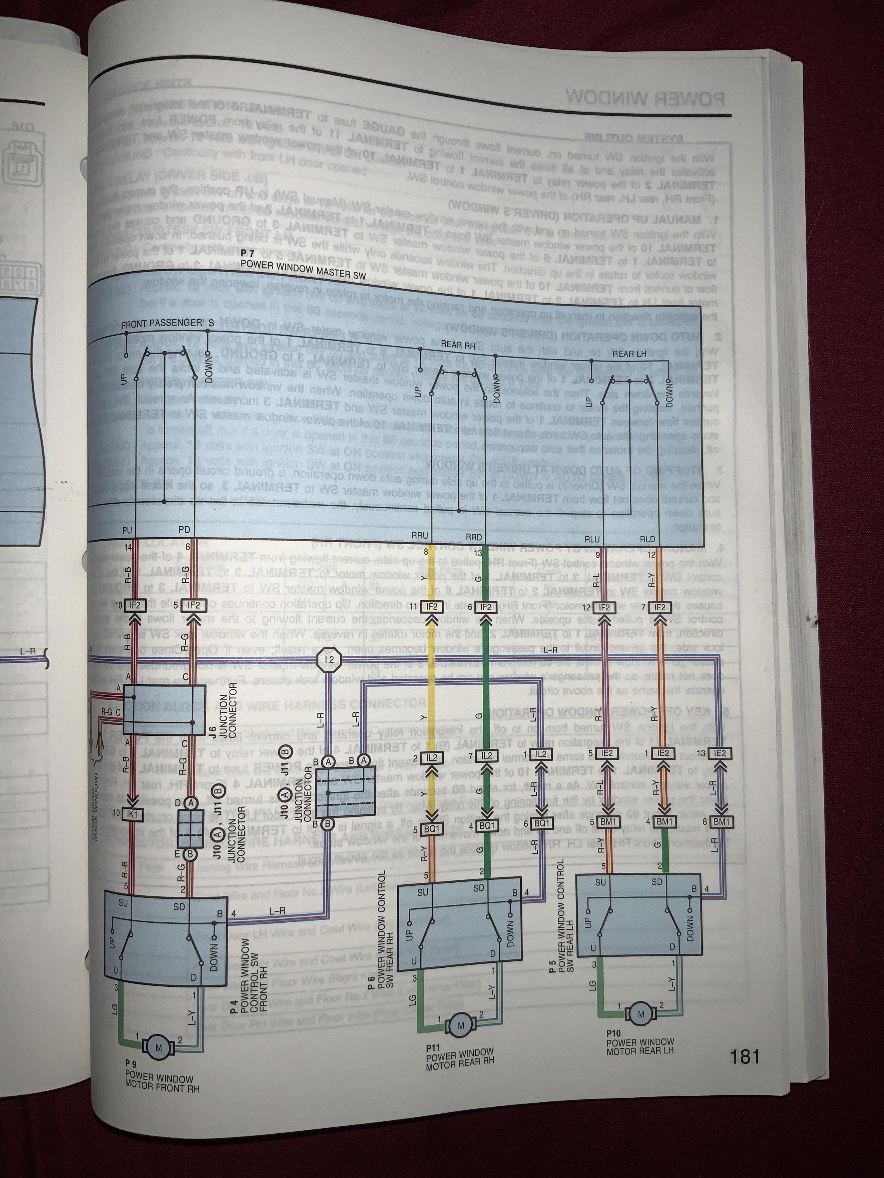

looking for window switch schematics for a 1998 and 2002
CWccw
I know of the FSM download but thats just one year to cover all. Mechanically thats ok but electrically thats a no go. I need the schematics for the front passenger window switch for a 2002 going into my 98. This is for the sport interior swap. The passenger side window switch is different.
The addition of auto up and down on the front windows (instead of just auto down on driver's, I believe?) was a pretty large change in the wiring. Your best bet is to figure out a way to put the '98 switch into the '02 door panel.
Extra wires for 'auto' communication, different window motors with load/limit switches, etc.

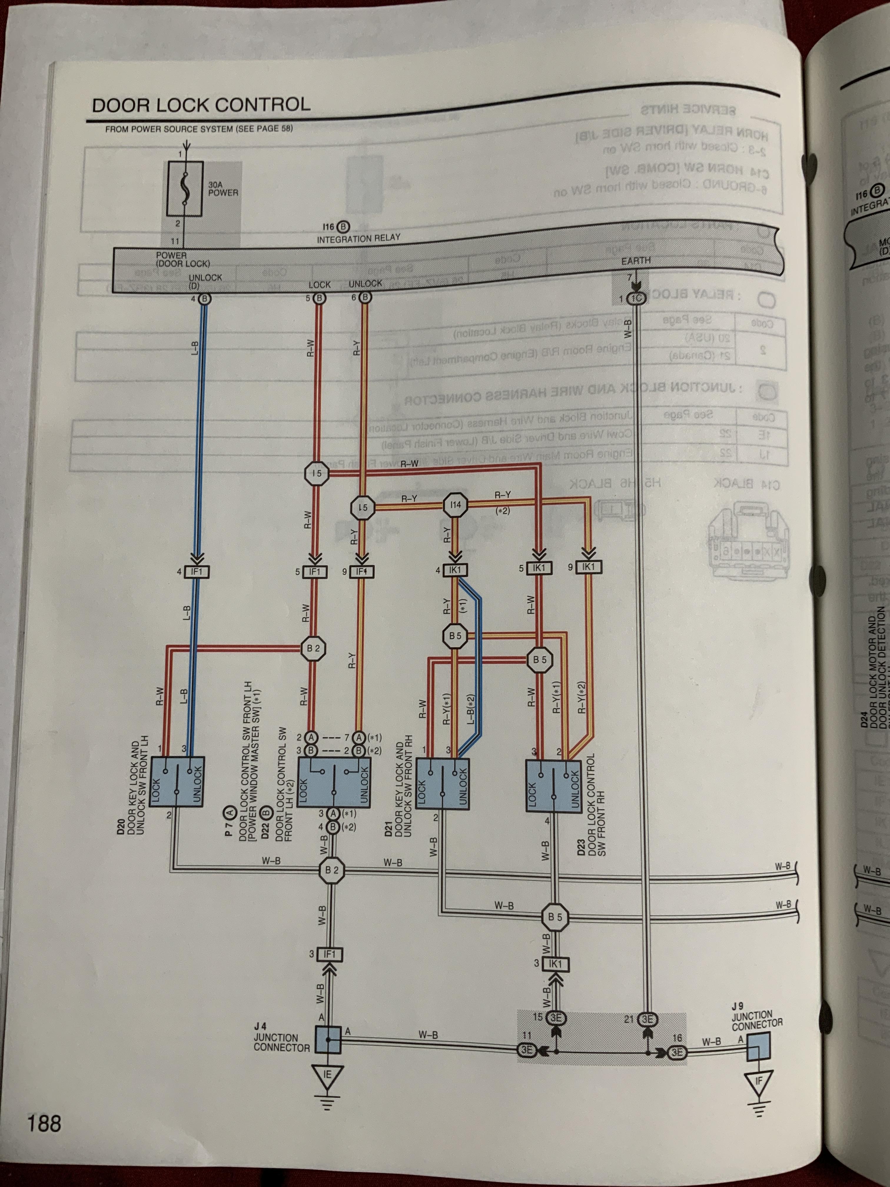

Wow, didnt realize that was a change. What about the door lock? What have other done when doing this swap?
