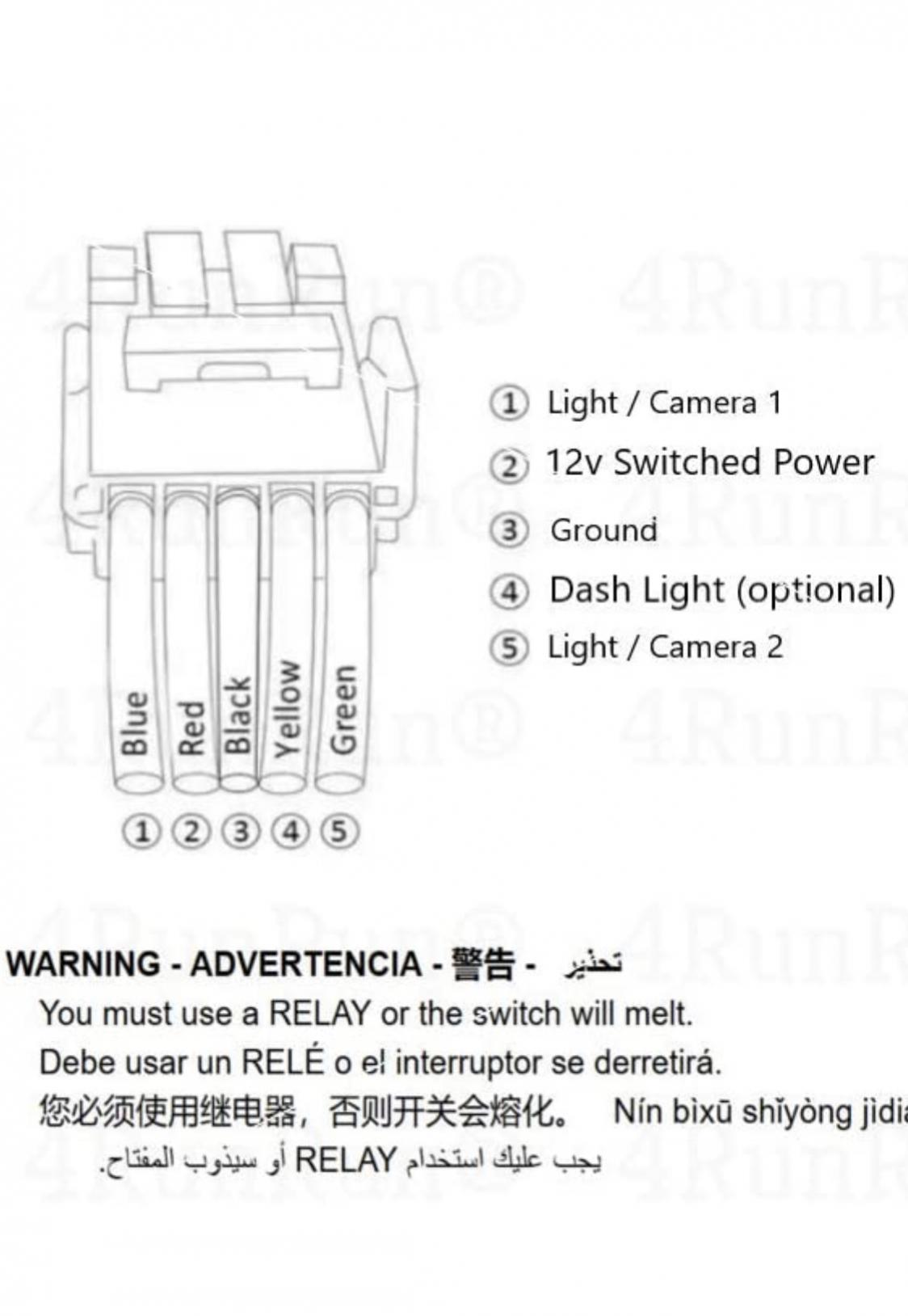

Hoping to get some help with wiring a new switch I'm looking to install for a dual LED bar.
I have the RIGID dual light bar, used their wiring harness. It came with two independent switches and I'm looking to install this switch. Amazon.com: Dual LED Switch Light Bar and Ditch Lights for Newer Toyota Vehicles 32mm : Automotive
Lightbar, something like this - Rigid Industries Radiance+ 20" Amber Backlight Black Housing | w/ Free Shipping and Handling
Looking for guideance with installation.. shouldn't take too long if you know what your doing.
Assuming the harness has relays…
From the Amazon link:
Power from the light bars should go to #1 and #5. #2 can go to a key powered fuse (add a fuse) I don’t remember which ones off the top of my head but a multimeter would be helpful here. #3 ground, pretty self explanatory. #4 (optional) tap to a another switch that lights up when you turn on your headlights
Hope this helps
