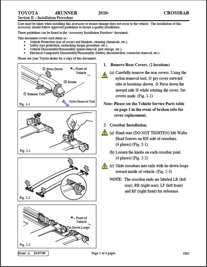

Yep I'll snap a picture tonight. I have approximately 3 or 4mm up and down movement so it rattles pretty loud. Source is passenger rear contact to the rails.
Attached shows the two torx screws fully tightened along with the positioning knob

it's because it's not perfectly square, try to move each side forward and back and adjust them to be square
i had the same problem on my front cross bar that was causing a squeak that was hard too diagnose
This sounds like it could be the cause.
The shortest distance between two points is a straight line. If your crossbar is not at a 90* angle, it's essentially sitting diagonal, which is a further distance, thus causing the crossbar to be unable to snug up.
