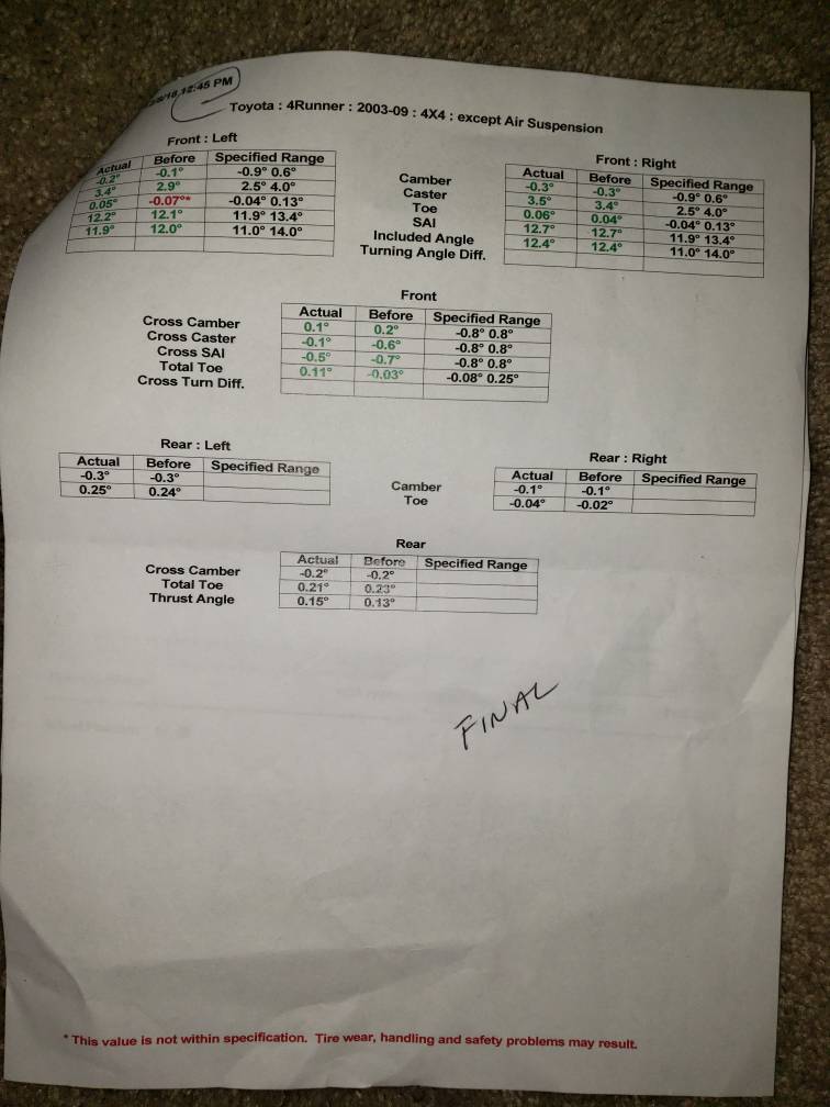

Toyota rebalanced the tires and redid the alignment. Guess what? 75% of the “darty” nature of the 4Runner at highway speeds is gone. There is still is about an 2inches of dead zone in the steering wheel at high speeds (as in, I can move it back and forth and the vehicles doesnt do much) but it feels substantially better
Do you mind posting the alignment specs (before & after)? I'm just curious.
I find the steering a bit numb in the 4th gen especially in terms of on-center feel. Adding a bit of caster (up to the limit of factory spec) can help but still doesn't make it as sharp as I like. That said, glad you found a cure.
Unfortunately I never received them. Sorry
Sent from my SM-N950U1 using Tapatalk
You have to ask for the specs, otherwise they don't normally provide them to a customer, but most all alignment shops and dealerships will give them to you upon request especially if you ask in advance.

4. I took it back to have it re-aligned. That dramatically improved the highway manners. My final alignment specifications are attached.
I still have maybe 1 in of dead space in steering wheel.
I am thinking steering rack bushings but the mechanic says they aren't needed.
