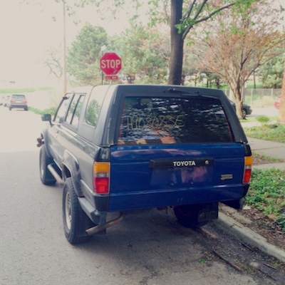

Anyway, I needed a new tailgate as the old one was really rusted out, so I just went ahead and replaced the whole thing (pic below). It works great, though it makes a knock sound on the way down. I'll have to investigate that soon.
