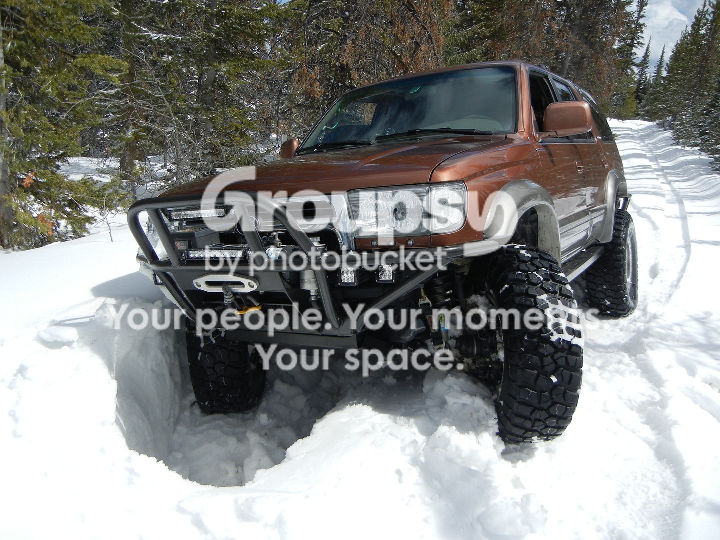

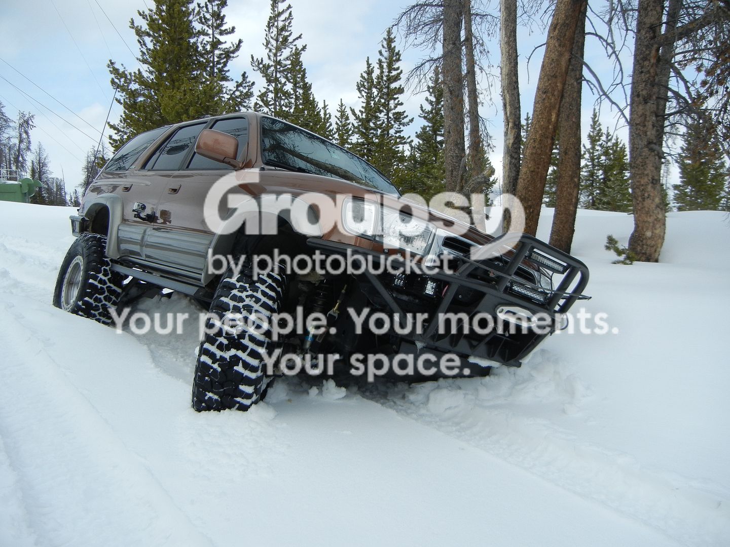

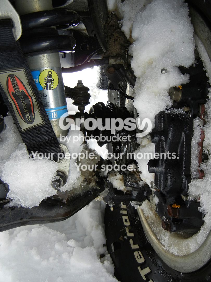

I was snow wheeling on top of about 5-6' of snow, it was wet and heavy spring snow with a lot of good traction. The tires were aired down to around 2 psi to stay on top of the snow (the lowest I've gone to date). I fell off my tracks towards the driver side of the 4Runner and dropped to my bumper/headlight (it happened multiple times this trip). I engaged the front locker and turned the wheels hard to the passenger side (pretty much maxed out), it started crawling out of the hole and then I heard something break, and the driver side tire stopped spinning.
Here is where it broke

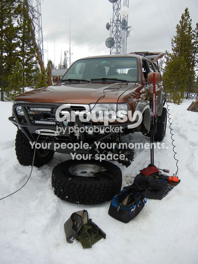

And this is what the conditions were like all day. I drove out of this hole without an issue.

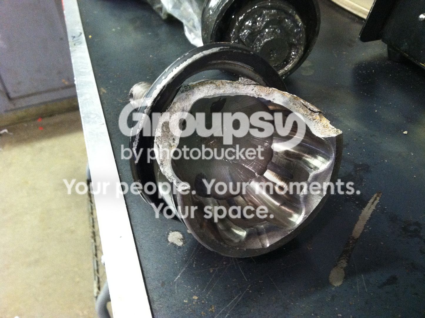

Carnage!

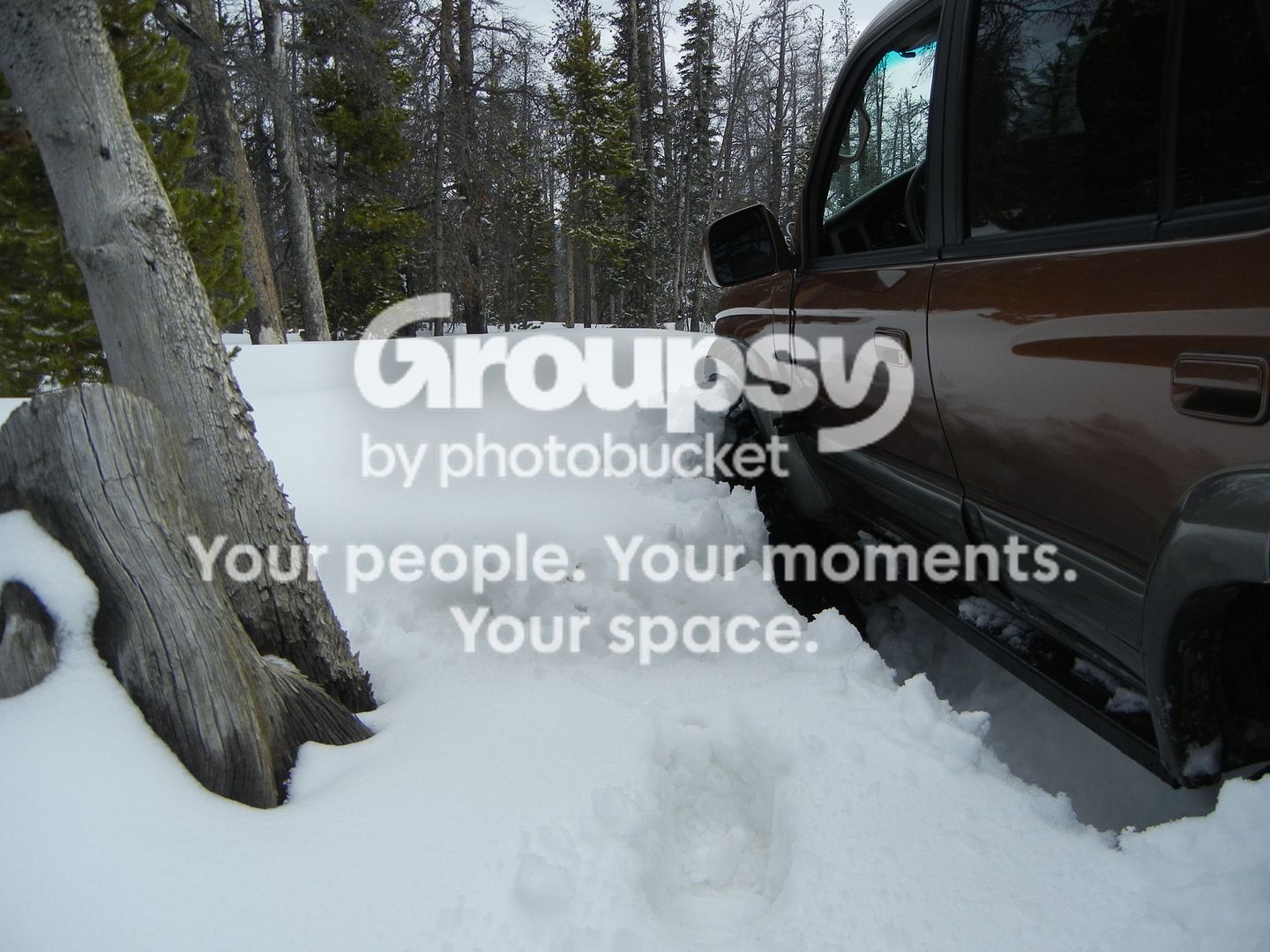

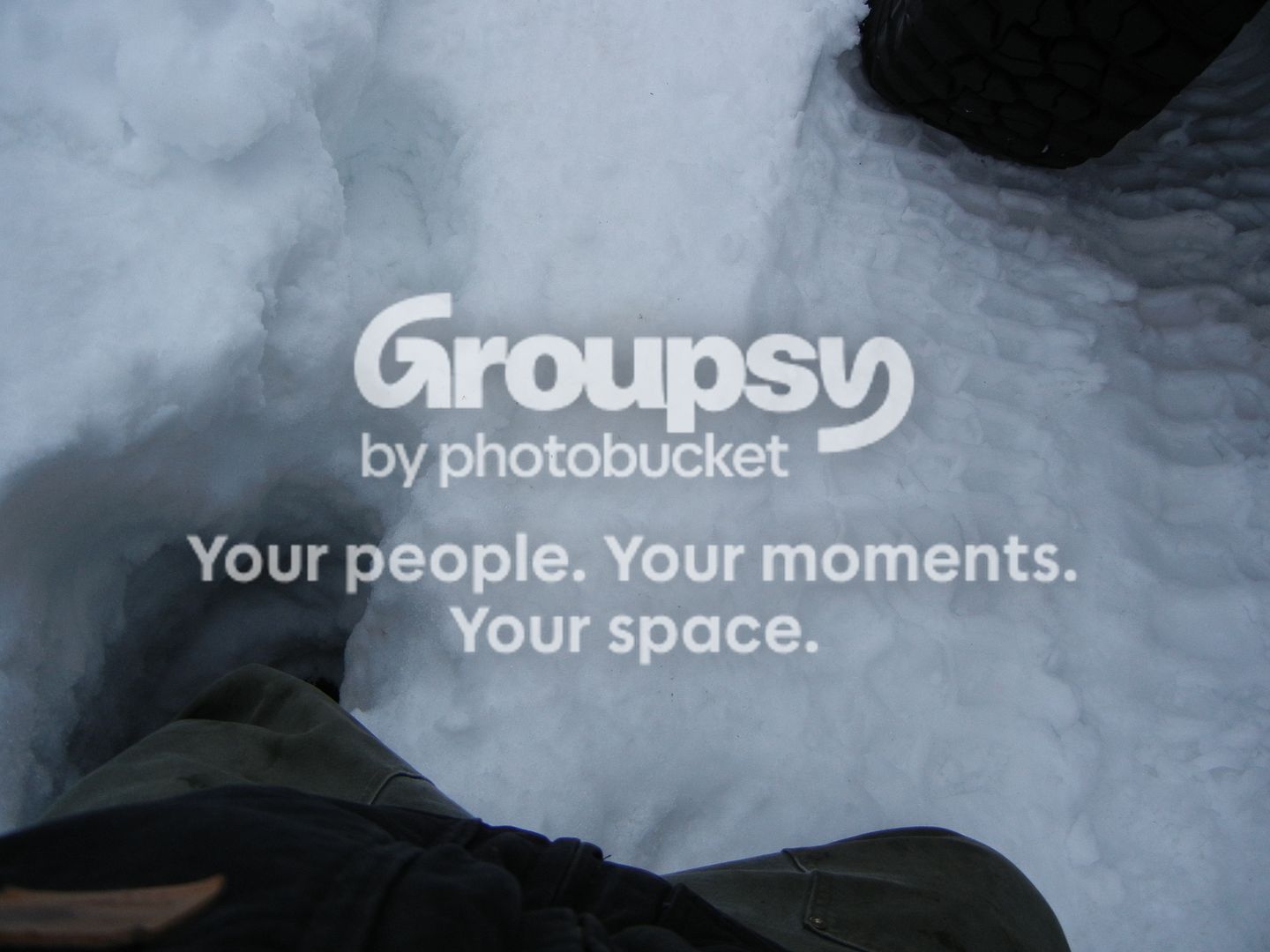

Yeah, the main trail was packed down from me going up there several other times this season, and from a snow cat going up there to service the radio/cell tower that is behind me in the above picture. Once you got off the packed trail it was a good 5' deep, I fell up to my waist several times carrying parts back and forth. I was about ten miles in, so I didn't have a choice to fix it.

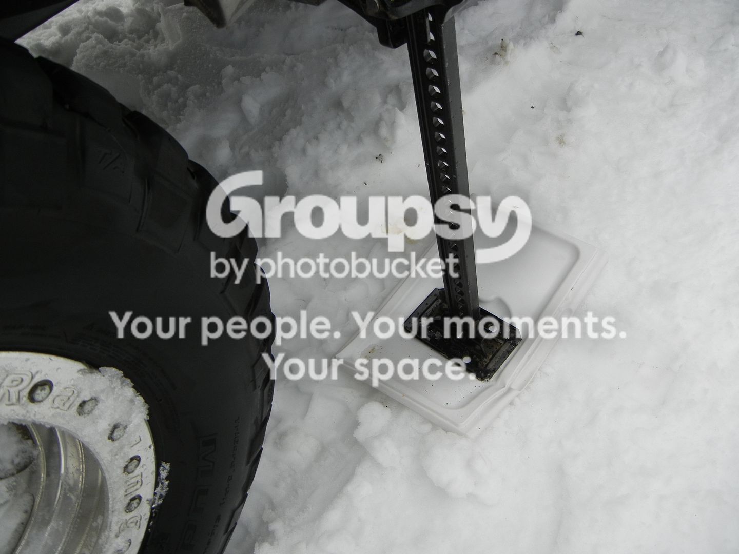

As for the Hi-Lift, I sacrificed my cooler lid for the greater good! :D There needed to be something to keep it sinking, and that was the first thing that came to me. By the time I finished changing it out the 4Runner had sank a good 6" or so, it was not the most comfortable situation.

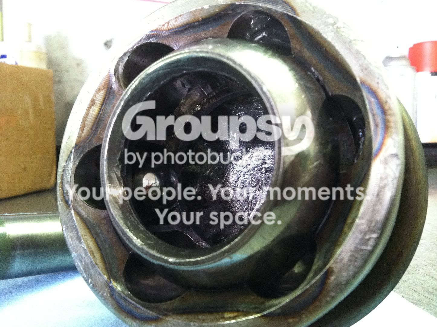

It happened on the second obstacle of Wheeler lake, left fork, right line. I slipped off my line and fell into the largest hole on the right side, I tried to drive out of it and turned hard to the driver side. The front was locked, turned hard driver, and the 4Runner was leaned way over on that passenger side (look at the trees in the background). Watching the video you can hear a small snap, then the sound grinding metal as the 4Runner tries to climb the ledge with the passenger side outer CV joint broken. For reference I do have front limit straps and less droop than most people.

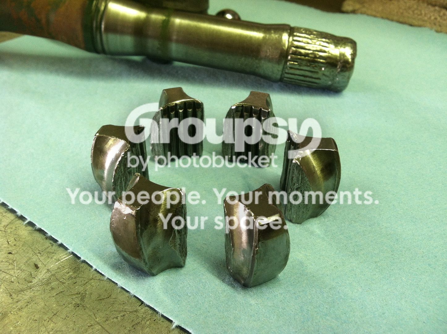

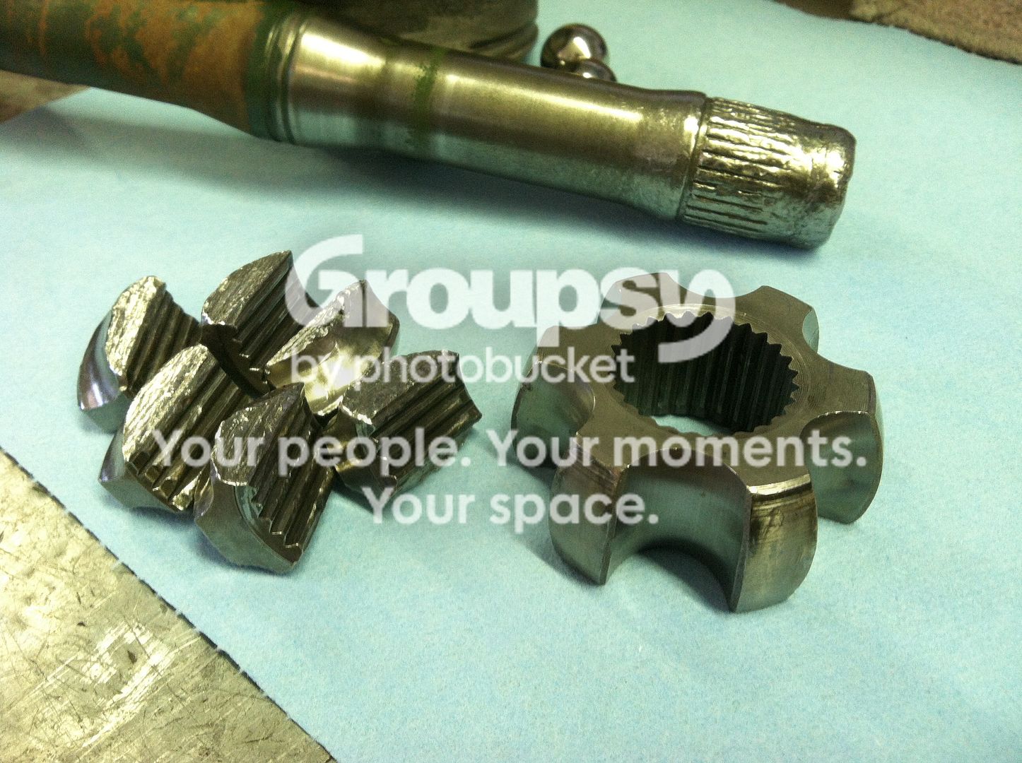

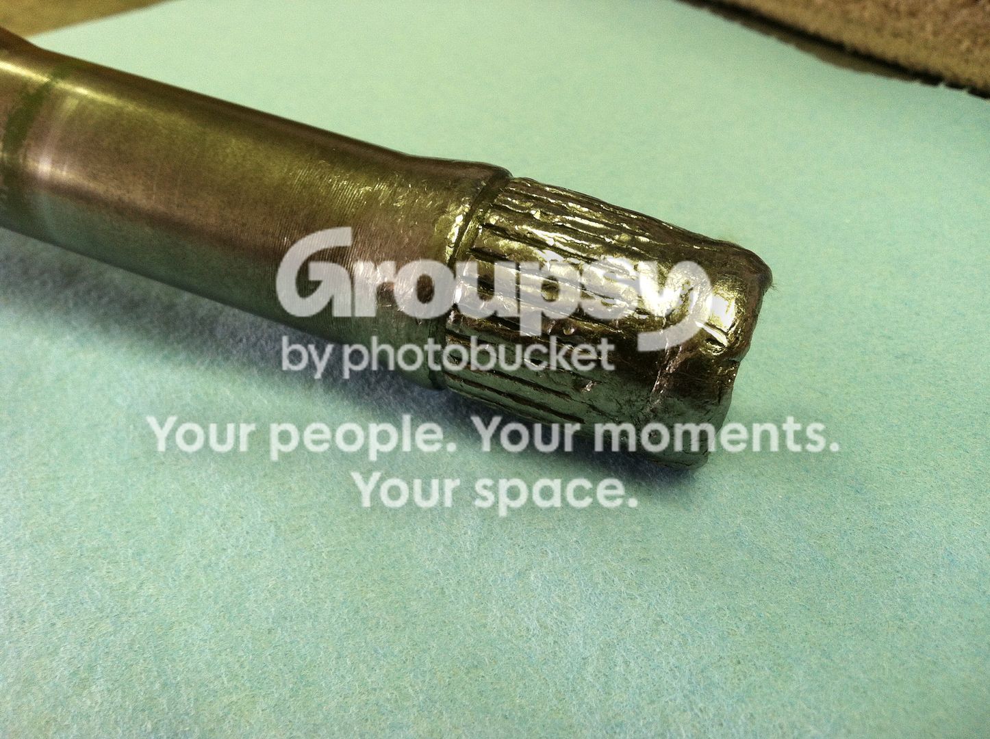

I tore into it and found that the inner star inside the outer joint is what broke, the outer cage is still intact but beat up from all the broken parts. The splines are shot on the axle bar, that's the grinding sound you could hear in the video.
There's no doubt these are much stronger than stock, and Glen has been great to deal with, top notch!
The broken star
Next to a good one for reference
Cage

Thanks for the update jeremiah and jeff. So with the failures, it has never been the cage correct? One race and one cup.
Any chance that because of having to make the race slightly smaller to be able to accommodate for the larger cage, that the weak link might be the race now instead of the cage? Also it seems strange that it would have completely broken apart like that instead of just cracked in half.
I'll let Glen chime in on the details but yes, one race and one cup.
I drove on the broken CV for a little while on the trail, so it's possible that it broke in half, but then got caught up in the cage and broke the rest of the way. Judging by the sound I thought the ring and pinion broke, so I kept driving up the trail a little ways while diagnosing what was going on. Being that the break was inside the cage, the axle was just spinning on the boot and it looked fine from the outside.
Ya that makes sense that it would potentially have gotten worse as you drove on it.
