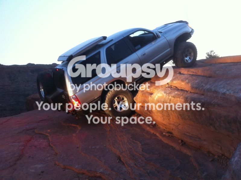

I watched these axles in action again this weekend. Going up 4' steps, endless slick rock climbs, loose rock, Four days of serious rock crawling without an issue. Not to mention the highway miles to and from the trails.
IMG_1723.jpg~original
