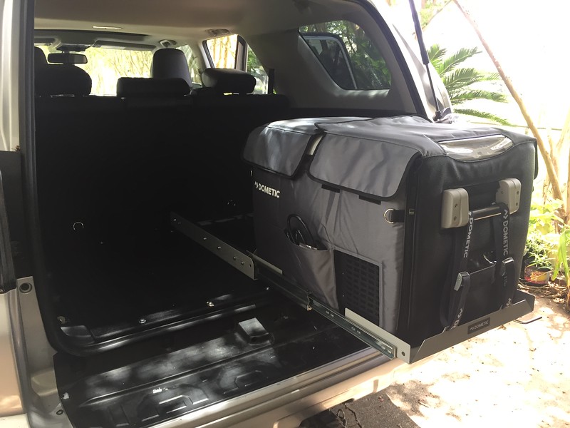

Dometic Fridge Install

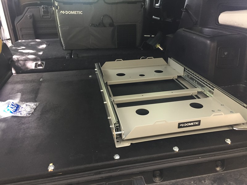

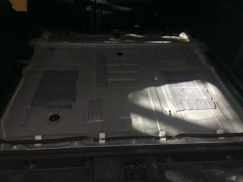

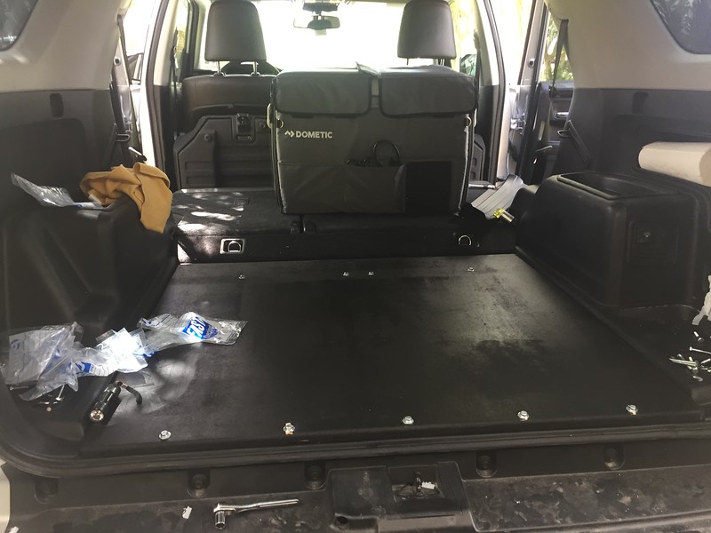

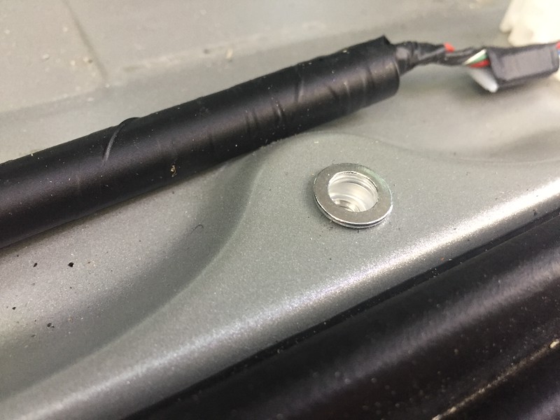

I picked up a Dometic fridge here on the group buy. I am still waiting for an Odyssey Grp34 battery to arrive for final wiring termination, but the fridge and slide are in the T4R. I opted to make my own "goose gear" type floor with a 3/4" birch plywood. I bought the ARB fridge wiring kit that came with a fused lead and a receptacle. The receptacle is mounted at the front side of the wheel well panel. Domestic's power cord has a cigarette lighter type plug that can be taken apart at the threads and then what's left threads into the ARM receptacle. Added insurance against coming unplugged on the trail. So out came the carpet....
If you look close, you can see I enlarged the fastener holes slightly to accept a threaded riv-nut. I picked up the tool at Harbor Freight and it came with ten of the correct size. Here is a closer look.
Here I have the plywood installed. I painted it with roll in bedliner and that worked out okay. Ill need to touch up around the bolt holes where the veneer split some.

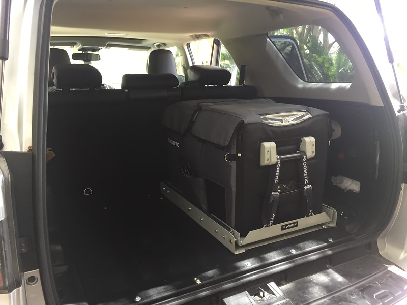

I used 1/4" Lag Bolts to attach the slide to the new floor. There was one location where a bolt used to attach the floor to a riv-nut was interfering with the slide sitting flat so I drilled an extra hole in the slide and bolted through the slide and floor to the riv-nut below. It was a minor pain, but in reality adds some strength to the entire attachment.
And the finished set up.

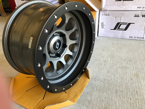

She got new wheels this week. I did the “nose job” on the front facia last week. I was pretty conservative with the cuts but it still looks much more aggressive. The wheels are 17x9” SCS Ray10s. The backspace is 3.5” and -38 offset. These are new for SCS, as this size was previously only available in their F5. Its like running their 8.5” Ray 10 with a 1.3” spacer. Im scheduled with Southern Style Offroad for a body mount chop next week. The tires are my same 285/70 BFG KO2s.

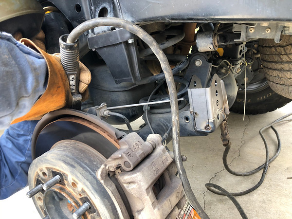

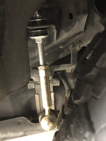

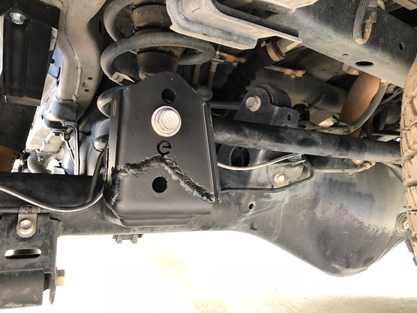

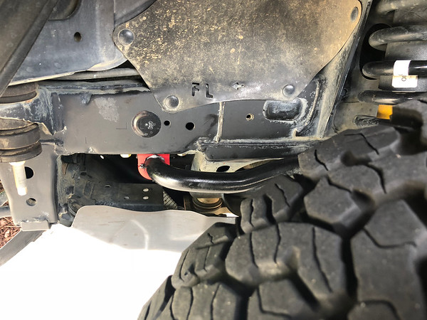

I have been doing some improvements lately on my suspension and the end result is much improved manners on the road and hopefully a little freer articulation Offroad.
-urethane sway bar bushings front and rear
-durobump bumpstops
-Dobinsons adjustable rear sway bar links
-Eimkeith Panhard correction kit.
The rig drives perfect!
