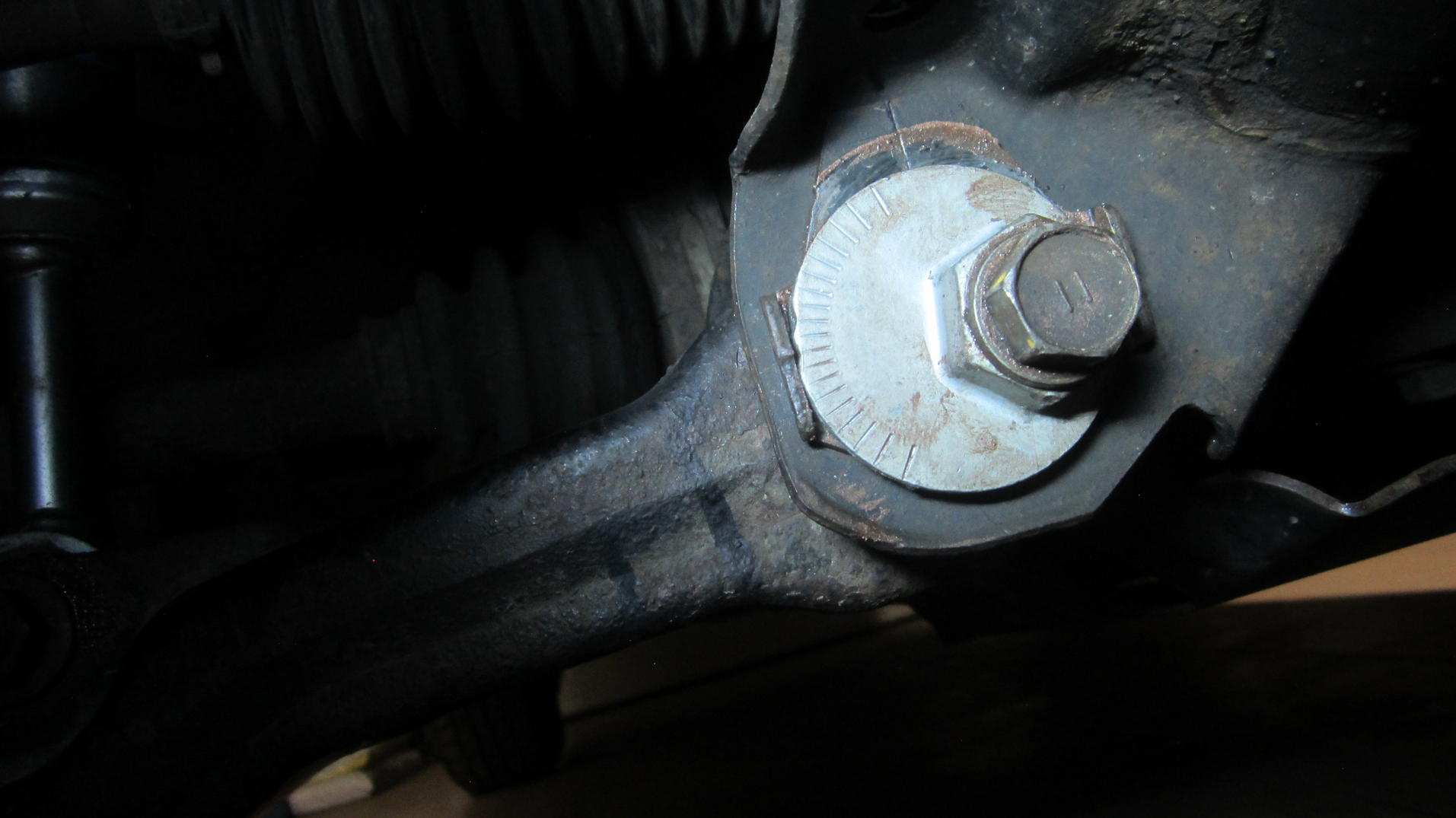

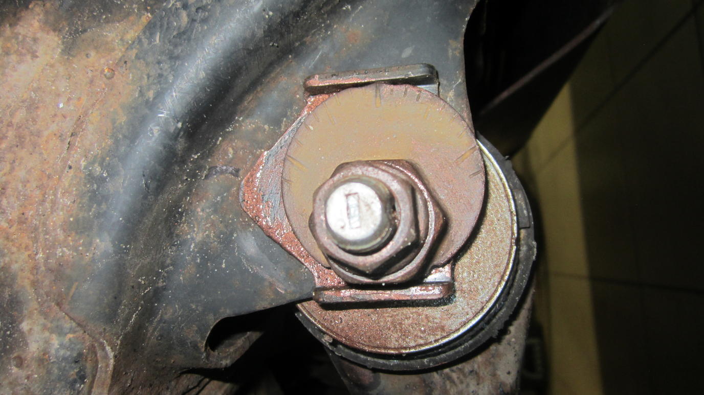

I turned all as the repair manual instructed and was pretty close to the specs. The the mechanic in the alignment shop tried to adjust the camber and caster to the center values and ended up with:
  • Caster
    3°16 both
  • Camber
    0°24 left, 0°26 right
These values are much better now, but to set it, the cams (one front, one rear) where turned "out of the range" (more then max 10 markers on the cams). Is it OK?
Attaching pictures. Is this correct for cams to be out of range?

Should be fine..
The cam bolts can be in any orientation (rotationally speaking). The compressive load from the torque of the thru-bolt is what keeps them in place. Caster adjustment is likely maxed out, which is typical when trying to get alignment into spec after a lift with OEM control arms (upper and lower).
If you were to go any higher on the lift, you will lose caster angle and not be able to get it back without switching to an aftermarket UCA.
