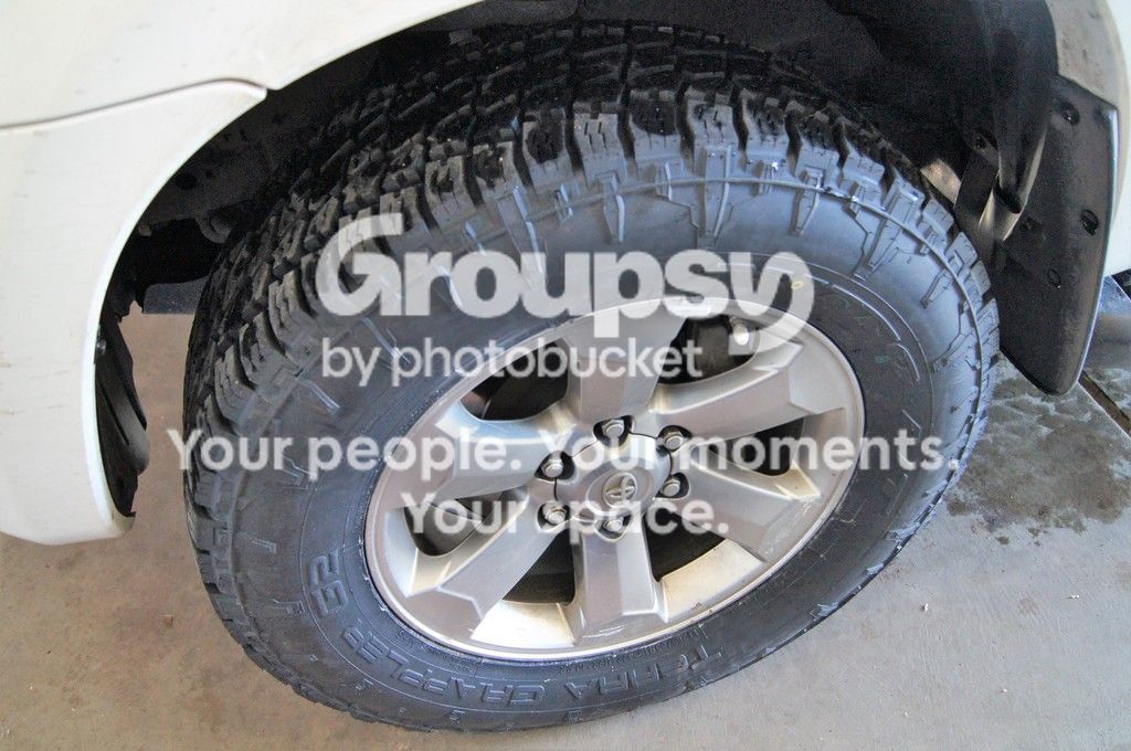

  • 265/65-18 Terra Grappler G2’s x 5 (man…I have no miles on this setup yet and I am so glad I didn’t succumb to a panzy-azz “comfort” mind-set. E-rated 10-ply all-day long, definitely a smart move and I haven’t even started yet but this was clearly the right choice)

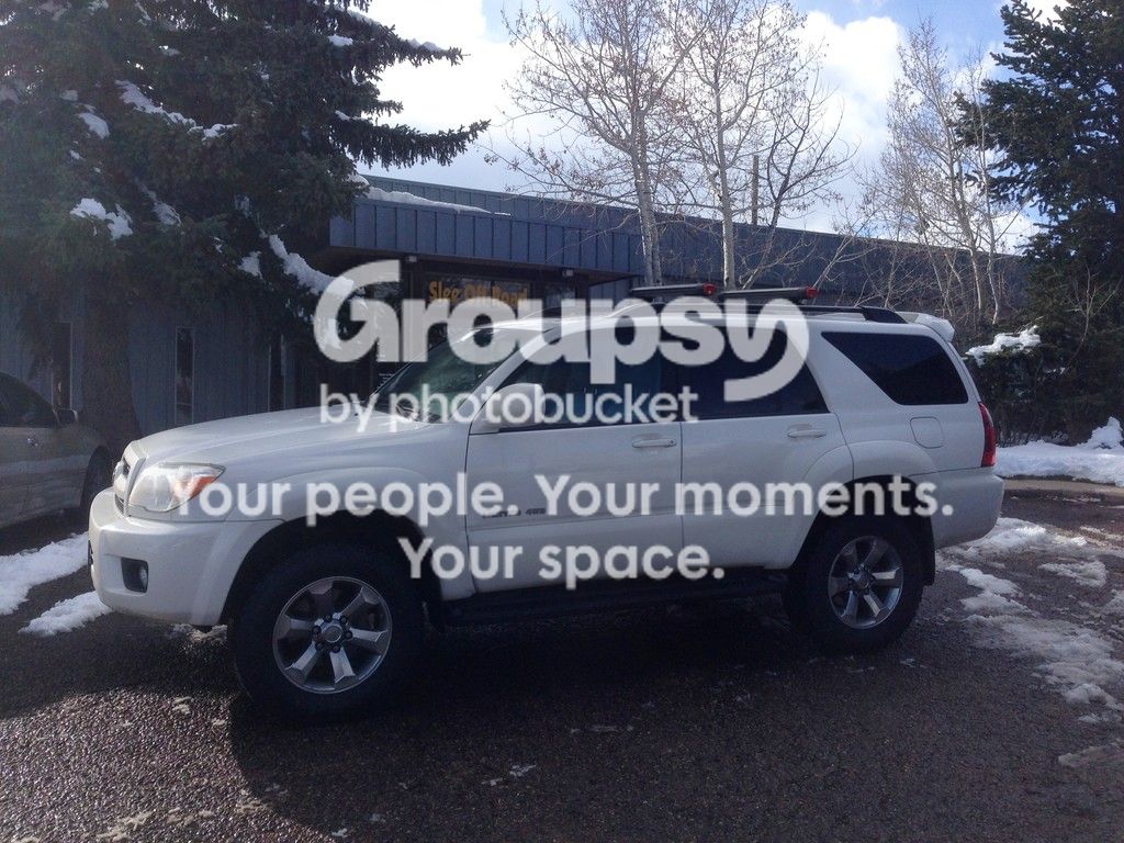

Obligatory pics (dirty, we had a blizzard yesterday, will put up some “pretty, staged crap later.”
Crappy cell phone pic:

Rubbing/mods? With spacers, I don't know but doubtful. Without spacers there is plenty of clearance under load and in various trail conditions with a ~31.5" X 10.5" tire on a 7.5" stock wheel/offset when paired with a well engineered suspension (spring rates, vehicle weight w/ accessories, etc.). I run OEM Limited 18" wheels that have a slightly different offset than a stock 17" (I think 25 vs 30 so I'm tad more outboard, 5mm) and 265/65-18 AT's (same tire measurements), works well for basic off-roading (trout streams, camp sites, trail heads). If your hammerin' hard-core or planning to...different conversation and suspension requirements altogether.
