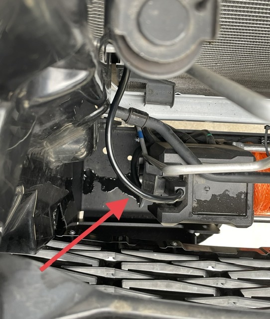

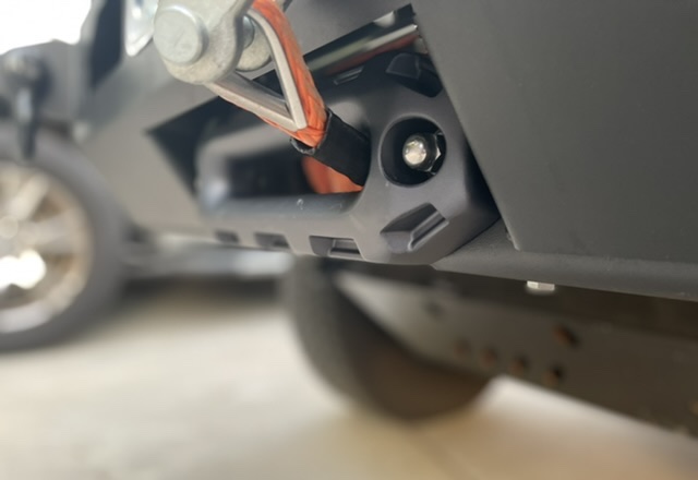

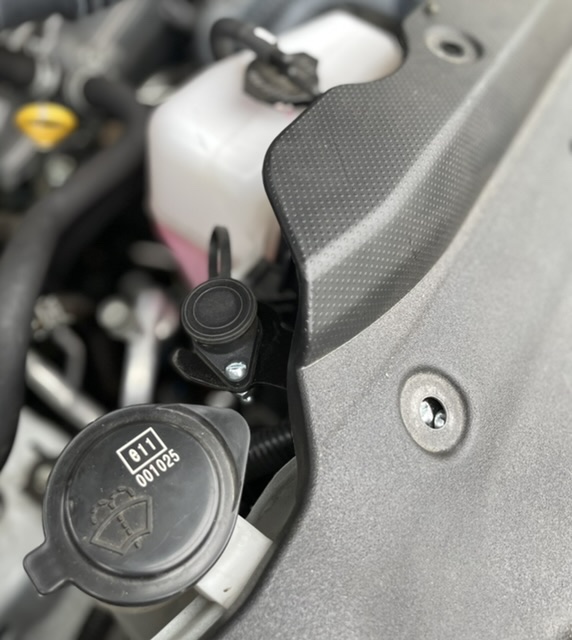

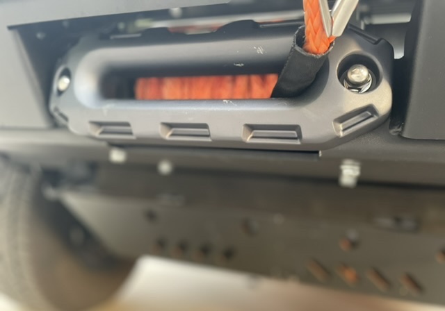

The Warn bumper came with a winch remote extension, to prevent the user from having to cut the radiator cover and reach all the way down to the winch. Pretty cool!
Examples provided showed it installed on the bottom of the bumper cover. #nope

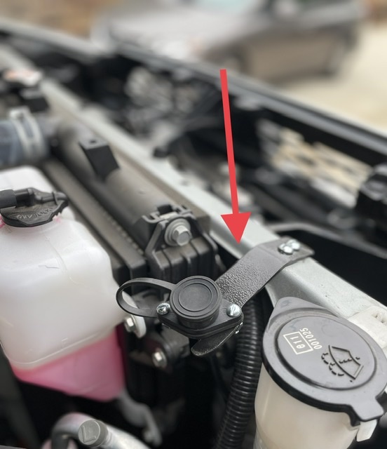

I scratched my head for a minute and ended up making this simple, custom bracket to keep the whole setup hidden/protected, but available when the hood was popped for winching.
(You can also connect the remote and close the hood on the first click if we absolutely need to see forward while we’re winching.)

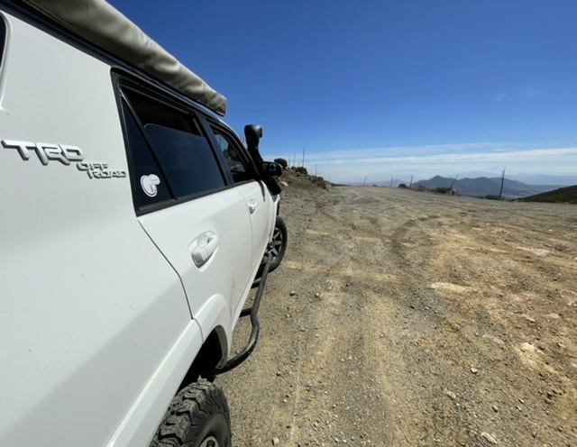

First of all, thanks for the compliment.
Second of all, unfortunately, the double-sided tape was a big fat fail.
My wife and I just got done DE-installing the tape and snorkel. We then we measured, drilled holes and then re-installed with the stock bracket. Solid as a rock.
Glad we tried it though. It was a heavy duty, white foam tape, that popped of a few days later allowing the snorkel to vibrate against the a-pillar…so maybe a thicker, stronger adhesive tape would work?

Thanks for the follow up ! So you ended up drilling the pillar?
Yes, we did. ARB instructions are top notch overall, in my experience, and their notes were spot on, OTHER than the fact that my step drill bit happened to allow me to drill a 7.67mm hole vs. an 8mm hole and the "snug-ness" of the nylon screw inserts was perfect, at that slightly smaller diameter.

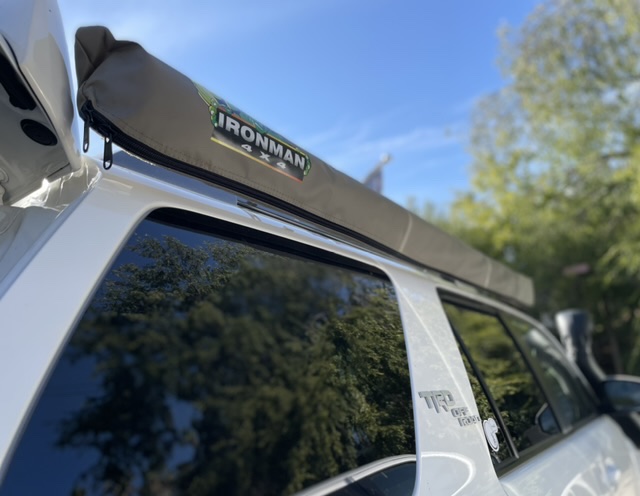

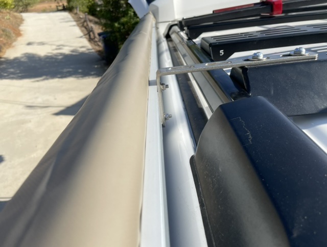

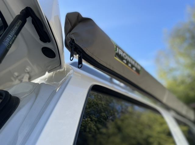

Installed our new ironman awning on our new LFD crossbars. Very easy install using LFD awning mounts. (Could have used the supplied ironman awning brackets. They’re very nice, but i didnt know they were included…D’oh!)

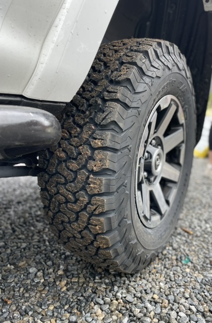

New shoes:
