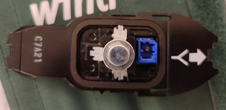

i actually bought a complete second antenna to play around with. the tabs that lock the painted fin down take some work when off the truck to remove properly. the inner white fin is screwed on.. there is also a rubber gasket that is between the white fin and the painted fin that seals around the entire base of the antenna. this looks to be removed. so now all you have is a foam piece around the bolt/wire that goes through the roof. removing it the way GFC did it might compromise the foam gasket.
when i remove my antenna to put this on, i would actually put a secondary gasket under the whole antenna to be safe.
I think that's a good idea. If the gasket from the outer shell/white fin is removed, I'd consider putting some butyl rubber tape around the edge of the base as it goes back in.

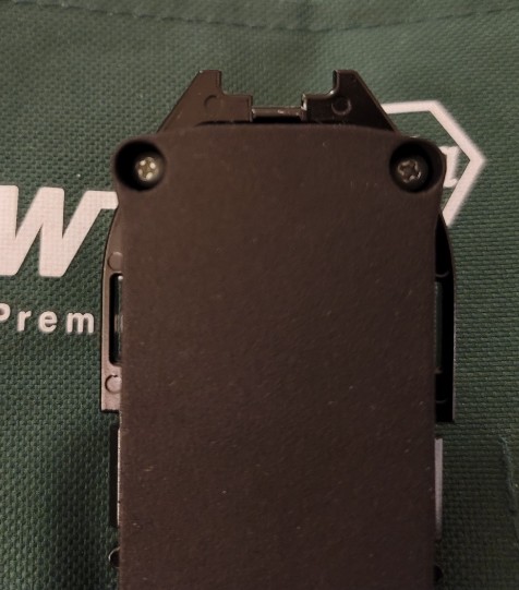

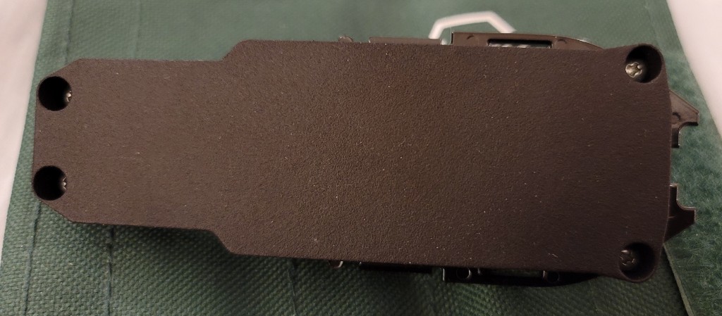

A bit disappointed with how it covers the antenna. They could have atleast match the outline of the antenna.
Yeah it does seem a bit haphazard. Did it snap into place as advertised? And was it easy to remove the outer shell once you took it off of the roof?
i actually had a second antenna around that i was modifying the sharkfin. debating if i want to install this.. the sharkfin cover definitely cannot be removed with it still on the roof, so easy way is to cut it off..
Got it. I'll probably remove the antenna first, just in case I decide to go backwards too.
I did it quickly this morning. Pulled the headliner down, used both a box end and socket 10mm to disconnect (not a lot of room for hands).
I see what you mean about the seals. I like that the new piece sandwiches the existing upper rubber seal to protect the PCB/antenna. It also retains the inner seal on the metal antenna body that goes around the hole in the roof. However, the white piece/outer shell that is removed takes away the outermost, secondary seal against the outside roof. I imagine that the inner seal is quite waterproof, but the outer seal probably works to keep the majority of dust and grime away from the inner joint. There's not much of an area to add butyl or silicone. Maybe I'll add a fillet/bead around the edge. I'm also concerned that the screws are now exposed to the elements, as they could be a passageway for leaks or corrosion to the PCB.
