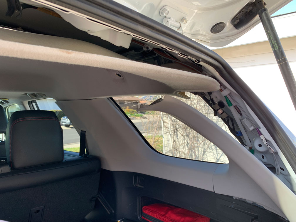

Steps:
1) Remove the three headliner clips along top rear of headliner near tail gate.
2) Loosen and partially remove the two rear pillar trim pieces.
3) Remove the coat hooks on either side of headliner in rear cargo area.
4) Gently drop down the headliner, being careful not to crease headliner.
5) Unclip satellite antenna now exposed beneath the headliner.
6) Use a 22mm socket to loosen and remove nut holding shark fin to truck roof.
7) Lift out the unattached shark fin from top of roof (outside of roof).
8) Mine had blue square connector. Replacement flat Camry antenna has very similar gray square connector, but not a perfect match. See photo. That tiny difference prevents you from being able to connect the Camry antenna to the 4runner wire. So just swap the connectors.
9) Swap connectors. Very easy to do. Gently pry up white plastic piece from top, removing completely. Then slide tiny flathead screwdriver into square boxy piece and lift tongue. With tongue lifted, slide wire out of it, being careful not to slash finger/thumb on metal blades. (I did. It bled. A lot. And hurt.)
10) Follow same procedure and reverse it to move blue square connector to the new replacement flat Camry antenna.
11) Install on roof by threading through and tightening 22mm threaded hex nut up against roof.
12) Insert blue square connector into wire beneath headliner.
13) Gently push headliner back into place.
14) Reattach coat hooks and rear pillar trim pieces.
15) Enjoy a working satellite reception for first time in years.

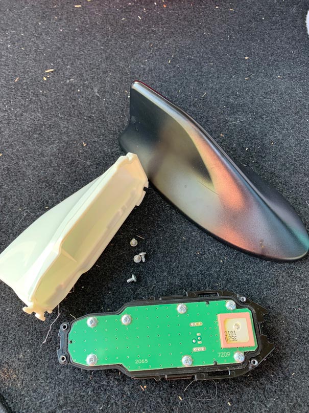

SiriusXM lost signal a couple weeks ago & have tried the signal refresh/etc route with the company. They said likely hardware problem. Read this thread and today took apart the rear headliner on my 2018 TRDORP to get the shark fin off. That was NOT fun. Worse, the bolt assembly to reattach that sucker is a complicated 4-piece job. Lord knows how I'm going to get it back together.
Took apart the shark fin and saw no evidence of corrosion or damage--most sadly, as that means that I may still be looking for the problem. For the record,
2018 TRDORP has just one chip inside it. No metal fin for FM, no GPS. Well, assuming that the chip inside the thing is the satellite radio chip!! The fin itself is just empty. WTF, Toyota???
Now that I've gotten it apart, I figure I might as well try to make the swap down to a lower profile satellite antenna to plan for any future roof rack or cargo box. Anyone have info on replacements for 2018(ish) models? Even better if using the connector shown.

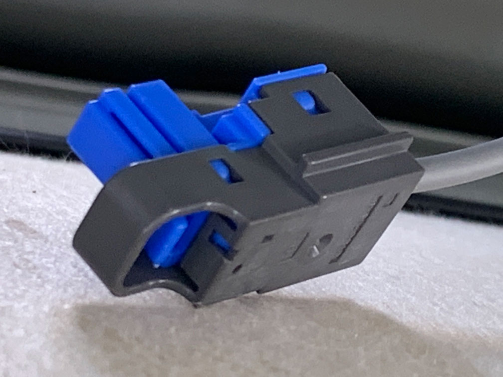

Awesome write up, just a note to those attempting this. Remove your antenna to find out what connectors you have. I didn't and ended up having to remove the connector from the old antenna and connecting it to the new one that I bought. It was not too hard but I might have been able to just buy one that is a direct connection. (I have a 2010 SR5, so the extra stuff in the antenna was not connected to any wires in the car)
See the attached pictures for some explanation, I was too lazy to cut and completely re-crimp the adapter so I just soldered the wire in the middle to the old middle adapter.
But it worked, hopefully my haphazard job holds up.

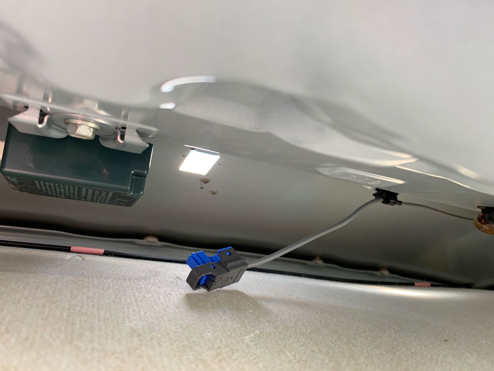

Ooops, I didn't see this post before ordering my part. I have a 2011 SR5 and my connector also isn't square like others show in the pictures, mine is round like yours.
I already purchased the low profile antenna for the 2010-2011 camry in my color match.
Will I be able to remove this adapter and put it on the one for the Camry? Or can I just swap the inner parts and leave connector on after soldering to new board?
I need ideas. Below are pictures of the original, then the white connector is the camry replacement. Blue round one is what came in my 2011 SR5.
Is there a connector that is made to where I can straight from the white connector into the blue connector on my vehicle without cutting and splicing cable?
