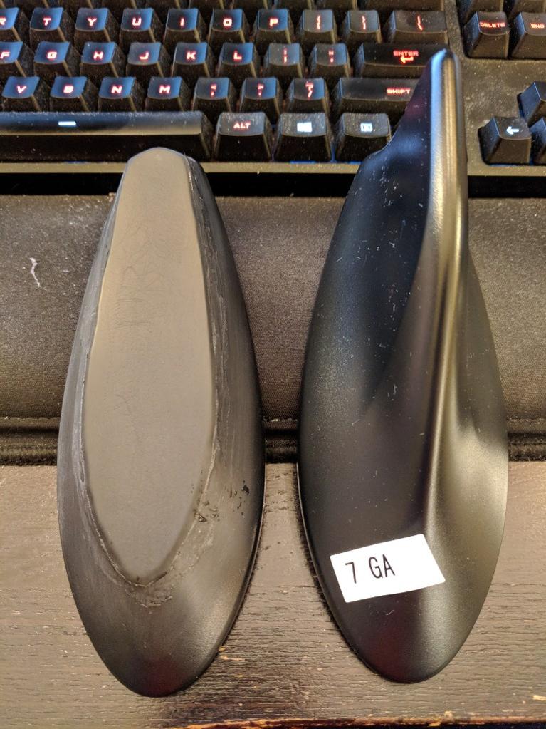

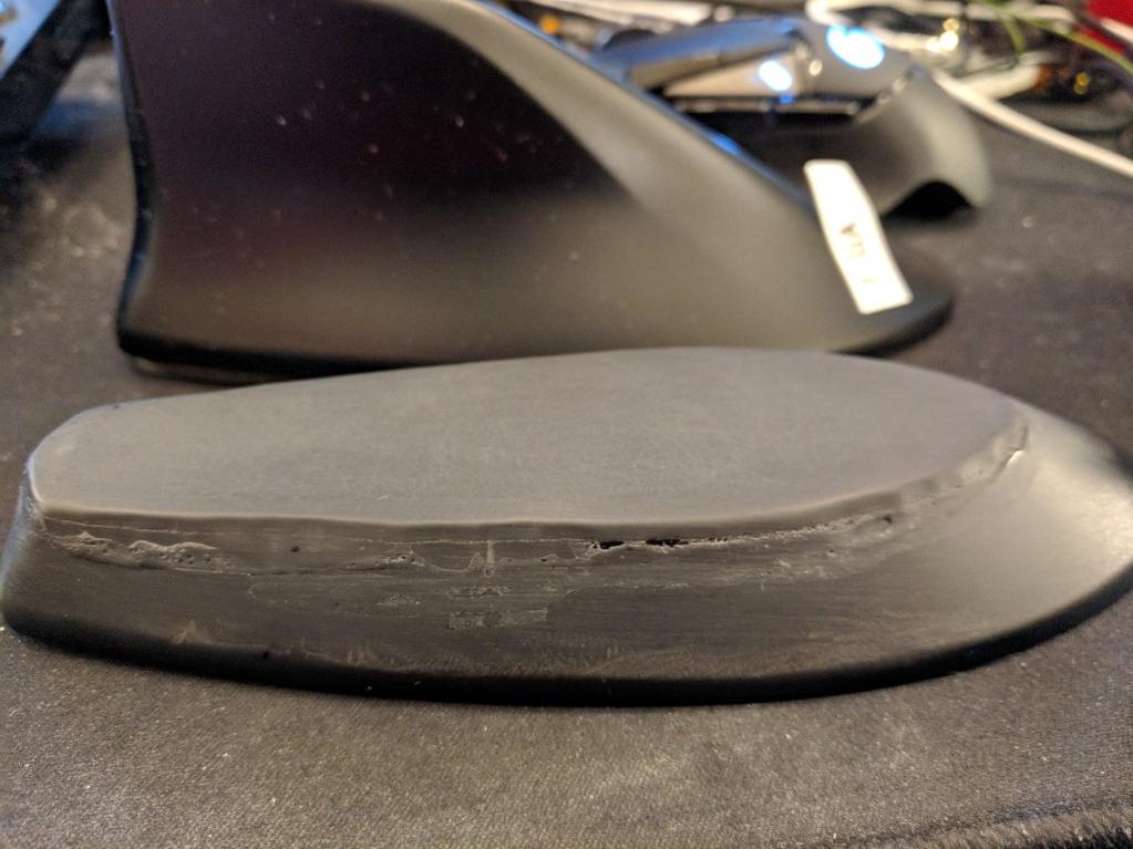

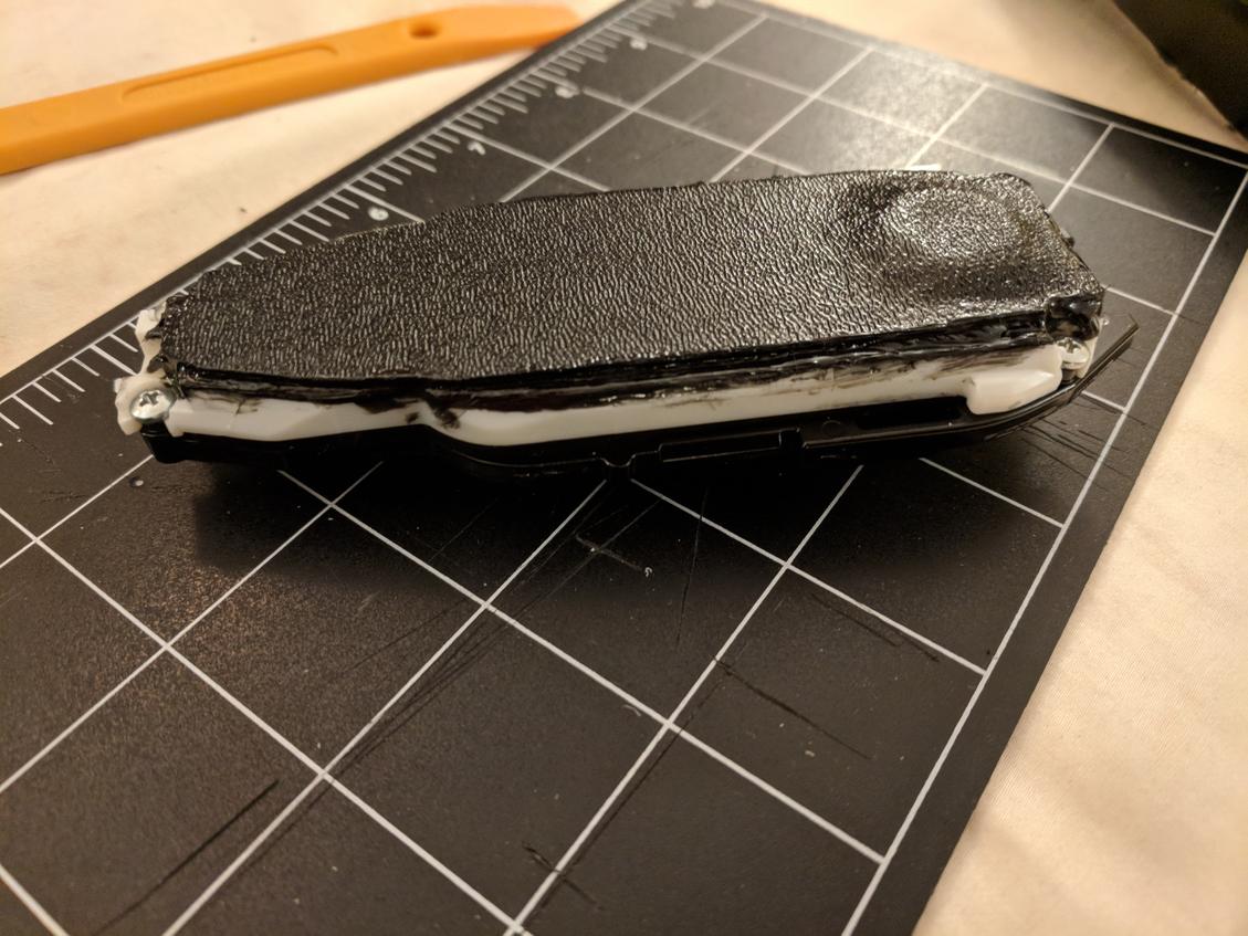

got my ebay antenna, going to start chopping this down. 37 bucks for complete assembly.. thats as cheap as it'll get.. ever
Chopped up inner white shell. Used a thin piece of abs and abs cement. This is 100% removable

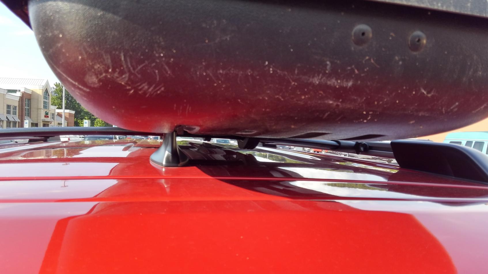

I have a 2018 OR and am wondering, has anyone pried the fin off without removing it from the roof? I want to do the chop for clearance and was checking.
And, why did Toyota do something this stupid. It sticks up at least an inch higher than my roof rack. Luckily my Yakima box has grooves and I can barely get it to miss. But, this makes the roof box about 6 inches farther over on the rack and harder to get stuff in it.
And, thanks for all the info on here :-)
Stephen
PS - sorry for the bad pic - the antenna barely cleared in the groove.
