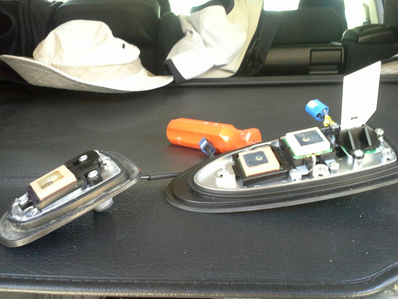

Sorry for suck pic but this was what was inside mine ! Which don't I need ? :noidea:
Do you have a limited?
EDIT: Nvm, looks like you have a 2011 SR5. I have a 2014, so unfortunately I can't be much help. I'm thinking one of those is a GPS chip. [MENTION=92800]mdogg[/MENTION] can you assist?
No sir 11' sr5 but had the trim pkg . I just left it unplugged so far ok . Bought used think guy before had xm & other stuff but I don't need fine using the bluetooth !

Unfortunately, I don't remember what was underneath my OEM one or what was underneath the 8696006030A1 replacement. I'll snap a pic of the OEM version later today to check it out. It will be a few hours, but I'll check it out.
It looks like [MENTION=78968]oljedi11950[/MENTION] bought 86960 02050 (instead of 86960 06030 like mine) - I'm not sure exactly what that part number is for. I remember when I was searching they had multiple versions - for Safety Connect (with/without) and either GPS or Satellite (with/without; perhaps even all combinations).

A little late, but as promised..... pictures of the electronics and connector from a 2013 Limited with JBL.

Based on the previous few photos it appears that the outer sharkfin design does actually have a purpose. Anybody know which antenna the thin fin shape one serves?
You should be good to go. For 2014-2015 models the extra space is cosmetic. 2010-2013 models there may be a slight issue with either the safety connect or the GPS, and the 2016+ (with the white plastic exterior) doesn't have an alternative yet.
