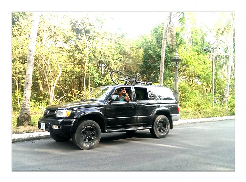

Hi,
I have my little babe a 3.4L limited stock editions...(for the moment)
She has around 130 000 miles.
I just notice that she start to have a really LOW RPM, around 500 or 600 in Drive and little more on Neutral. I changed it's sparks plus 1 months ago it was a Beats.
Little notice, I have a leak on the Valve gaskets, transmission gaskets and front differential seal leak as well. Is this can the problem of the performance lost?
Have anybody has this ?
Thanks
