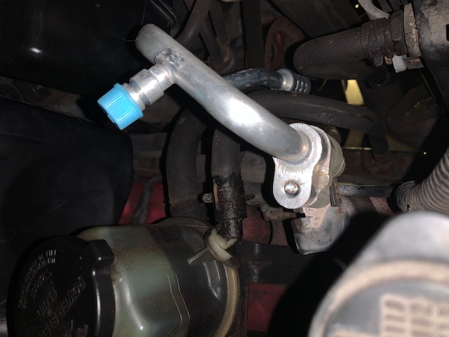

Anyone know the part number or what I can do to put this back on, I replaced both the lines and went to take this off and it just snapped right off...
you most likely won't be able to get that stud out with out replacing the line. If you do, hardware store with a decent bolt and nut selection should have the stud.
Pretty sure the stud is part of the bracket 88688-35670 and the nut is 90179-06293
Much appreciated good sir.
If the stud is indeed apart of the "bracket", the stud wasn't milled/made with the bracket and threads tapped to create the stud, the stud was added/screwed in or welded on after the bracket was milled, I don't see why it can't drill out and tap for another stud or just a bolt.
It wouldn't be that hard of a job to drill and tap it especially since it appears to be aluminum, that would be much cheaper than purchasing a new bracket.
Attempted to get the stud out and it was rusted through and didn’t budge, ended up bending the bracket so gonna have to just get the new bracket. Oh well one less rusted piece in the engine bay
