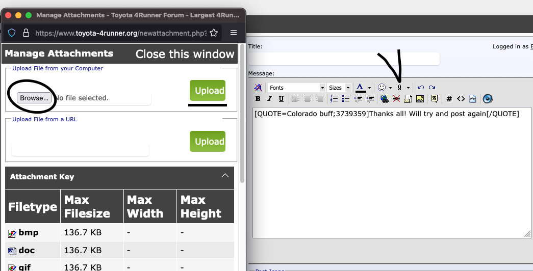

Here is a basic way to upload pix into your comment from a computer.
Click on the Paperclip icon, Browse to the file on your device, click Upload.
I have noticed that in some cases an image with a larger than about a 1400 pixel dimension in L or W will 'Fail' to upload. Sorry for the crappy graphic below.

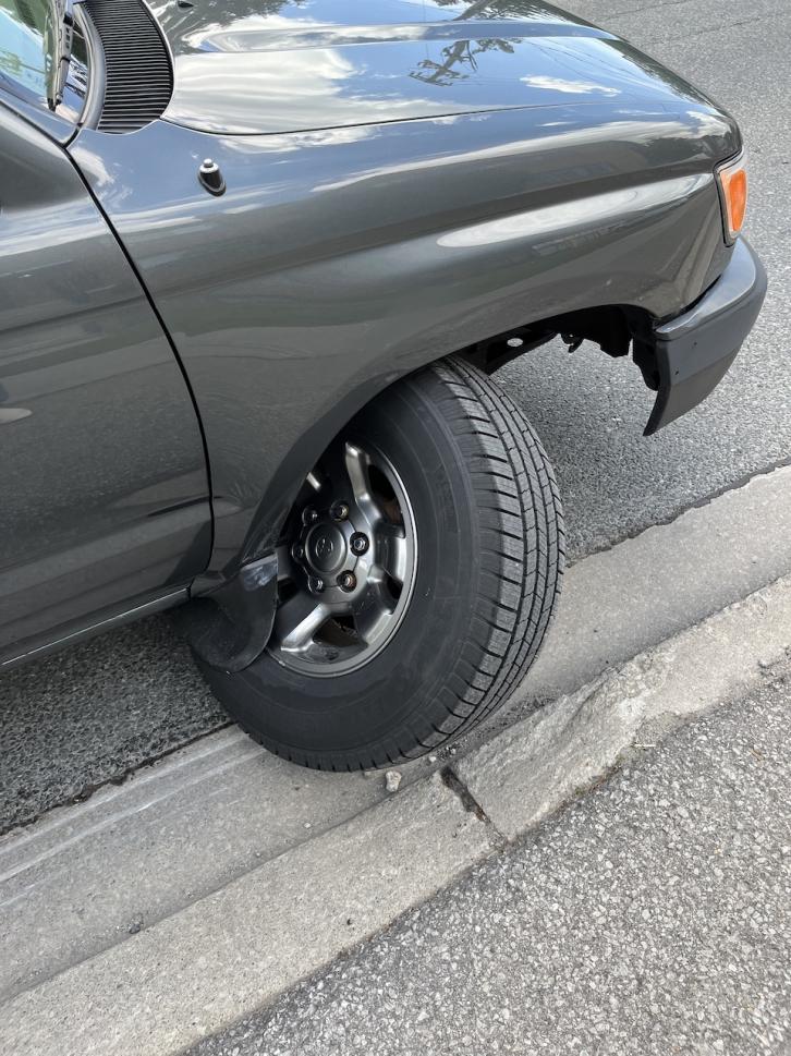

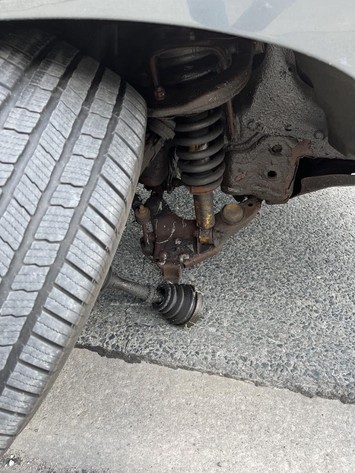

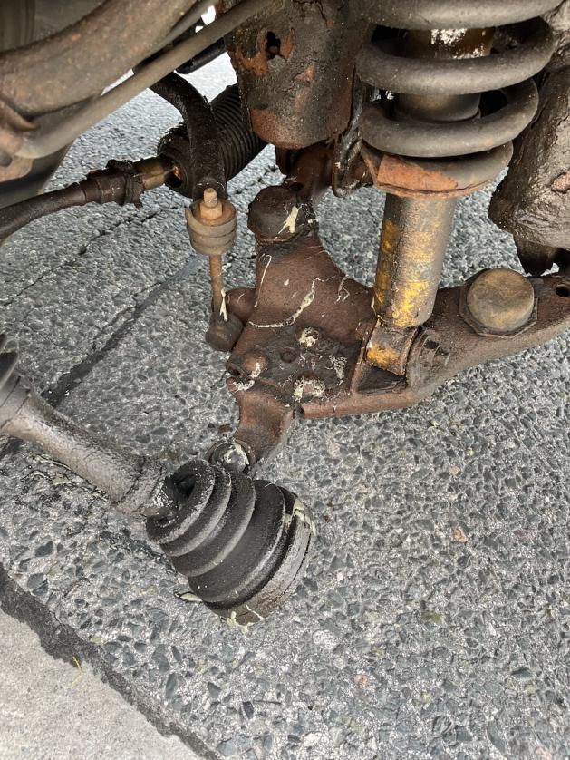

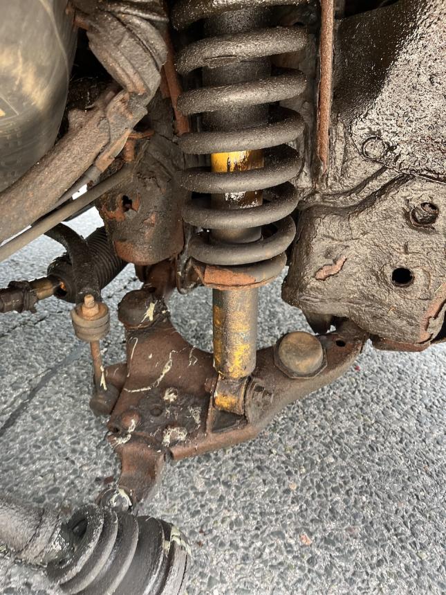

take two. Here are some photos. Thanks my images were too large :)

There's not a great clear shot, but it does look like the ball pulled out of the socket, so not an issue with either under or over torquing the 4 smaller bolts, or the one large nut.
There's really no way a good OEM balljoint should fail in 50000k (around 30K miles) unless it was damaged in some way. Either thumped hard which accelerated wear, or the boot was torn (either during installation or shortly after) and it got rusty/contaminated inside.
Maybe it was a defective part? I have a 3" lift and 33" tires on mine, and wheel it fairly hard with some regularity, and I still stick to a roughly 75- 100K mile replacement routine, but I also keep an eye on the grease seals and bolts every couple of months. And if the boot is torn or leaking grease for any reason, I'll just go ahead and replace it.

You can clearly see the joint separated. Looks like it was likely a faulty joint. However, OP I have to ask, Did you check to make sure these were greased before you installed them?
I think there was a case here a while ago where the OP peeled back a ~5k mile OEM ball joint boot and discovered scratches on the joint. Ruled as defective so the parts were replaced. Wonder if this could be the cause as to why yours failed. Seems like OEM ball joints aren't made like the factory ones 20+ years ago.
