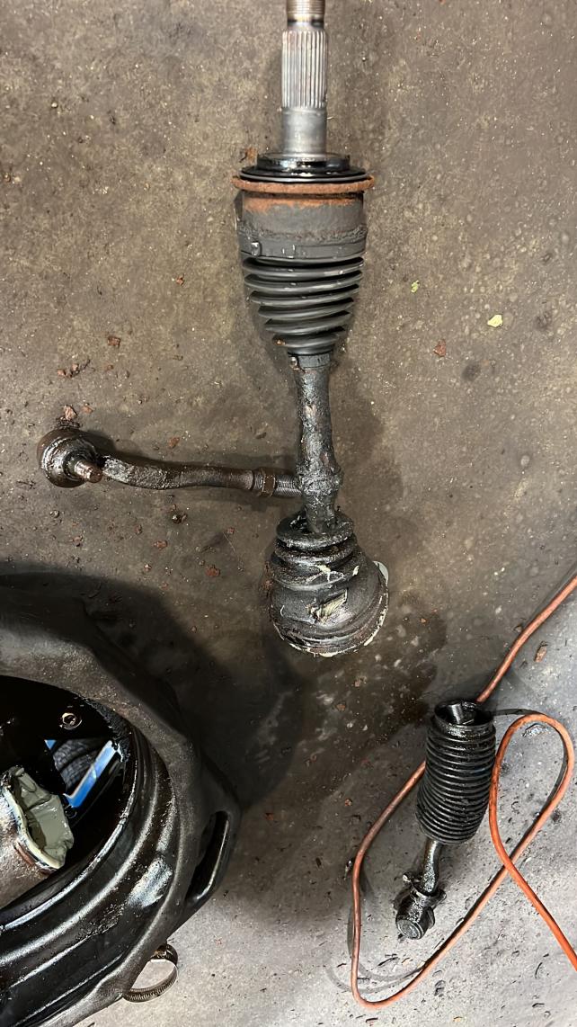

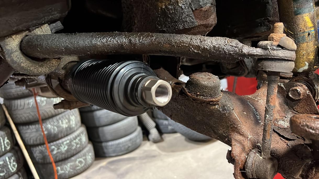

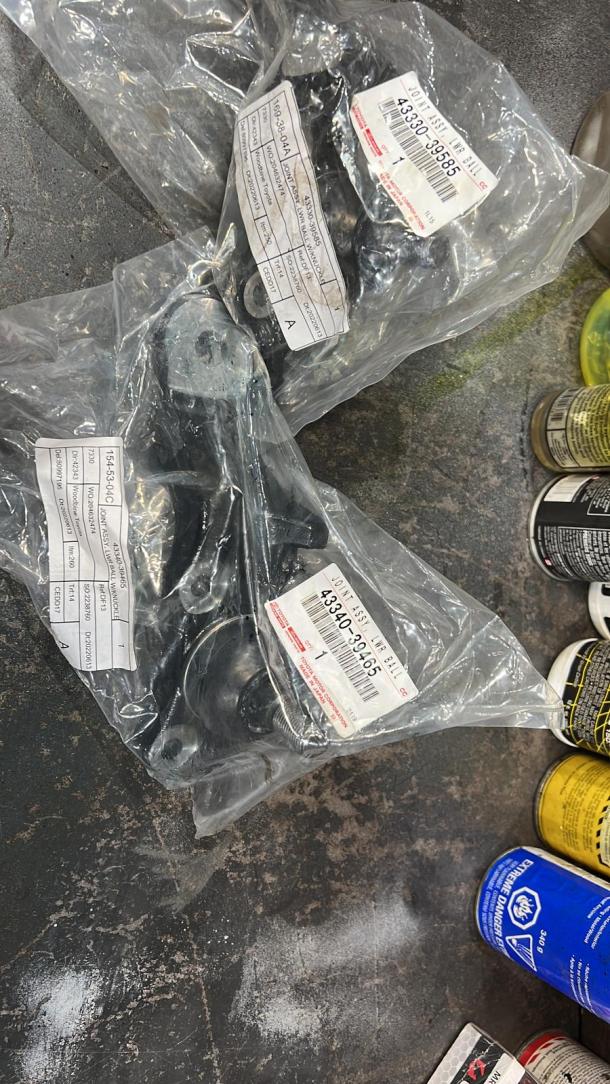

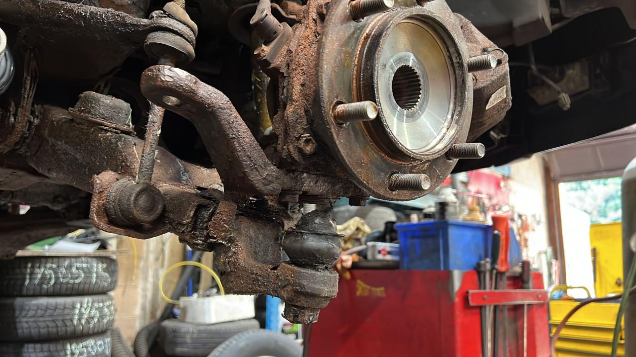

some more photos.
Waiting for the UBJ and bolt kit.
got the CV shaft, tie rod ends and rack and pinion boots and LBJ's OEM.
I guess if this happened on the highway could have been a lot worse. The right Ball joint looks like it wasn't replaced when I did the left one 7 years ago. I will get the parts after the swap and take some photos.

some more photos.
