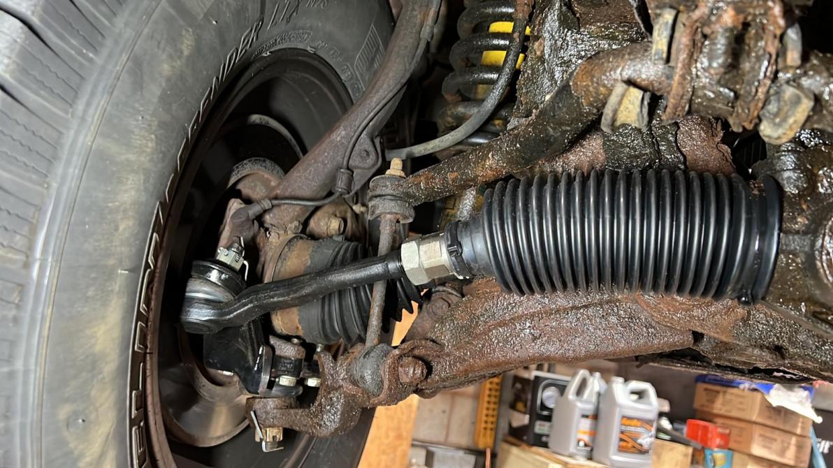

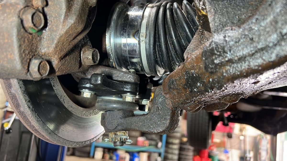

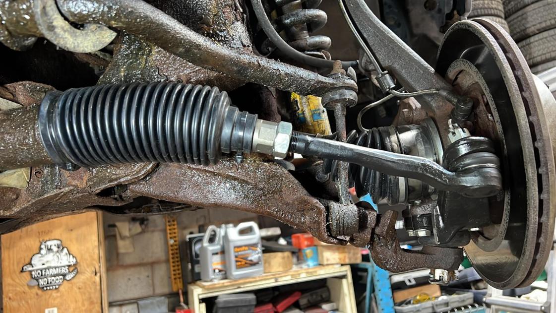

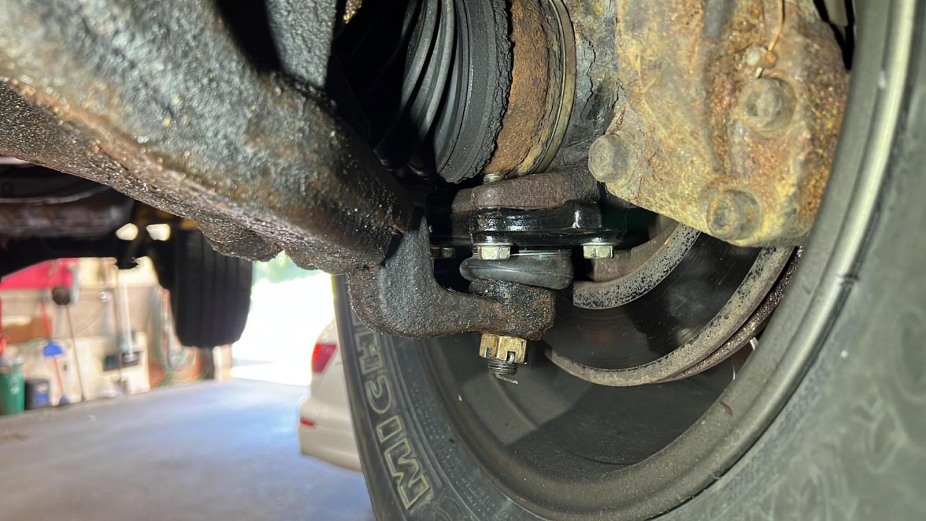

Here’s some shots of the work the mechanic did. Toyota LBJ’s and new bolts. As well as other parts.
