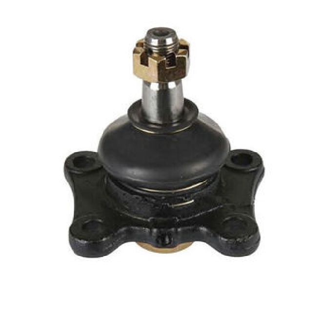

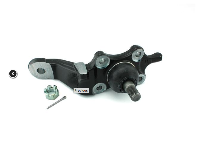

I am curious if anyone has pressed in new lower ball joints? I am getting the OEM LBJ from Longo Toyota and in JWaldz post about oem part numbers he lists Driver (Left) Side LBJ: 43340-39465 and Passenger (Right) Side LBJ: 43330-39585 as the part numbers (checked with the Stealership and they are $119 each. These part numbers show a LBJ with a metal arm and the ball joint already pressed in. I figure the metal part on my rig is fine (its a NV and CA car....0% rust)

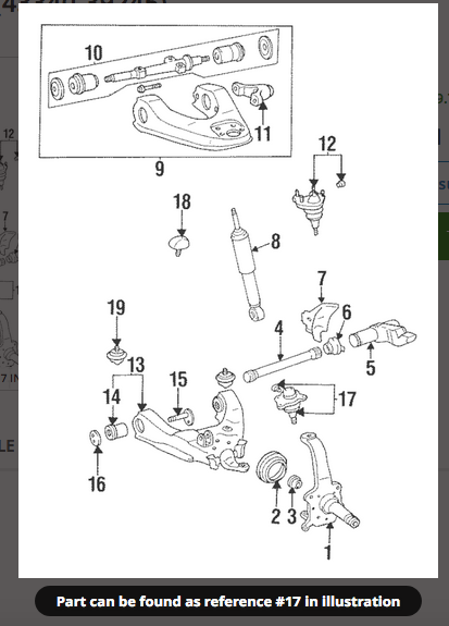

I also found Lower Ball Joint 43340-39245 on the Toyota parts factory site that seems to be just the LBJ for $70. Id love to save $50 per LBJ if all I have to do is press in the LBJ and re use the metal arm.
Does anyone know what the difference is between these part numbers? The Stealership sites (I have been to 4 or 5) all show an exploded view of the suspension but no photo of an actual part.
Can I just press in a new LBJ?

The cheaper ball joint is for the 2nd gen ('89-'95) and doesn't work in our application.
The diagram you posted is a second gen front suspension...

Your part numbers in the first paragraph and lbj pic are correct for 3rd gens.
The part number 43340-39245 is for 2nd gen left lbj. The illustration chart is also for 2nd gen.
That "metal" plate is part of the lbj on the 3rd gen and is considered as one unit.
