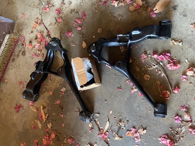

I got this done, and spent about 8 hours total on it. I didn’t use the moog greasable alignment pins and cams because the oem ones came out fine and I like them better. I cleaned them up and reassembled with antiseize.
The ball joints came out ok with a 20 ton press, but it seemed to take all 20 tons of it. They both popped loose with a bang and then slide out easily from there. I had no trouble getting the replacements installed. Side note, I still think the factory ball joints were fine. They seemed smooth with no play in and out (140k). Boots were cracked, but there was still plenty of grease in them.
Now — those energy bushings — holy crap. They are not bushings. They are a kit you use to assemble your own bushings after you disassemble the factory bushings, extract the core, cut off all the rubber and wire brush everything clean, then press in the poly bushings, reassemble the the inner washer (you need to work this apart carefully so you can reassemble). It’s just a tedious, messy, time consuming chore. I would not use them again. I’d prefer some assembled Siberian poly bushings, or any rubber bushings over that experience.
If you are going to do bushings buy or rent the bushing tool kit. It makes it all much easier (watching videos of the disassembly I saw some other approaches and they looked a lot more difficult than my experience).
