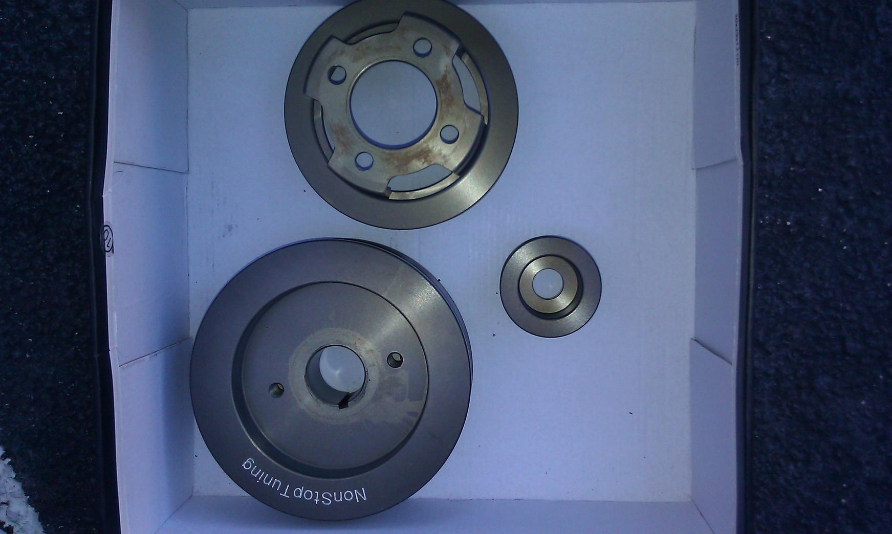

is that a lightened crank pulley? Those make me a bit nervous. Something with the possible vibration and spun bearings from my old days of playing with hondas.
Anyone else running these?

Yes it is. Along with w/p and alt. Dude just about every xrunner has em.. Alot of the guys on the other forum im more active on have them and have nothing but good things to say...Keep in ming its the same engine fj, Tundra v6, Tacoma, and of course 4r.

So if anyone happens to get the Nst pulley for the water pump.. just know that u will have to file down just a bit not alot the top tab of the water pump... You will see what i mean when u take off the factory one... Also just for Info for you all i have 84k miles on my truck and my water pump is showing signs of replacement....
