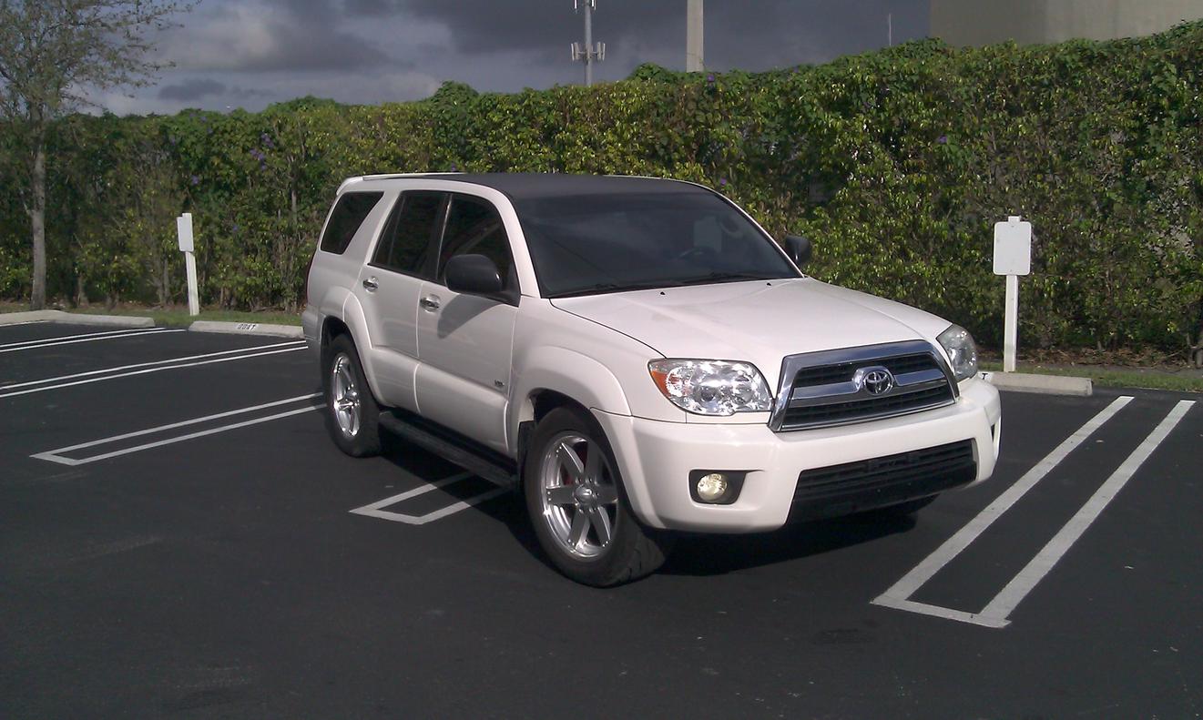

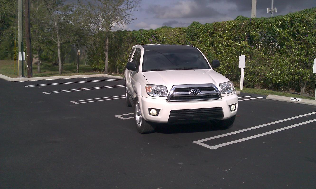

And here it is!!!
Thanks broskie!...lets see em???

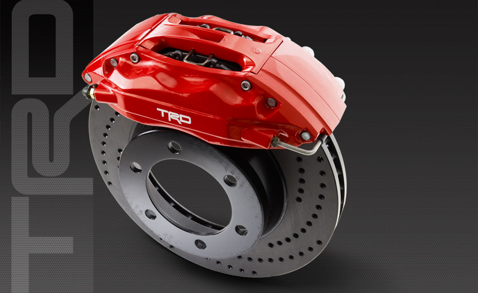

make sure its 6 lugs, not 5 lugs on the tacoma x runner, that trd brakes look like the one from stoptech, i still want some good ass brakes, i wonder how good are the ebc rotors, i have there 6000s green pads and they are fine.
Yep its made by stoptech using a st40 caliber. The kit however is for an FJ. TRD really cheaped out on this, instead of a 2 piece rotor its a 1 piece rotor. The rotors diameter is 12.7in (OEM fj and SR5 rotors are 12.6in) so not much improvement there. You do cut off the dust shield (done already for me) to aid in cooling.
I do have to say, it does look nice. I'm more of a lift it guy but yours works too. I do like the black roof on the white.
Roof looks good in black! Did you paint or cover in vinyl?
How did you remove the rack?
Sorry about that didnt see the second part of your question......there actually is a thread on here on how to..but it is really tough to get those covers off..once u do its just the bolts after that n off it goes...
