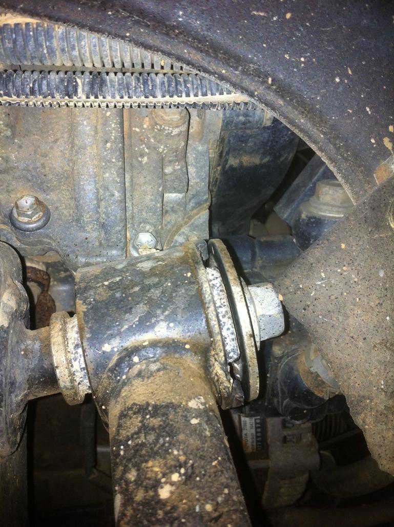

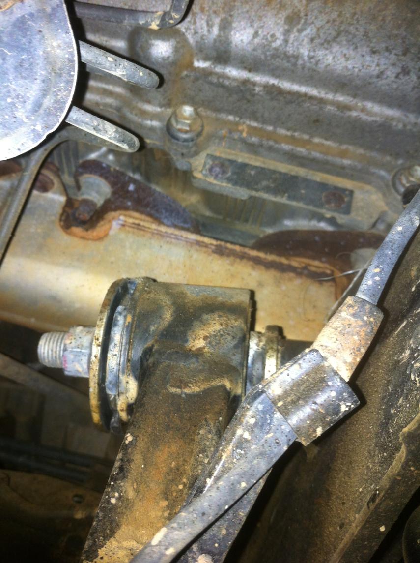

If there anything like the 4th gen UCA's then the washers that go to the outter side of each bushing (the washer the bolt head seats to and the washer the retaining nut seats to) these washers have a concavedness about them. when installed there supposed to concave into the bushing leaving the outer edge of the washer about an 8th of an inch away from bushing preventing any squeaking or rubbing between washers and bushings. I just recently had an issue with my LR UCA's with the ball joints squeaking I called SPC and told them about my issue and sent pictures of my installation and they said a while back they had a bad batch of ball joints where the boots wern't sealing around the steer tappered rod, as well as, the boots wouldnt seat to the top of the spindal as the tappered rod was to long to allow proper sealing of the ball joint. They took a 100 dollar core charge to have them ship me the new ball joints first so i could do the swap and ship the old ones back for the return of the core charge. If you send yours to them first they will ship theres out without a charge. So if its your ball joinst squeaking perhaps contact SPC and check into a warrenty, if its your bushings make sure the washers are installed properly. It's rare for these UCA's to have noise issues there designed to be quiet.

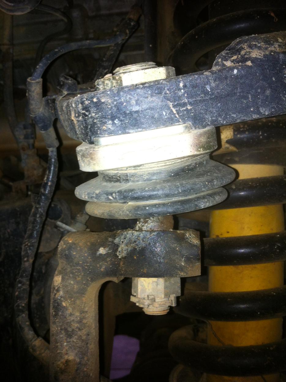

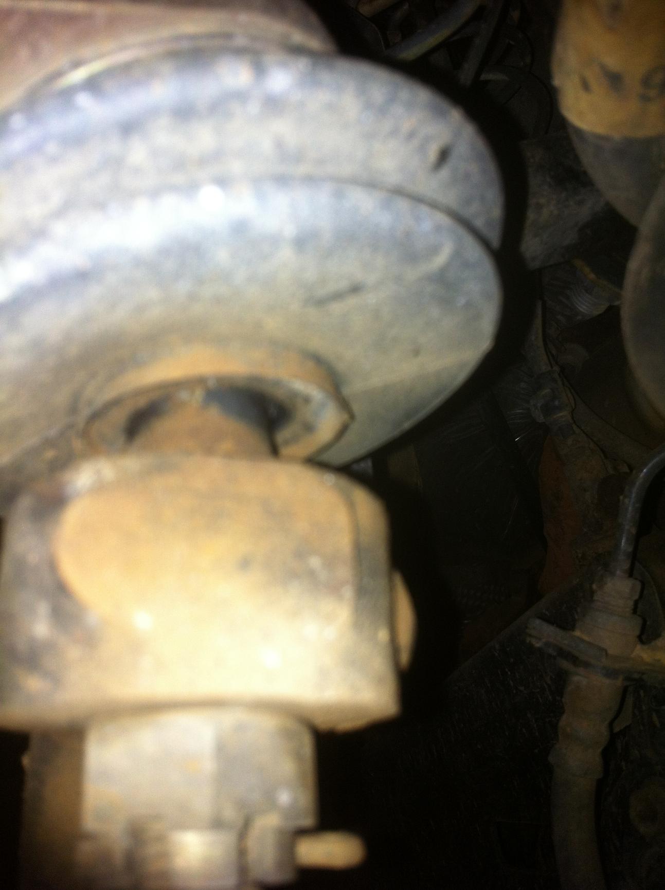

showing the old ball joint notice the gap = not good
i can push my finger up into the gap between the boot an the rod
propper installation of the washers and bushings

Just for reference, these are mine purchased at the same time as you (we were within 24 hours of one another, right?). Ignore the way the ball joint is installed; it's since been corrected and was squeaking *after* the correction:
