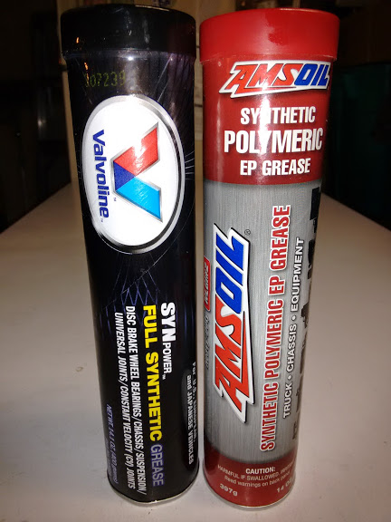

Anyhow I chose my two greases, Moly and Non-Moly, and then went to find them.
Luckily the Valvoline Synthetic Moly was easy; Amazon.ca carried it and it showed up in two days (along with a new cell phone case and a RJ-11/45 crimp connector, love those random orders!).
The AMSOIL Synthetic Non-Moly was a little harder. None of the local automotive or similar retailers carried AMSOIL greases and there was no reasonable way to order online from Canada.
I now tried the commercial/industrial distribution channel. Three phone calls, to three different guys (each referring me to the next), finally paid off. It was actually hilarious and felt exactly like I was trying to buy heroin or something. Every guy was sort of friendly but just gave me a name (no company) and phone number for the next guy. My final "dealer" had no physical presence and drove by with a tube, at a pre-arranged time, for cash only... This stuff must be good. :shocked:

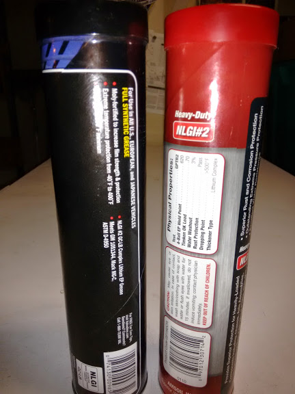

Here are my babies just before sticking them in the guns.

I guess to add a bit more value to this thread here are the two PDF spec sheets. Both greases also have a wide operational range: -40°F to +325°F (AMSOIL) & -40°F to +400°F (Valvoline-Moly) which I thought was a good choice, particularly on the low end up here.

PS. In case you don't follow the Moly wars the creed I am choosing to follow is Moly for the shaft, non-Moly for the spider/U-joints.

So the drive shaft slip yoke calls for non moly?
I've been using the red Mobil synthetic grease on my previous tacoma that I sold. With 230,000 problem free miles I'll continue using it I guess. Doesn't seem like a crucial thing if I went 220k miles using that grease.
No the slip is ideally Moly and U/Spider joints are non-Moly.
That's another popular non-Moly choice for the U/Spider joints. Seems to de-emulsify (probably a better word for that) easier than the AMSOIL though.

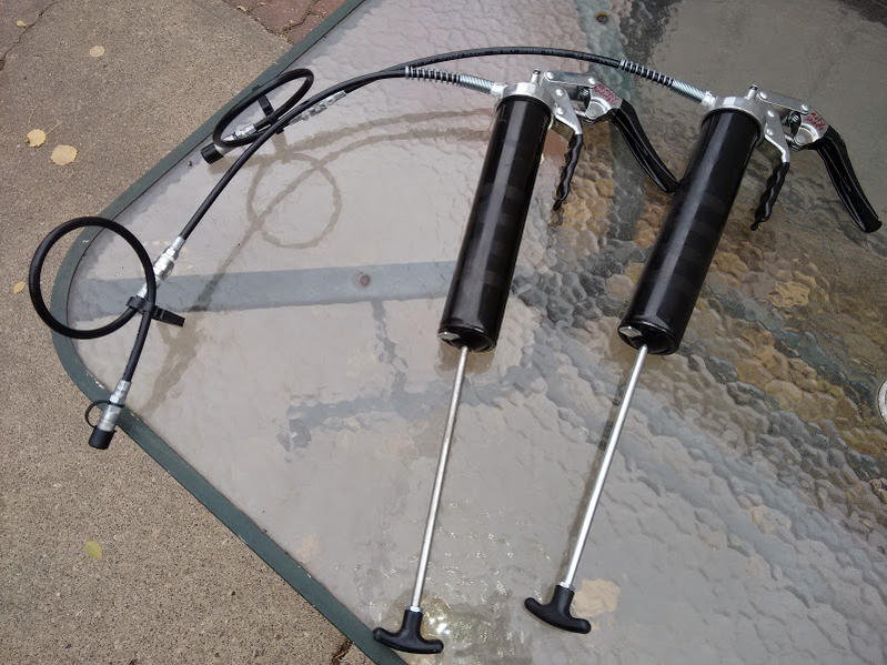

So just got out from under the truck and am really glad I grabbed a several 16" hose extensions that were on clearance at Home Depot (only $2.50 a piece). One of these and a $1.50 1/8" NPT coupler from Princess Auto made things a lot more pleasant in cramped quarters to pump.
Pro-Tip 1: If you are going to lubricate under there without a lift/pit then it's really nice to have a long enough hose to have the gun further away, to the side, etc.
Pro-Tip 2: Write on the handle with a marker which grease in in which gun (particularly if they are identical guns).
