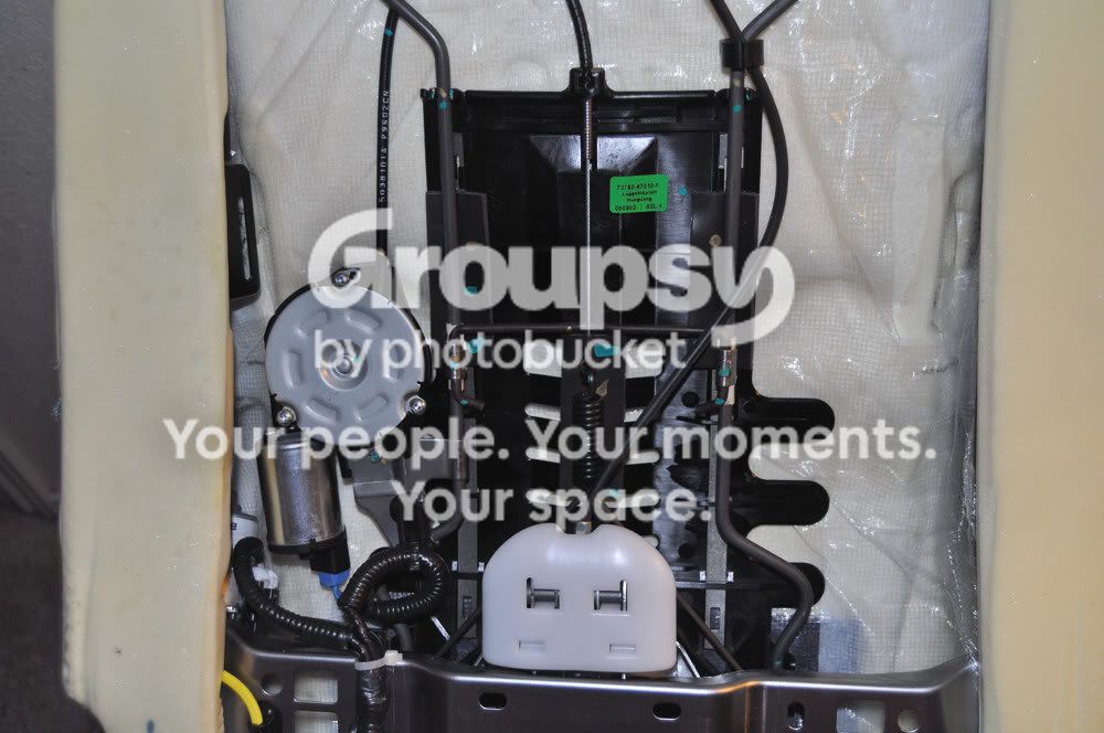

This lumbar support looks like it was over engineered by the japanese engineer from Germany.Germans are famous for over engineering! It has a little electric motor that pulls a cable that slides the plastic up two rails. WTF???
I fixed mine when I had the cover off by putting a 2"x2" piece of foam about a foot long behind it creating my own lumbar support.The lumbar is right for me now and quiet so I leave it alone.I added some strips of foam on the bolsters too to fit me a little better.
It's real easy to get at this bolster thing-a-ma-jiggy if you don't like to mess with dealers like me. That bottom flap on the lower back of your seat has a elastic band that wraps around the springs underneath. Take it loose and the flap comes up revealing the ends of the zippers for the seat cover.Unzip both sides a foot or two and wala,there it is.
