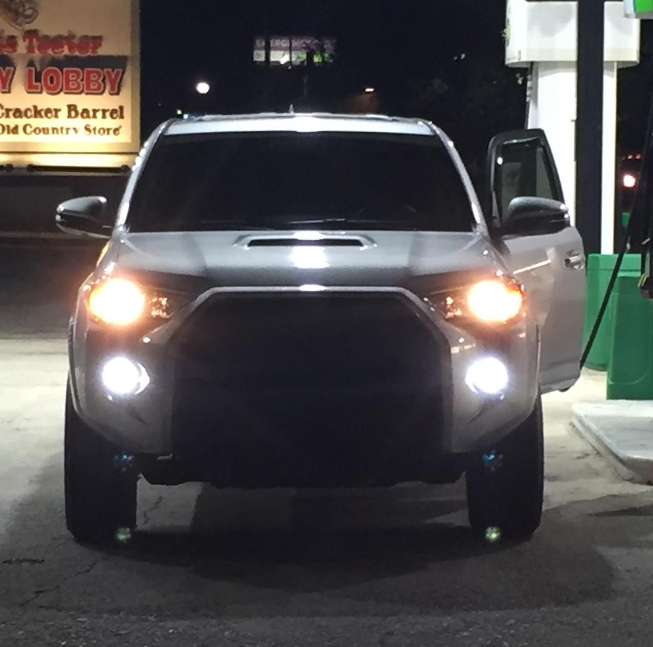

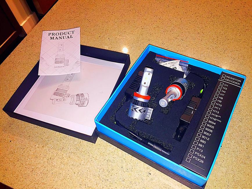

I have the upgraded LED fog lights (which I get tons of compliments on) cause they look amazing both during the day and at night, but hated the difference between the Headlight and fog light. So, I've ordered and finally received this G8 Lumen LED Headlight conversion kit from CarID.com stay tuned for my review and install pictures!

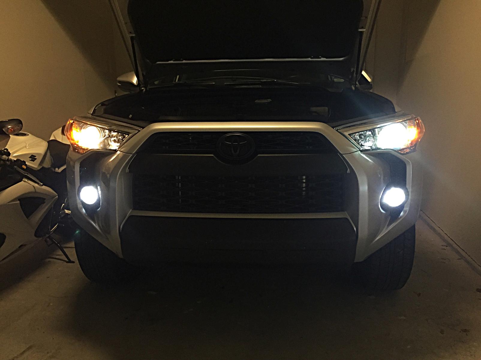

Glad you brought it up, bud. I just got back in from the garage and everything turned out great. It all fits in the housing, I will however be drilling out about a quarter size hole and adding some type of mesh so that there is plenty of circulation for the fan with little to no moisture. Love the look, they match my fog LED's perfectly. I saw some people went with the HID's but I just didn't want to go that route right now.

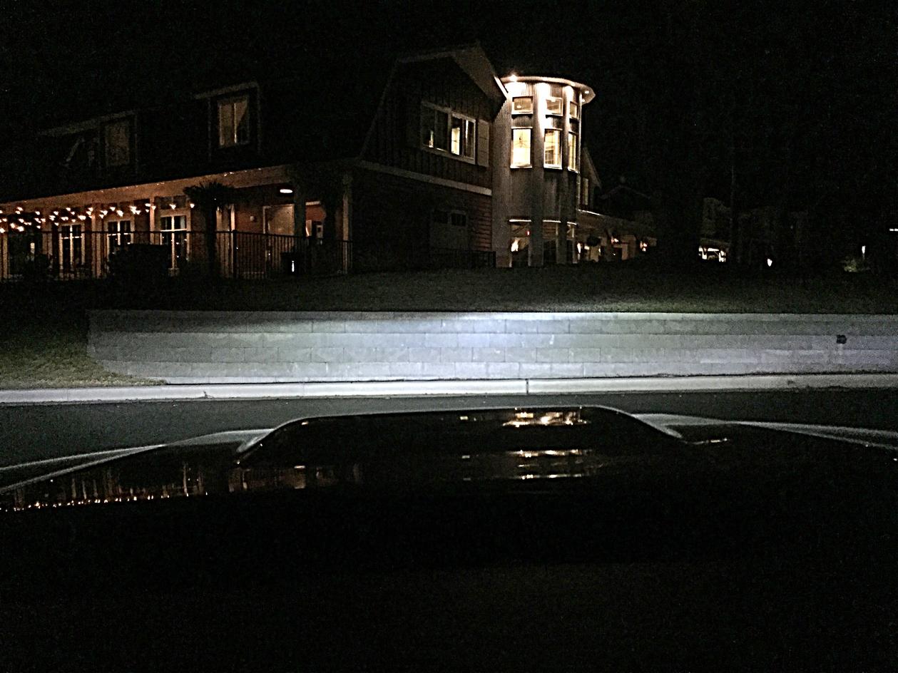

X2! If you can, try to snap a picture of the lights projecting on a building wall or a garage. How would you judge the output in comparison to the stock halogen bulbs? How is the beam pattern (an dark spots etc.)?
I'll post some tonight, the pattern is wider than the stock and the output is better but obviously white instead of soft yellow. Pics to come as soon as it gets dark out here.

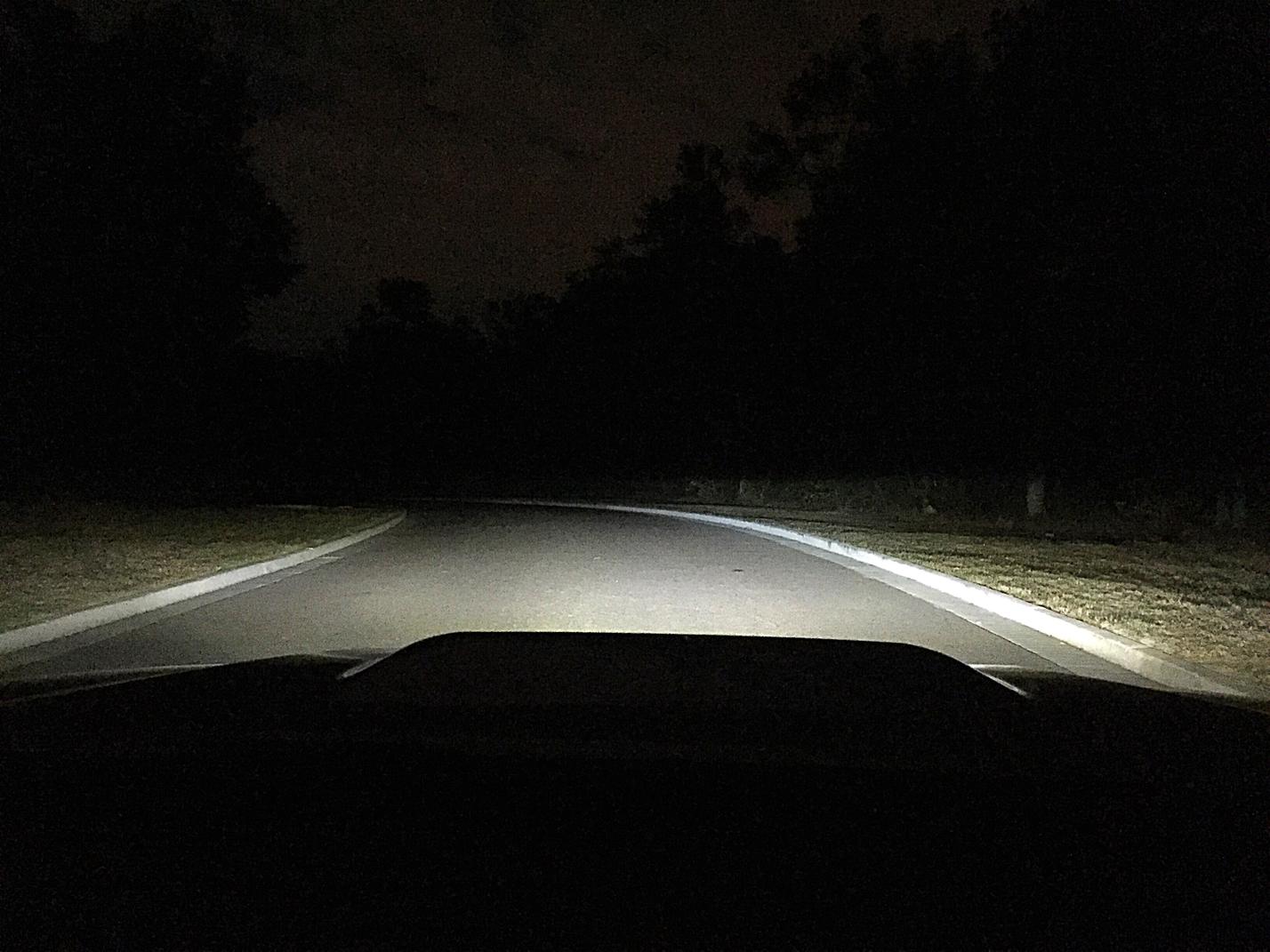

Here's the second down a dimly lit road.
