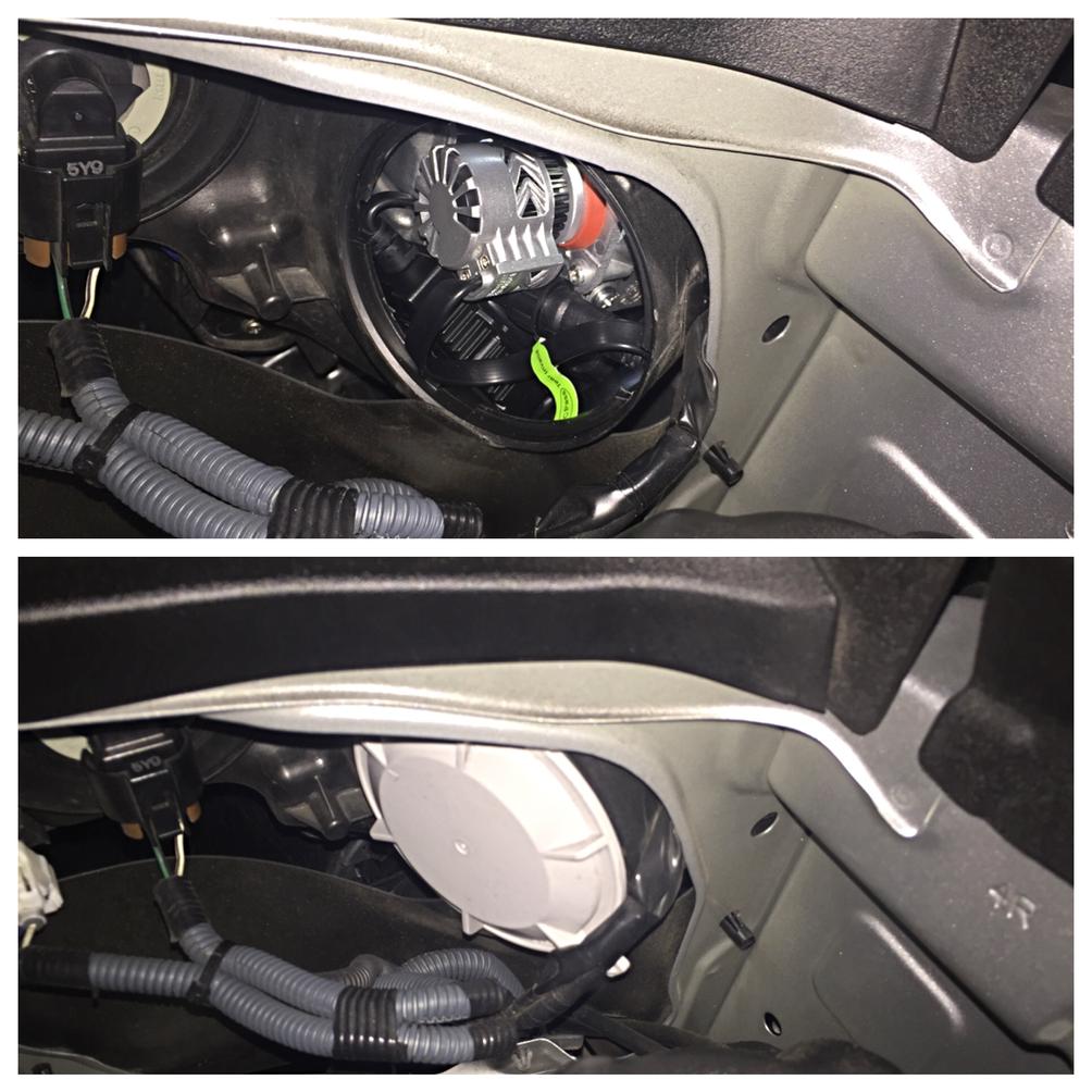

Here they are, with cap off and then cap on. I understand that having the cap on could generate an issue, just as having it off can. I will be calling the manufacturer to find out more on why they are selling these for a 2016 4Runner specifically when clearly these vehicles have light housings.
Thanks for the pictures, I'm really surprised they fit with the back cover on!
That said like Saker said I'd be concerned about heat build up as heat is the #1 enemy of LED's. This is why light bars have huge heat sinks across the entire back of them.
This type of (not technically HID / LED) that uses a external driver (like a HID ballast) makes tons of heat... just one look at how bright these are off two diode can tell you that.
-A
It may have been one of the LED Light manufacture's that had it on their website. I can't remember...if I run across it I will reference.
But it is logical that they would overheat in an enclosure!

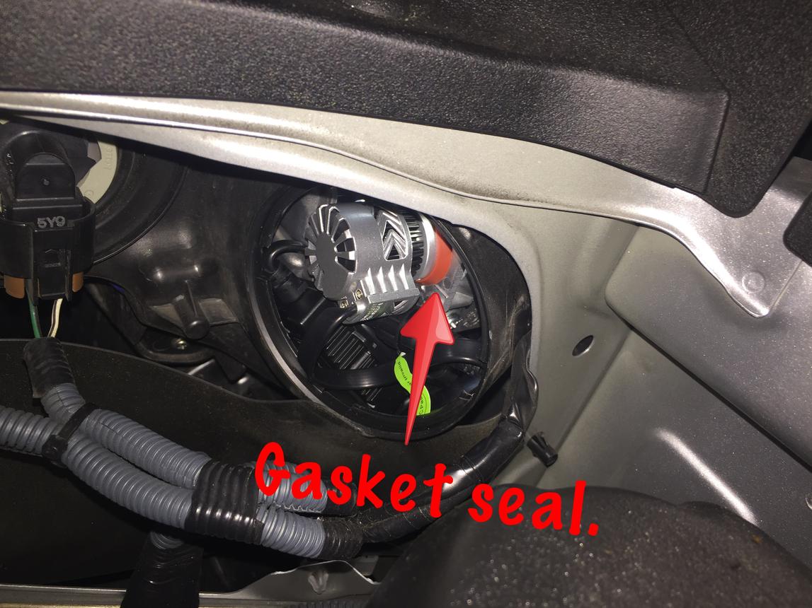

I just got off the phone with the manufacturer, after explaining to them about the housing our trucks have for the projectors. He said, and I quote:
"These lights are designed to be a plug and play feature for your trucks, they are also designed with a rubber gasket (orange) that will prevent any type of condensation or water from entereting the projector lens. Do not place the cover back onto the housing after installing the LED's as the fan will not be able to cool the lights."
So, as I thought originally. I will more than likely just be drilling a quarter sized hole behind where the fan rests so that I have both circulation and some protection from water entry.

So, what I stated holds true... as your quote states:
"Do not place the cover back onto the housing after installing the LED's as the fan will not be able to cool the lights."
So, I would just check when running them for 5 minutes just how hot they get with the enclosure (with quarter sized hole) on vs without enclosure.
If you had a infrared heat instrument that would be ideal to check temps!
