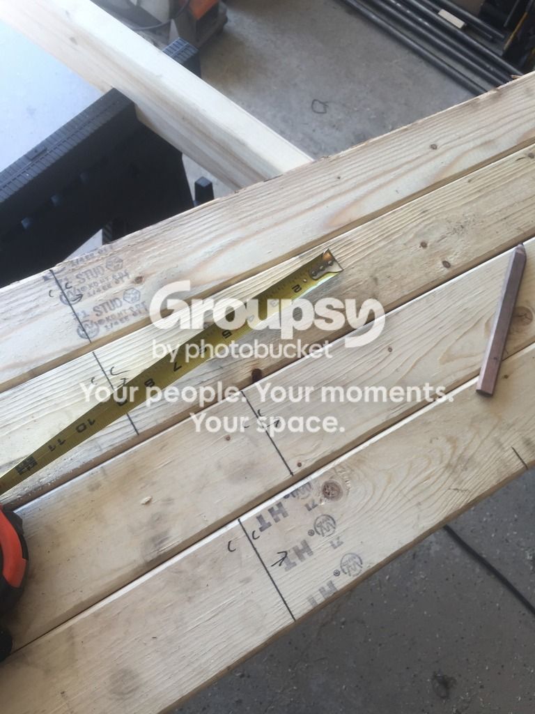

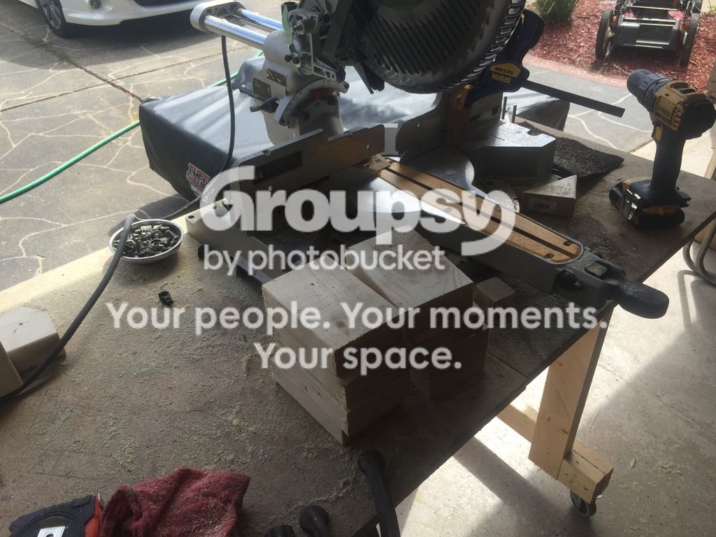

Next: Gluing the saw horses down, starting the jig framing: I measured centers on all the boards, 3x checked my measurements, and screwed everything together with decking screws.
Next: Check level every chance you get!!!!
