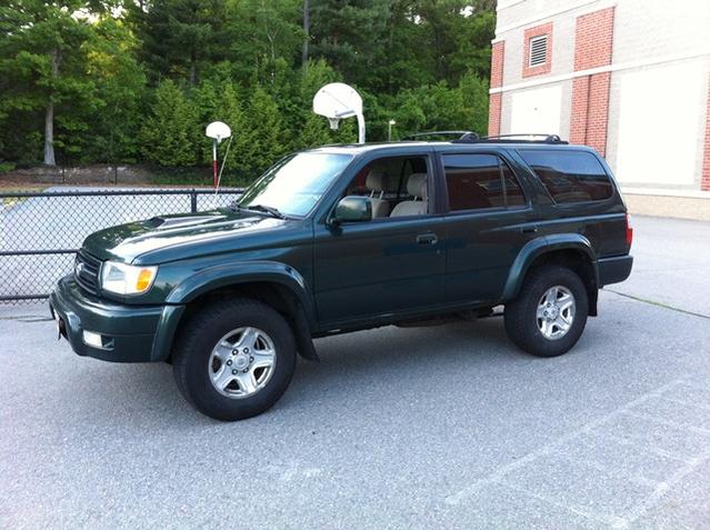

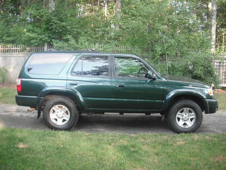

Here's a pic from 2011 shortly after it was bought.

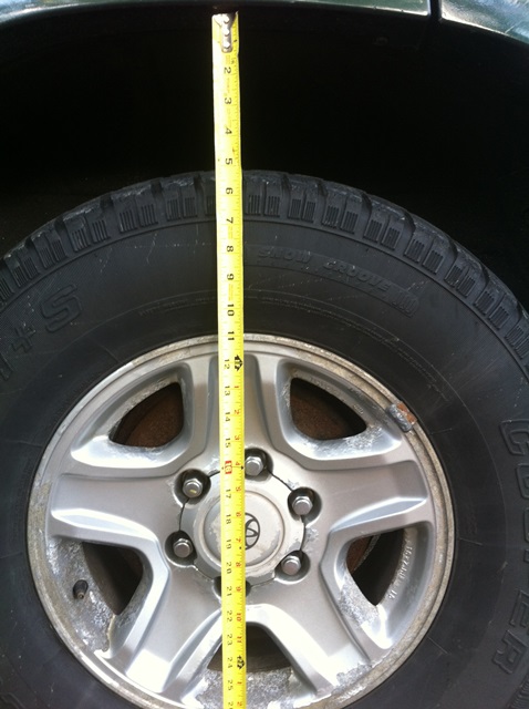

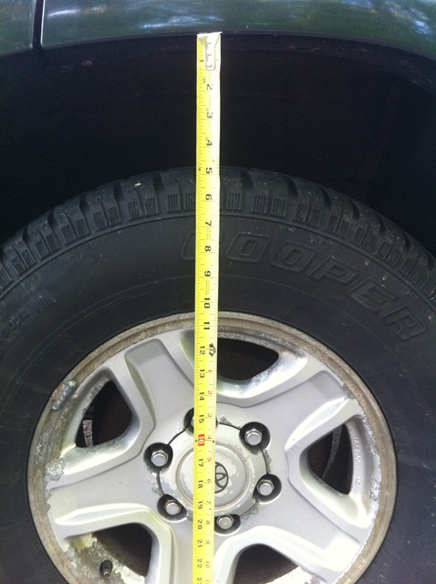

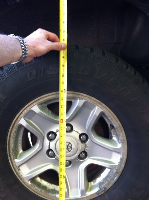

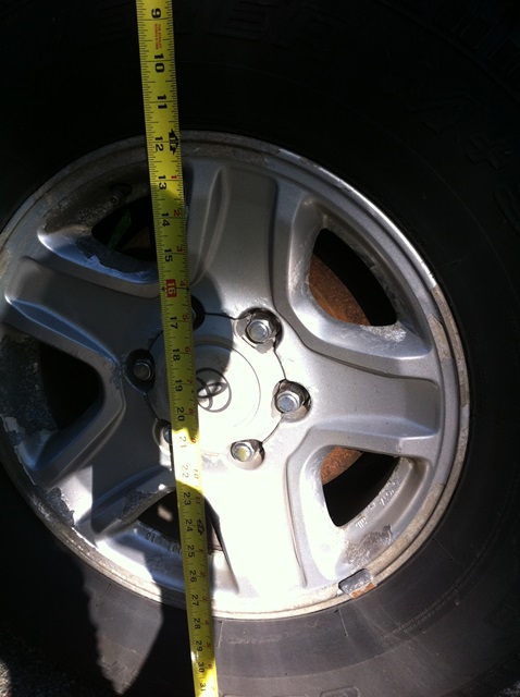

Here I've measured from the fender to center of wheel (I think this is the preferred method to alleviate tire size, pressure, hole in ground, etc.)
Installed are 99 tall coils (thanks to JEFF16758 here)
OME 10mm spacers, Bilstein 4600's (thanks to Kevin at Toytec)
Energy Suspension poly sway bar bushings
Moog rear swaybar links
Salvage yard lower control arm w/ low miles (removed torque steer!- holy cow was it noticeable when the bushing failed)
1st 2 pics are pre , 2nd 2 are post ride height

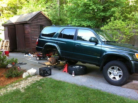

Rear Suspension (PIC HEAVY)

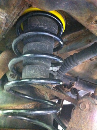

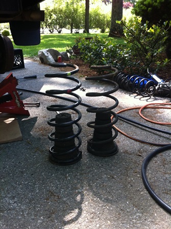

edit: Found pics from installing the springs! But I did not need a spring compressor. I just jacked the opposite side to get the flex. The old were in there pretty good and used my 4 way tire iron with the screw driver edge to persuade them out/in. Worked like a charm.
A few weeks ago in preperation of this and the front I hit the yota dealership for some hardware.

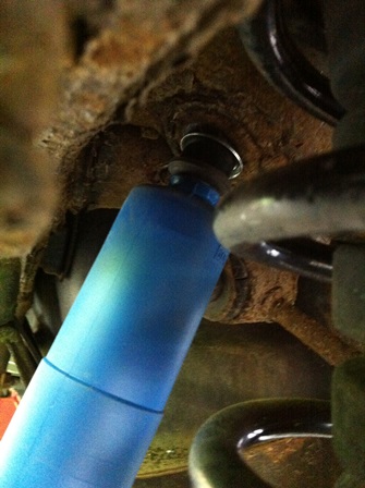

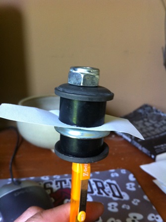

Not much info on installing the Bilstein 4600 on 3rd gen 4runner (assembly of bushings and hardware). Through a member on t4r.org I got it done and salvaged my weekend.
Removed the swaybar and links (broke the bottom 2 bolts on the axle's bracket. The tops came out fine!)- set asside
Notes:
The paper is in place of the body's shock mount.

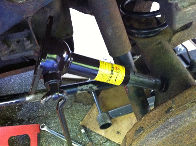

I had to take a sawzall to the old ones per the instructions of the knowledge base here.
I did the passenger side coil 1st, then the DS (removed RLCA, bottom bolt of shock)
Got sawzall and did shocks the following day. Passenger side 1st
Used anti-seize on all bolts fastened to frame
I did need to use the OEM bottle jack from wheel well to axle housing to line up the shock's lower boss to the shock base along with jacking the axle up/down. IMG_1353.JPG
The passenger side did not need as much lining up. The LCA was a...you know.
I think this was my 1st time doing major auto repair where I did not throw anything or swear at a part or busted a knuckle!!!!!

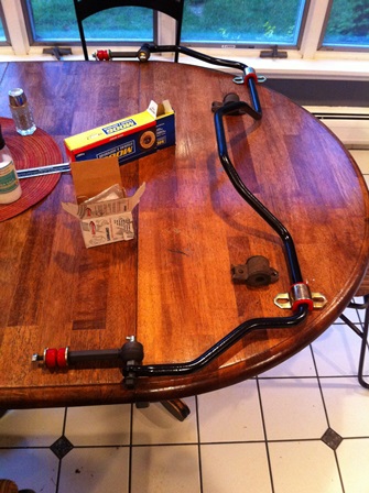

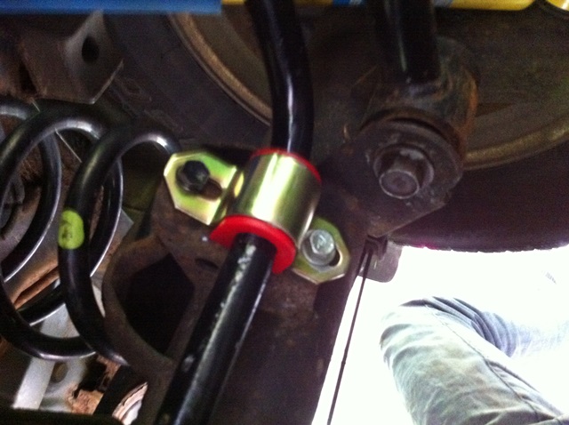

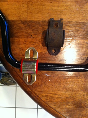

The Sway Bar

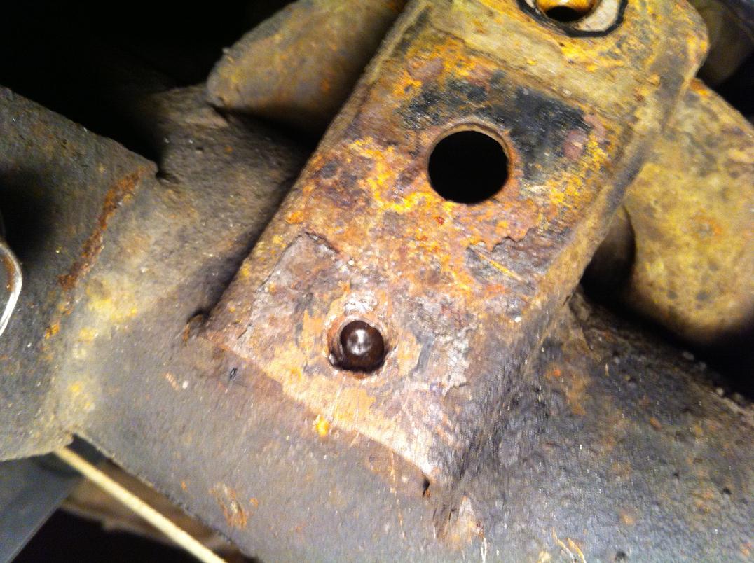

Since I broke those 2 lower bolts...
Spent a few minutes a day working them with heat and PB blaster. Then drilled and used a reverse drill bit. No go. More heat and PB Blast. Then a tap extractor. No go! Drilled a thru hole. See the shiny spot in the last thread? Yup. Hit the axle housing. Not too bad. (JB weld in future). Air chiseled the nut off (2 seconds each side).
So since I couldn't get the broken bolts out quickly, I sanded and primed my Swaybar
I kept spraying it with Professional Rustoleum over those few days!
The old bracket and the new...
What I did for the lower 2 bolts. Grabbed 1" long 1/2" hex heads, flat washers, and locking nuts.
Doesn't look right but I think it's ok. Thoughts anybody?
FYI: drove around for a week without the rear sway bar and didn't notice a HUGE difference w/ or w/o. But then again I did do the springs and shocks which was night and day. For the record, the back setup ROCKS!!! Maybe 906s? Hmmmm....

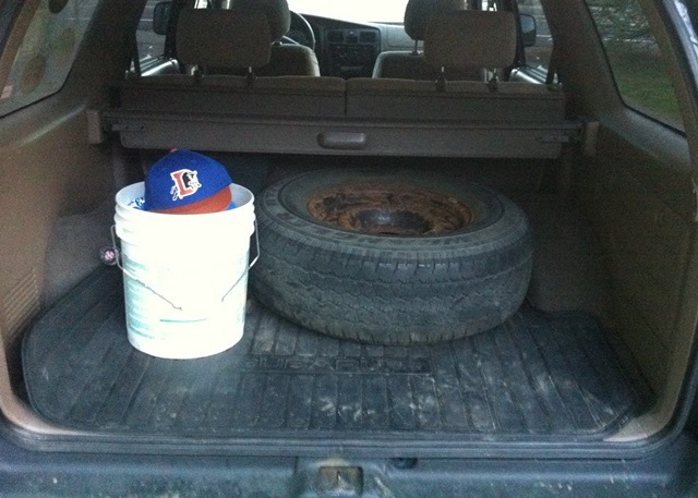

Fate: Salvage yard and LCA rears
So my plans where to get 2 rear trailing arms (lower control arms). I paid $75 each (they took them off). 1 was sweet! OEM like new: i.e. no rust and bushing still smelled like rubber and flawless. I installed it.
The other...not so much. I figured I could press out the bushing on mine that failed and the 2nd one from the junk yard, restore them, and re-install. But I read that from 96 to mid 97 the bushings could NOT be changed (true- IDK?) but didn't want to risk it and these were off a 97. So I went back to the junkyard. 1st guy was not happy but said I could get something in "the yard today". 3 runners all DESTROYED. Oh well. But then!!! A T100 with 5 spoke with a Michelin 50% tread! Talked to a 2nd guy who was totally cool and said take it and we'll call it even! IMG_1404.JPG

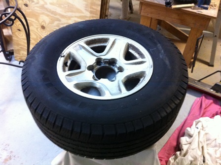

So good bye steelie, rusty, spare with a nail that still holds air!
Pay no attention to that Subaru mat. It came with the car and honestly, I like it. The way the left side flaps up- it stops Nalgene bottles from rolling around :)

Post rear suspension
Post rear install-
99 tall coils (color code: yellow/red or y/r for those searching)
OME 10mm trim spacer
Bilstein 4600s part# BE5-2451 or 24-024518 (same thing)

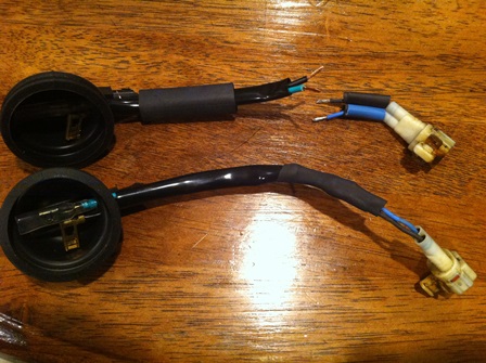

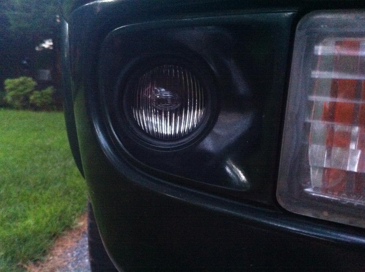

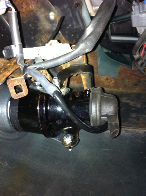

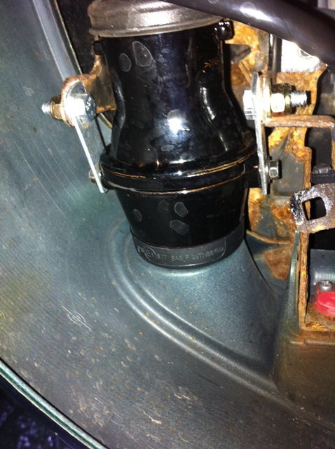

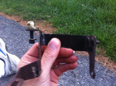

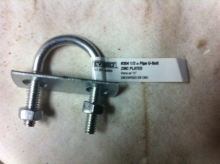

Install Hella Micro HDs using the old OEM bracket (modified it).
4: 1/2" pipe brackets $4
6: 1/4-20 nylock auto grade nuts $1.80
2: 1/4-20 1" long socket head cap screws $0.80
4: 1/4-20 3/4" hex head bolts $1.20
8: 1/4 auto grade washers $1.75
6: 3/8 auto grade washers $1.50
All you need are the slotted brackets. These will allow you to pivot on the bracket and the light.
I used the bolts and the washers from the light's hardware to attach them to the u-bolt bracket.

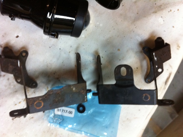

here is the OEM bracket stock and the one I had to mod. You need to cut the back tab off and remove some of the material because the lights are long and otherwise they won't have enough travel to adjust properly. You can see the black mark I made- after a trial fit it wasn't enough. Cut a nice arc out from inside edge to inside edge would give you plenty. I ultimately had JUST enough afterwards. You can kinda see it in the photo below if my thumb wasn't in the way.
I then drilled out the hole with a 1/4" drill in the bracket that stays on the truck and the light's alignment bracket (photo below) so the 1/4 socket head cap screw would fit. The welded nut on the topside couldnt be taken off so I stacked 2 3/8" washers around it and then a 1/4" washer- then nut.
Cut the old connector from the OEM light housing and the new light housing. Stripped, soldered, and shrink tubed. Green to Blue/ Black to Black
Aligning sucks cuz there's so little room but not too bad. Shot of the bracket from the underside.
The pass side.
Drivers side
Here they are from the front.
Note about the Hella Micro HDs: attaching the lugs to the light housing needs to be better thought out by the manufacturer. Not hard but a little dicey when plugging the back rubber boot on.

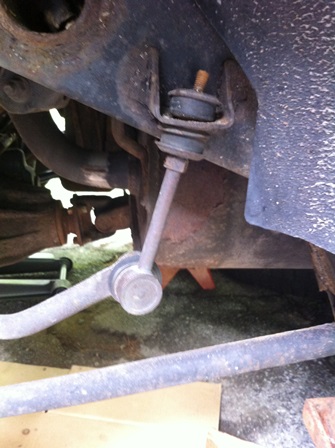

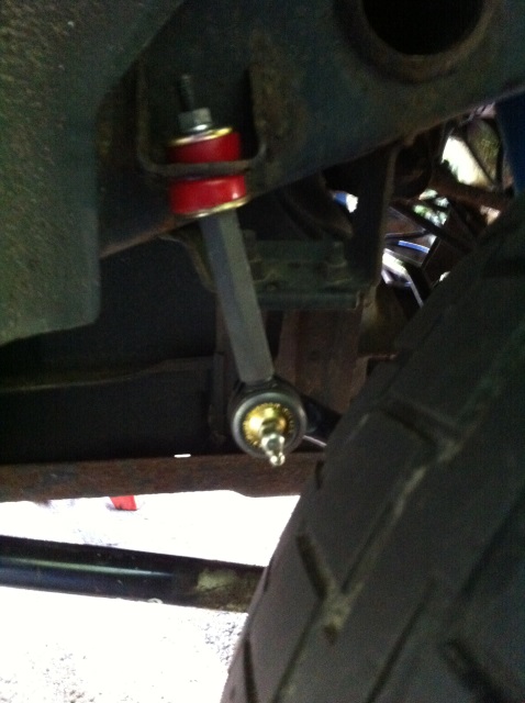

I'm thinking those links need to be a little longer. The links should be as close to perpendicular with the ground as possible.
Just saw a post that says when lifting a 3rd gen, use 3rd gen fronts on the rear and 2nd gen fronts on front. Maybe if/when I go up to a 2" I'll make that switch.
Now Im all messed up because I found a pic of the link before the swap. Maybe when aligning the rearend on the trailing arm before installing the swaybar threw it (swaybar link) out of true. But the rig tracks well and took an avoidance maneuver at 70mph on the freeway today (I pee'd a little and my wife FREAKED! LOL)
Still needs to be addressed tho (here's the old swaybar link)

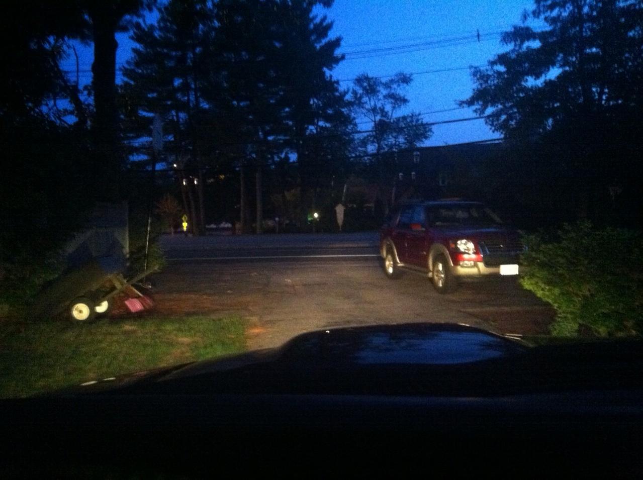

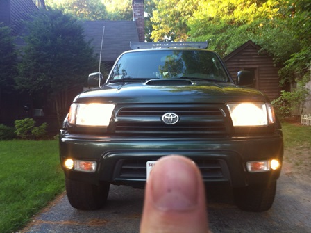

Hella Micro DE retro fit
Here are the results: off/on
Sorry for the delay
